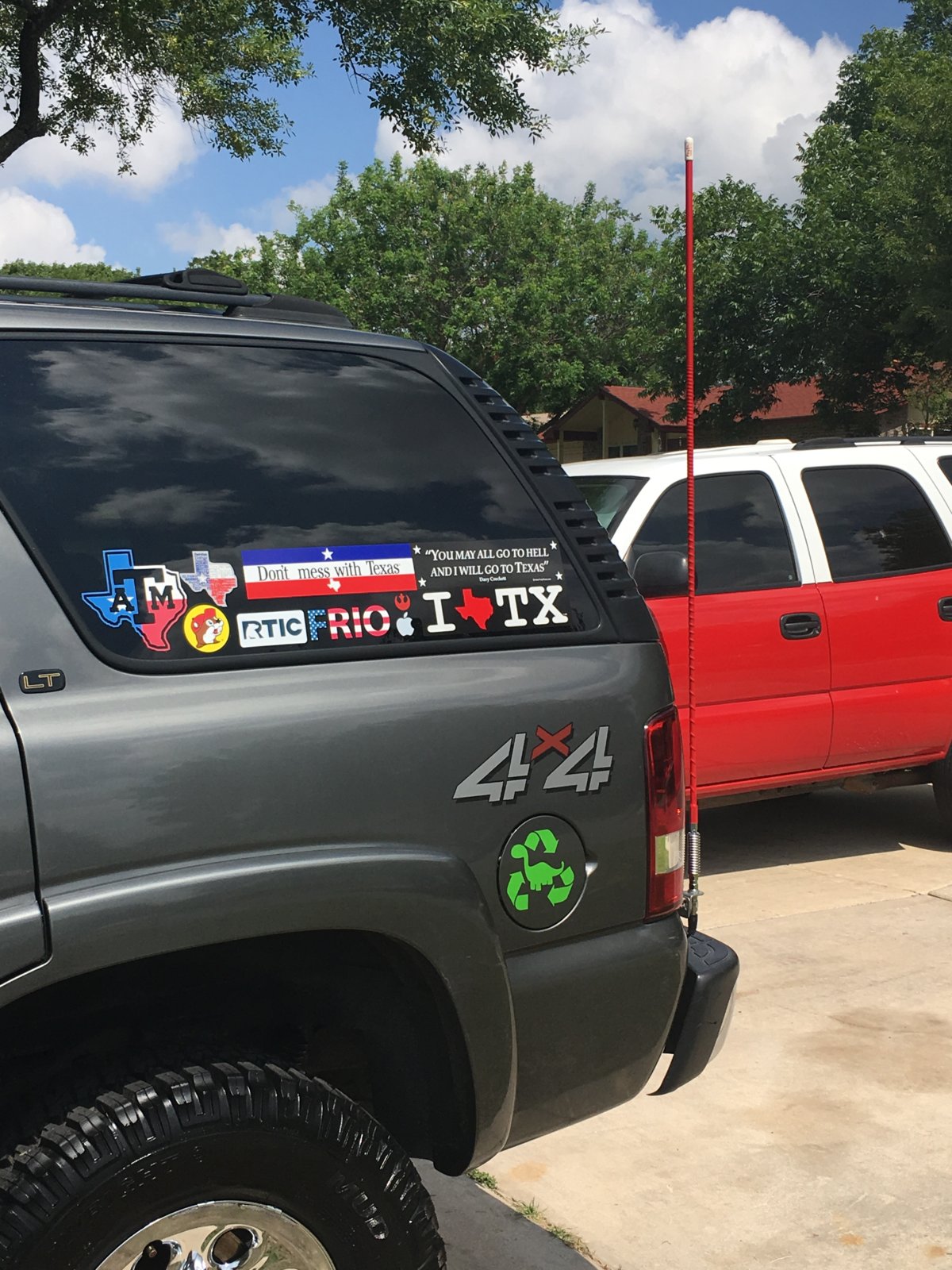

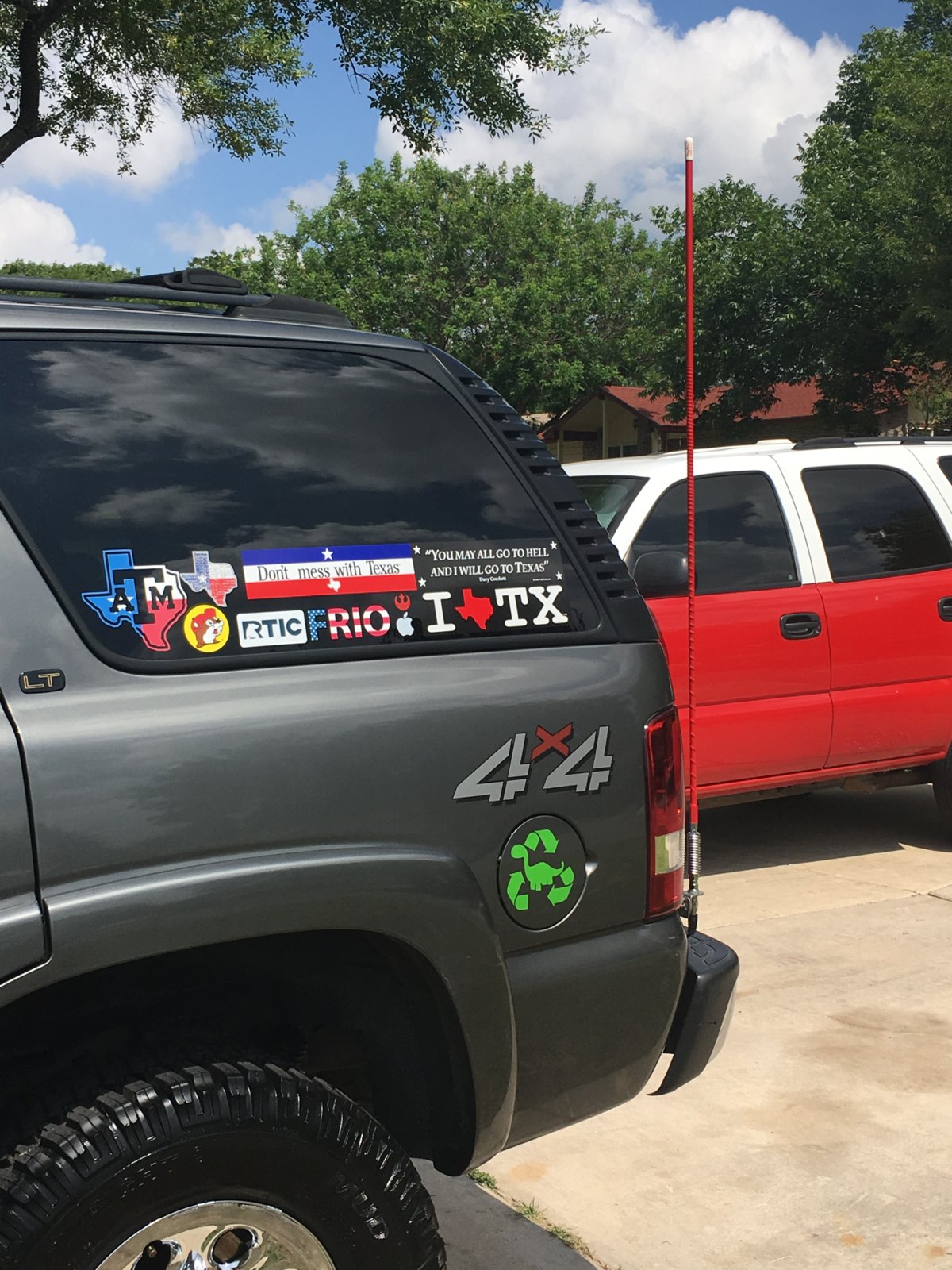

Doorjam mount right below the driver's taillight. Works great.

Just remember that your vehicle body is reflecting signal being that close to the antenna. Best performance will ALWAYS come from an unobstructed antenna.

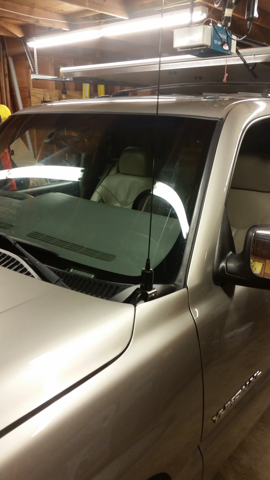

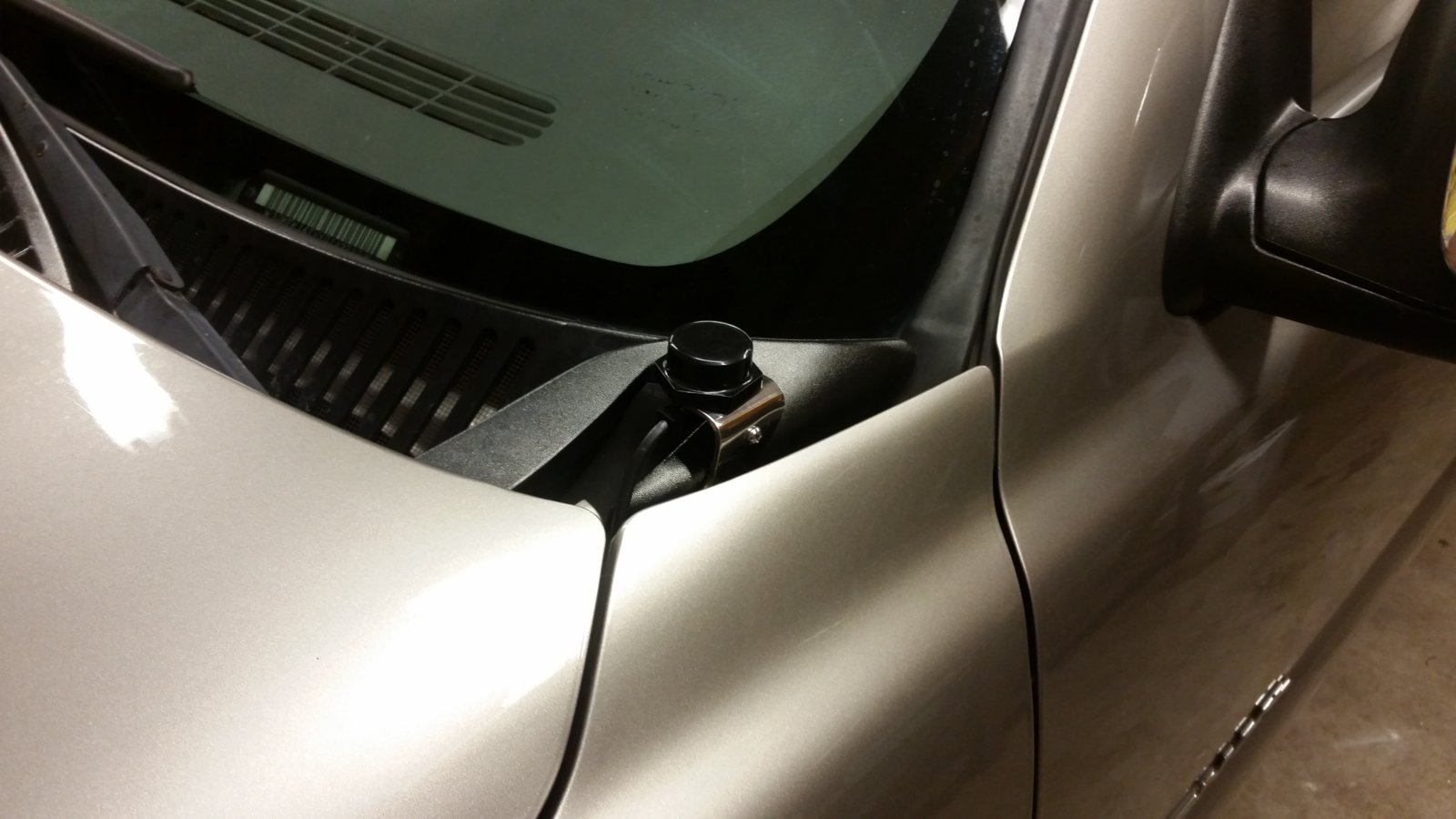

I ended up getting the Midland 1001LWX that should be here in the next couple days.
I was planning on mounting the antenna on the drivers side hood corner opposite the radio antenna.

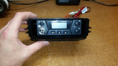

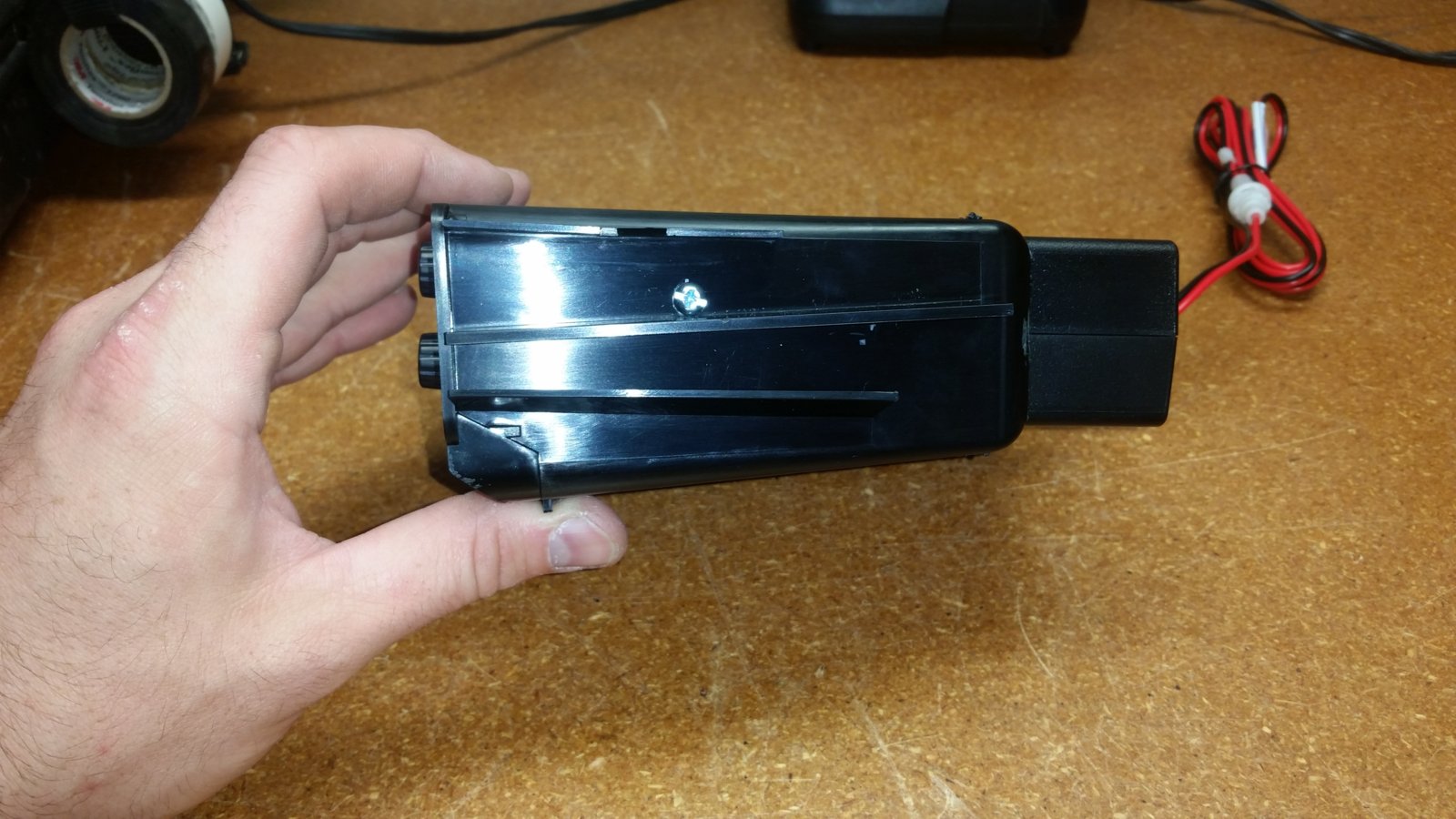

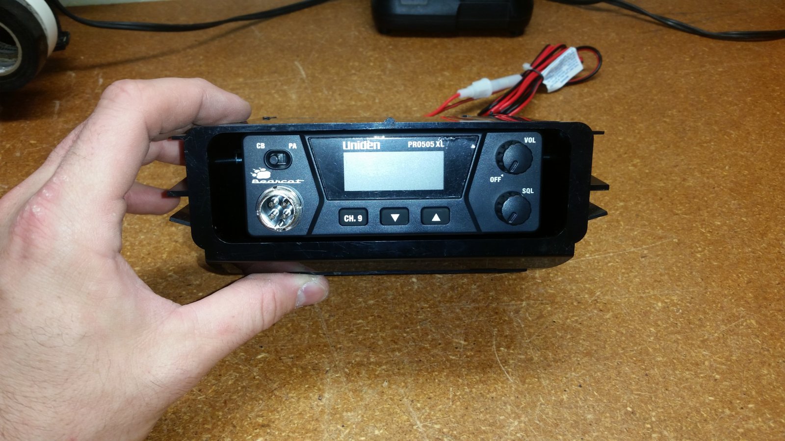

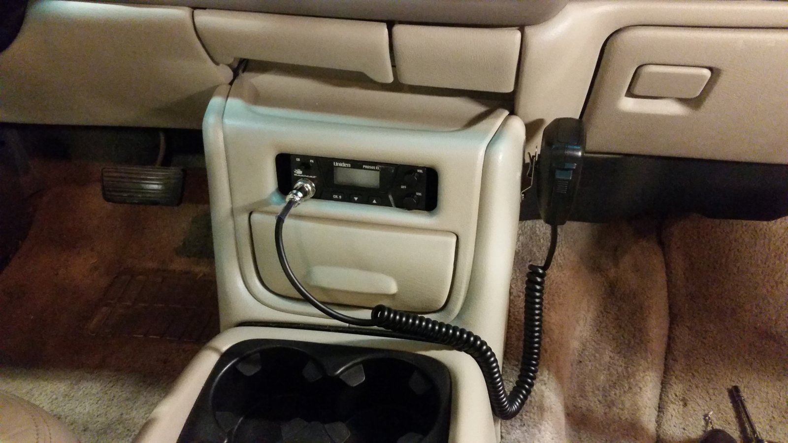

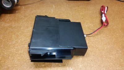

Perfect size. I pulled my console and put in a jump seat so I just threw it in that empty area.

What kind of range did they expect you to get with this antenna?
I'll be honest, I'm not really sure.
Although, when the guy was helping me pick an antenna, he said if it wasn't tuned, I'd be lucky if I got 1/4 mile.

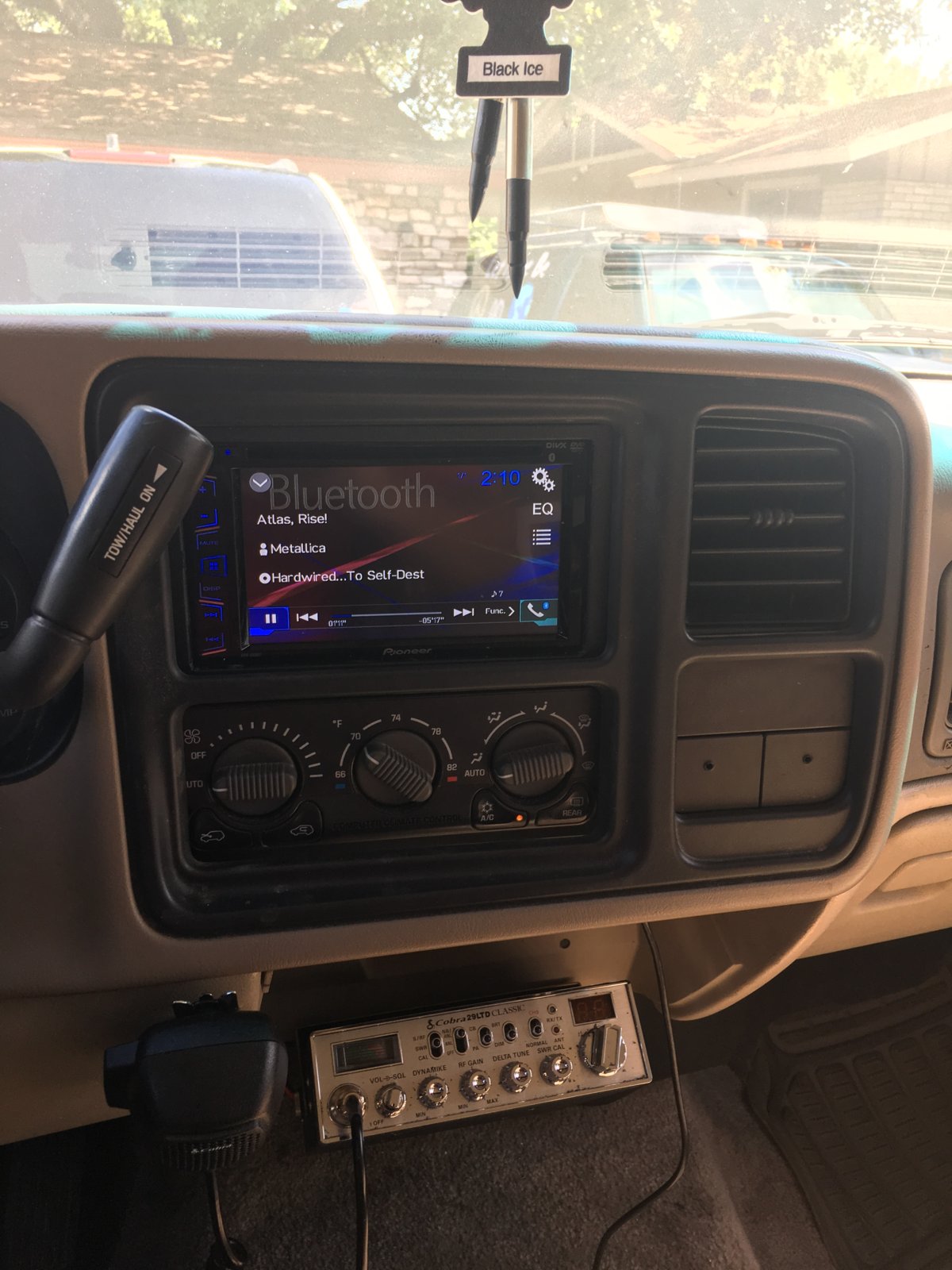

If you have the full center console, I think a lot of guys put theirs in between the cigarette lighters or right below there. And I've heard good things about Firestik antennas, lots of bang for your buck.
Just to double up on the above statement, my console has space between the front and the dash. I mounted my bracket to the front of console with two (2) screws. The Cobra 25 mounts vertical with the antenna connection on the bottom and sets on the carpet. I used the lighter connection right in front of it. As for antenna, I used a Firestik 3' with magnetic base just behind the front crossbar on the roof rack, and the antenna coax is routed through the front of the l/rear door @ the top. Center of roof is best location, that's why mine is there. The antenna comes with adjustable tip for fine tuning. Good luck
