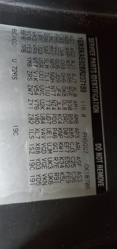

Well, that's a first for me. Never seen one with Nivomats. So you have RPOs ZW7 and G65?
How do you test the ball joints without a dial indicator? The failure is half to one millimeter of movement. Well, they're probably not bad or contributing to the harsh ride but I bet those other parts might be.

The rear suspension just seems stiff. It doesn't glide over bumps how I thought it would. The front feels fine. I have never had a vehicle this big and I'm used to sport suspension and comfort suspension that I used to have with BMW and Porsche. I may just be expecting too much from it. I might put 200 pounds of sand in back and see if it smooths out. If it does what can that tell me. Spring too stiff? As far as I know it's the factory spring. I got the Tahoe from an old couple and I'm the second owner. I doubt they changed springs or anything but I could be wrong. Thanks again swathdiver.

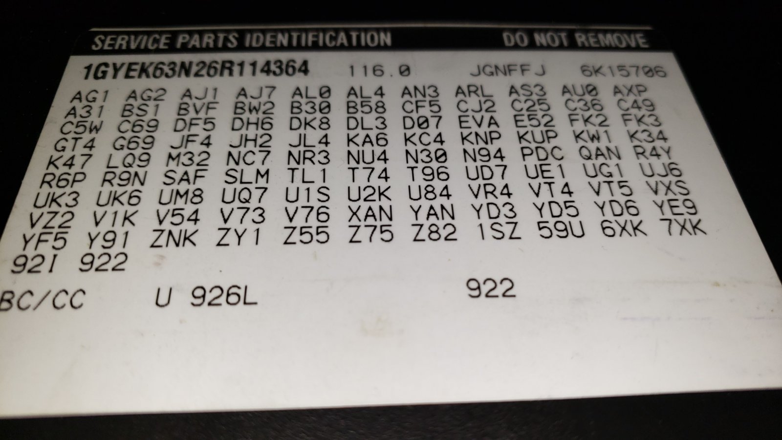

I am kinda confused by my build sheet thou. I do have Z55, G69, but I have one that is confusing. AL4 is listed twice..
AL4 - Second Row Bucket Seats w/Heat
AL4 - Suspension, Firm Ride Handling, Front and Rear

Build sheet aside, what are your "Axx" RPO codes in the glovebox?
A31 - POWER WINDOWS W/DR EXPRESS DOWN
AG1 - ADJUSTER FRT ST POWER, MULTI- DIRECTIONAL, DRIVER
AG2 - ADJUSTER PASS ST POWER, MULTI- DIRECTIONAL
AJ1 - DEEP TINTED GLASS
AJ7 - SIDE IMPACT AIR BAGS
AL0 - PASSENGER DETECTOR
AL4 - SECOND ROW BUCKET SEATS W/HEAT
AL4 - SUSPENSION, FIRM RIDE HANDLING,FRONT AND REAR
AN3 - POWER HEATED BUCKET SEATS WITH DRIVER MEMORY
ARL - PLANT CODE ARLINGTON, TX USA
AS3 - 3RD ROW 50/50 SPLIT BENCH SEAT
AU0 - REMOTE KEYLESS ENTRY
AXP - VIN IDENT POSITION, MULTI- PURPOSE VEHICLE
Not at my truck currently, at work. Will look to confirm in a bit

Other than the double AL4, it appears identical to the build sheet I got from GM
