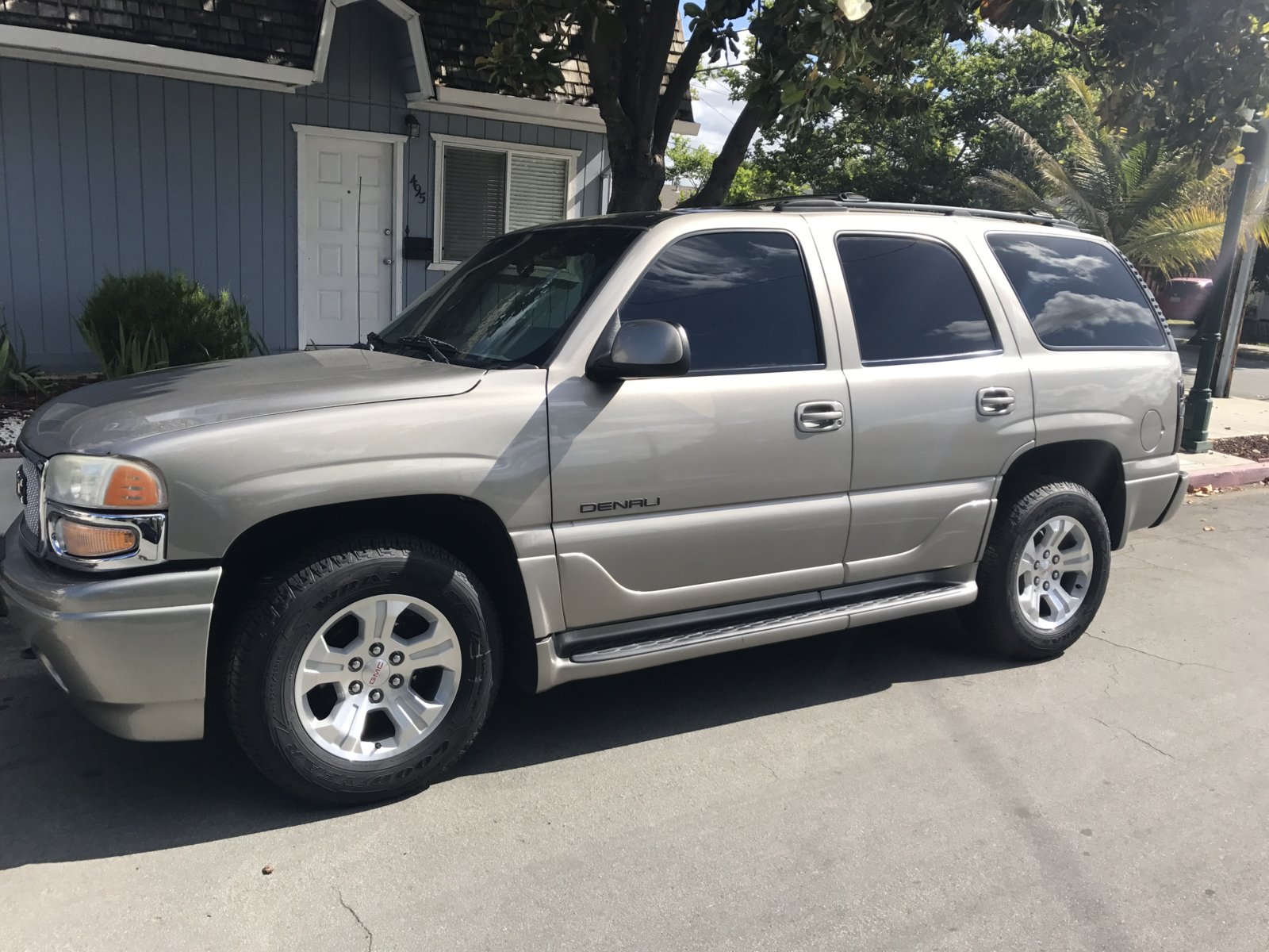

i have them on my 01 denali.. they look great and change the stance/ look. only rub a bit on the inside when i go offroading
Did you denali have z71 or similar option which I think might have an impact on suspension?
i don't believe there was a z71 package on 2001 Denalis. The stock wheels were 7.5x17. The ones I replaced them with are 8.5x18.. same diameter tire. looks much better as the truck was begging for wider wheels.. rides about the same... like i mentioned when it flexes there seems to be a bit of rubbing on the inside of one of the tires.. but i dont even hear it.
