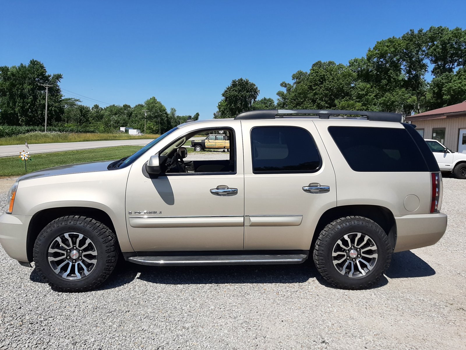

Yes you can, just don't worry about the extra mounting holes on the Z-71 rack that your regular rack doesn't have. If you are crazy about putting them in, you'd have to drop the headliner and put in nut-zerts
B-train
Sep 12, 2022
2,707
4,913
Here's a pic
