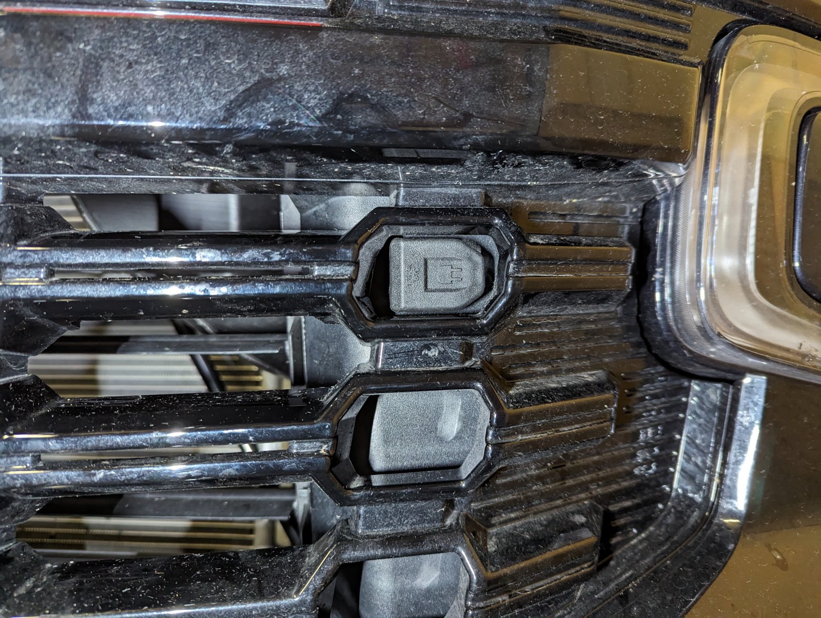

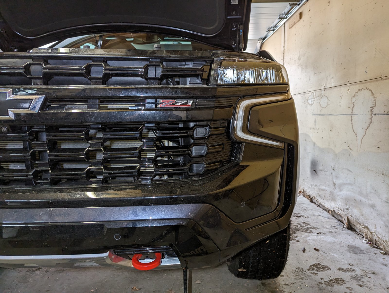

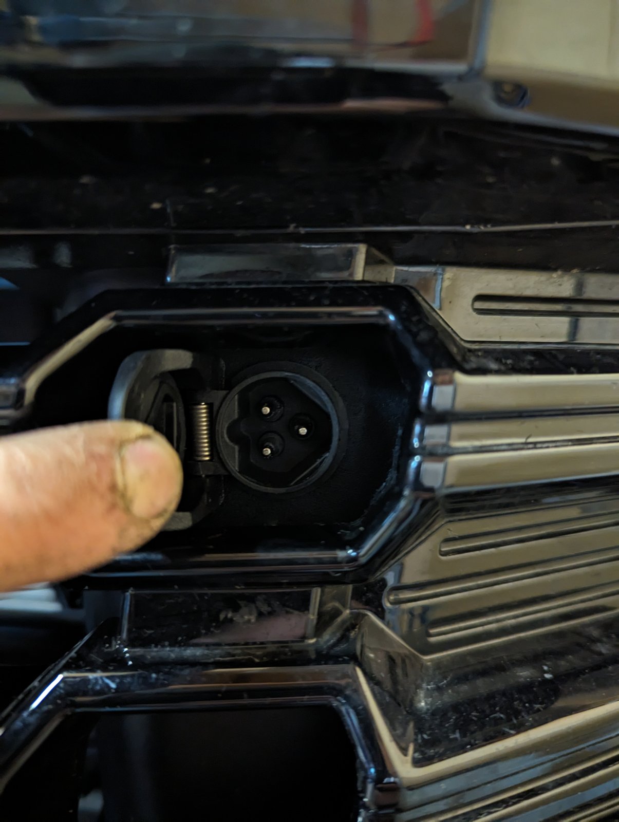

Today I decided to move the block heater plug from under the hood, and re routed it to the grille. No more opening the hood the plug my rig in during cold winter nights.
Took a little blind reaching up into the bumper and drilling a new hole ( be careful to make the hole the same as the one in the bracket)
