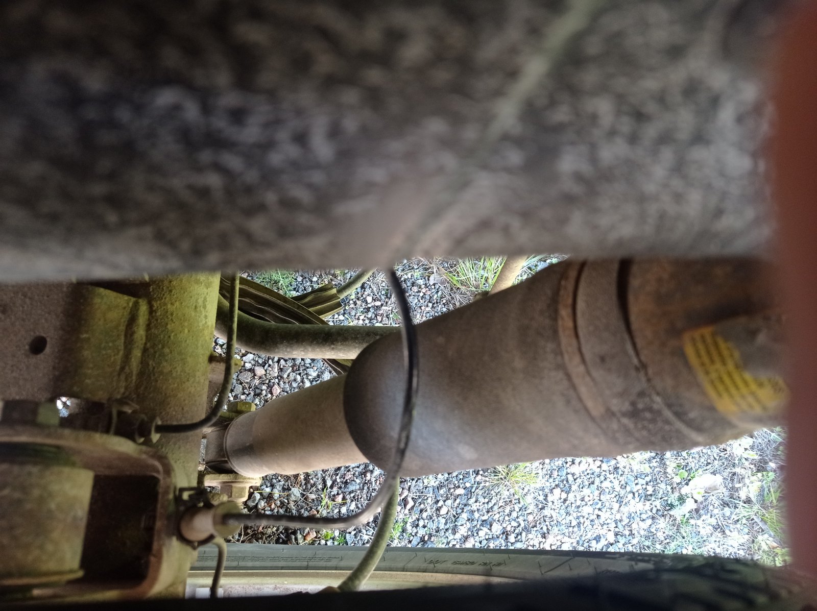

I'll crawl under it and snap a few pics tomorrow when it's daylight. It's actually not totally impossible it's been raised and it's in fact the front suspension "sagging". 20 inch rims, 275/55 tires. Got a fresh set of 275/40 for later just because it was cheap but the gap would become even more pronounced that way as is.
Edit:
Anyways here's a recent
to shed some more light on my issue.
Second edit: Rear shock struts: "BWI group 23487279" and front shocks "BWI group 20810264" I'll go have a read if it's OEM or not.
No signs of modification or tampering of rear springs.
One thing I noticed while under there was these thin rusty rods connected to sensors for each wheel.
Rear rods were shorter than the front; 2.3 inches compared to 3.9 inches in front.
I assume these are tied to the levelling of the car. I think I want to play around with these some as they feel they could easily be popped out and fiddled with. Wondering if it's safe though. At least I gotta check what the normal lengths should be.
