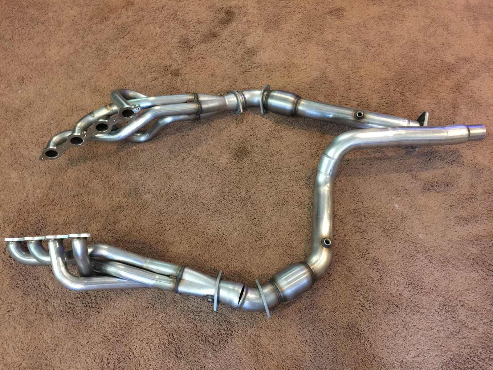

Looks like it goes from a single to a dual. Not what I consider a “true dual”. All the 4.8/ 5.3 factory setups that Ive seen use a y-pipe thus my recommendation to use a setup for a 6.0 which doesn’t use one. Unless you’re willing to settle for a dual from there back only. But the 6.0 midpipes wont bolt to the 6.0 manifolds I don’t believe so 6.0 headers would work. I don’t see the point going from 2 to 1 back to 2.
Bombsquad85
Aug 18, 2016
1,515
1,556
Northern VA
Yes the Denali exhaust is true dual all the way to the muffler so my recommendation is to buy American Racing or Kooks headers which replicate that and fit exact. Then you just need to have a muffler shop run 2 pipes from there back, incorporating 2 separate mufflers. That way with the headers you’re all the way back to just in front of the rear tires plus they sound badass. I don't have pics of the stock exhaust but here's my AR headers. They fit perfectly on my 02 Denali. I have a dual-in single-out Aero Turbo muffler with a single pipe for the last few feet where it goes up over the axle but like I said you could run 2 pipes and 2 mufflers. The biggest problem is those last few feet unless you do away with the spare but if you're running huge tires like you want, a regular size spare prolly isn't any good to you anyway. BTW why is there a chicken on your head in your avatar pic?View attachment 215485
Are those catted pipes?
I would love to get long tubes but I need cats and dont know what my best options are
