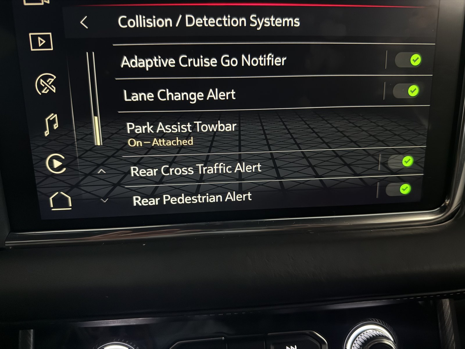

I just realized today that all of my park assist has not been working for months thanks to a pole I hit at the ATM. I never really noticed today and then realized my beeping/vibrating and visual indication on the dash has not been there for a LONG Time.
I push the park assist button and all I get is this:

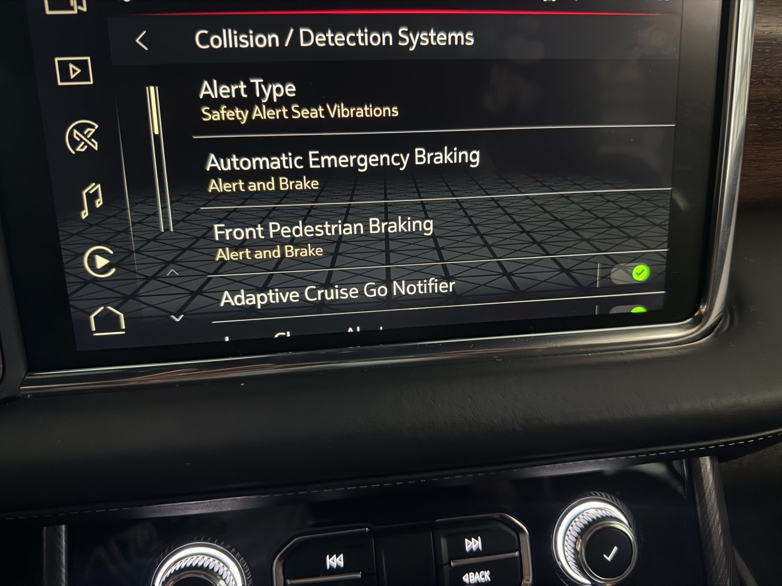

There is no option to turn the park assist on/off in the collision / detection system menu either.
Unfortunately as you can see I’m at exactly 36,001 miles - 2 miles until my warranty expires. I called the dealer and the soonest they can get me in is August, and since the warranty will be expired by then, I was told I’d be on the hook for repairs. GM’s policy is black and white according to the dealer.
The only option they have me was to drop it off tomorrow and wait until they have a slot open to look at it, which may be days or weeks and they could get around the warranty issue since i will be less than 5 miles over. That is a major inconvenience because I have a ton of travel coming up and they cannot guarantee a loner will be covered while I wait. Last time I will ever buy from Dave Sinclair again and if this is a GM policy, then this will be my last GM vehicle also. I have had zero warranty claims and of course as soon as I’m about to expire, something comes up, but that’s another discussion/rant.
Am I just overlooking something obvious to get the parking sensors turned back on?

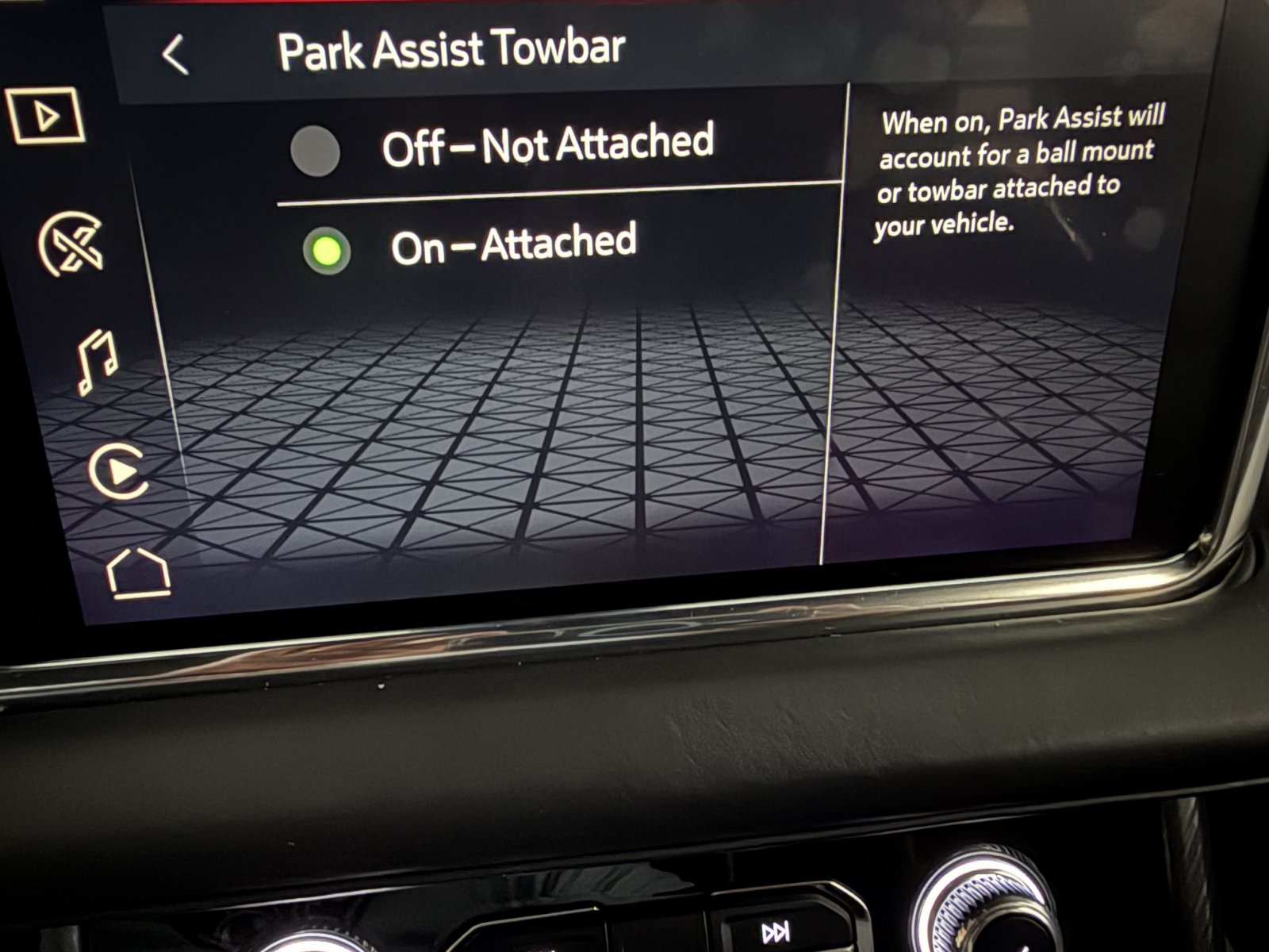

Did you damage the front camera or sensor with hitting the pole? I just went through this with my Sierra. If cameras are good go to fuse panel passenger side end of dash. Fuse 11 is at the top. Some have been able to resolve by removing the fuse for a minute or so then reinstalling.
That didn’t fix mine so the dealer got on the phone with GM and recalibrated the system. It was under warranty but no parts were needed. Just shop time which was a few hours.
If you damaged the camera it’ll be on you regardless of warranty it’s most likely the one in or below your bumper on driver side.
