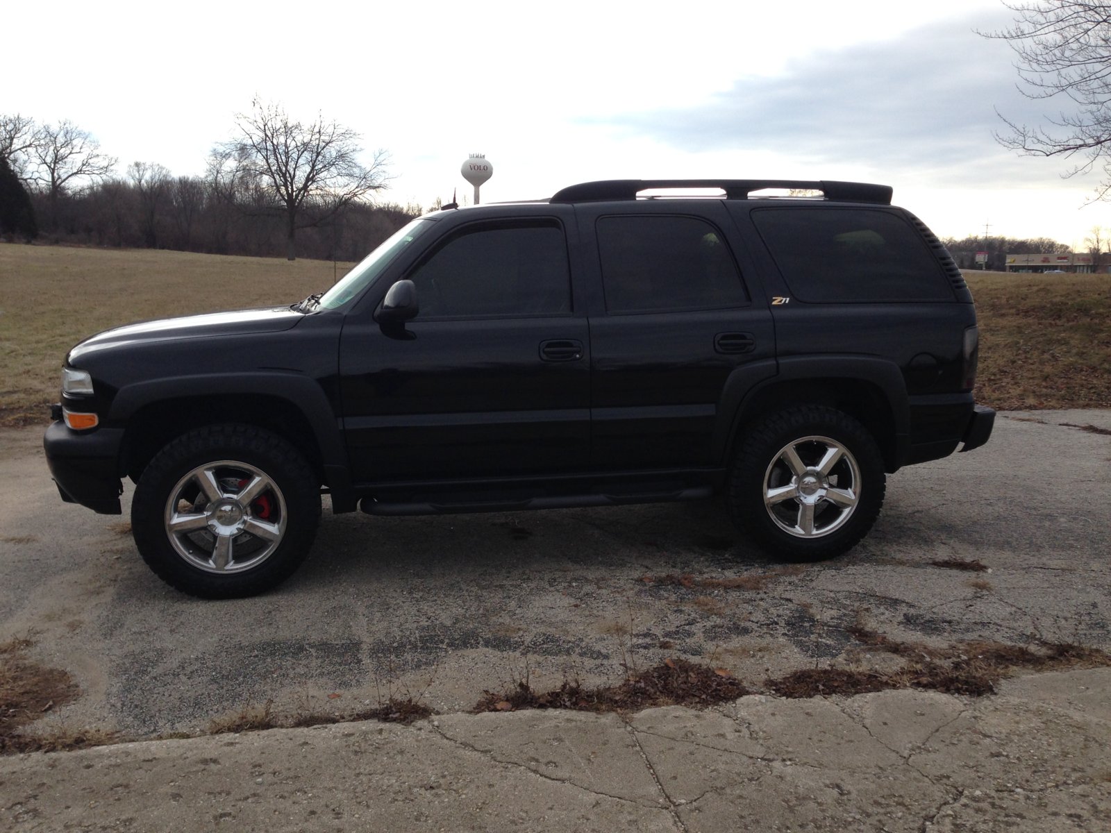

I put
275/60R20 duratracs 33inch on mine and it feels like im dragging an anchor compared to stock.Sure you can drive with 35's just major torque loss i can't stand how slow it feels.So more power or re-gear for me.To answer your question-the exahust should work from the truck-you made need to cut and reweld some exhaust hangar locations-and maybe slight mods.I would call an exhaust place to be sure.

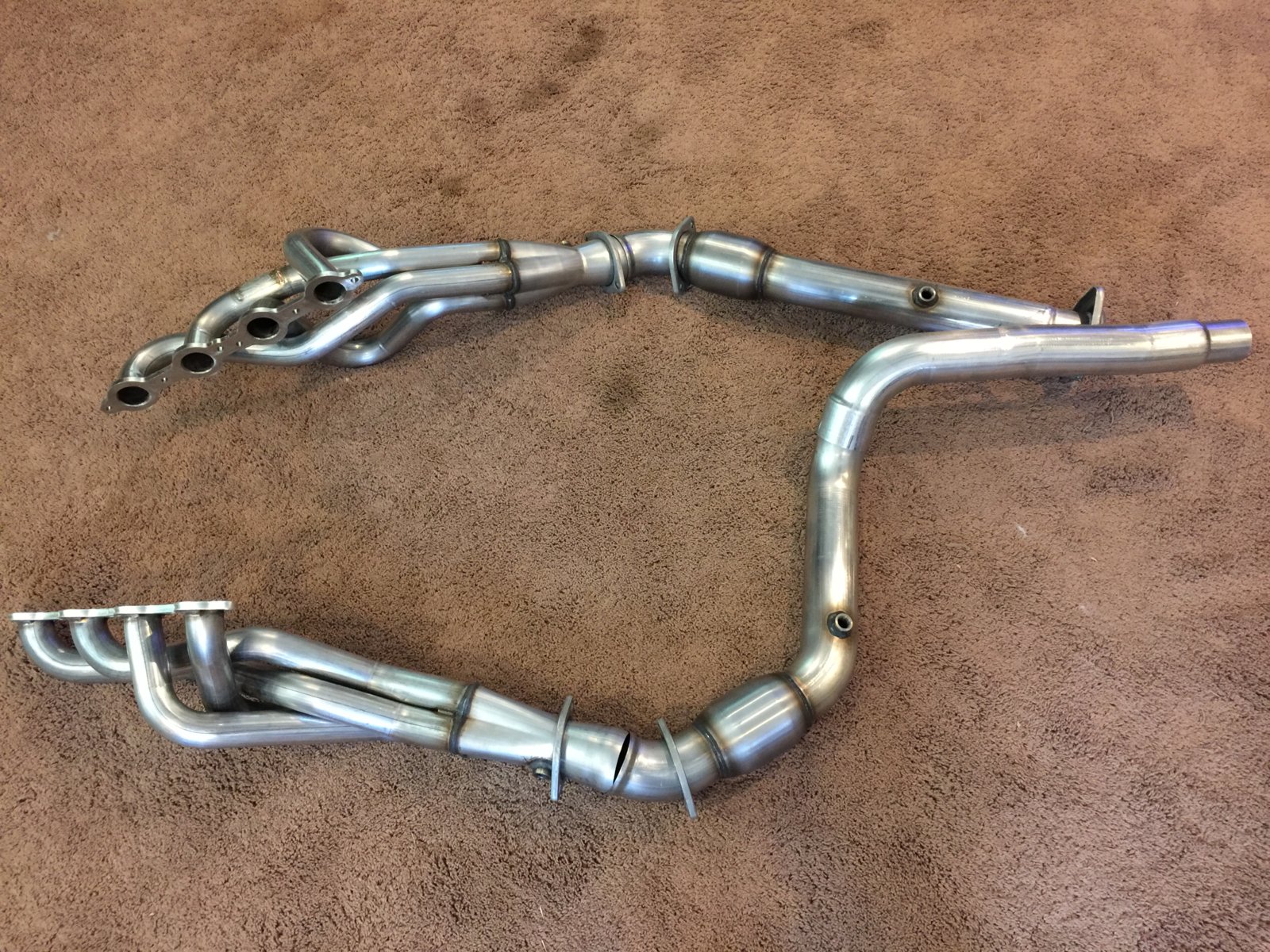

52,956
Yes the Denali exhaust is true dual all the way to the muffler so my recommendation is to buy American Racing or Kooks headers which replicate that and fit exact. Then you just need to have a muffler shop run 2 pipes from there back, incorporating 2 separate mufflers. That way with the headers you’re all the way back to just in front of the rear tires plus they sound badass. I don't have pics of the stock exhaust but here's my AR headers. They fit perfectly on my 02 Denali. I have a dual-in single-out Aero Turbo muffler with a single pipe for the last few feet where it goes up over the axle but like I said you could run 2 pipes and 2 mufflers. The biggest problem is those last few feet unless you do away with the spare but if you're running huge tires like you want, a regular size spare prolly isn't any good to you anyway. BTW why is there a chicken on your head in your avatar pic?
