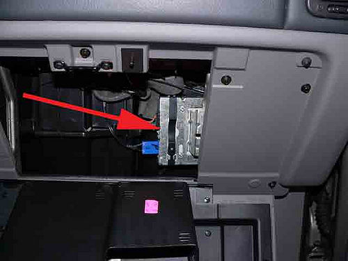

I had XM send the update signal but it's still losing the signal. I'm back to trying to access the rear of the NAV radio to check the antenna wire. How do I get to the back of the unit? Anything else that I should check? Is there a way to test the satellite antenna?
mwilson62000
Jan 20, 2015
428
1,404
I know with my 03, the OEM XM tuner is behind the glovebox. The roof XM antenna goes to that, not the radio. May want to check the antenna connection on the tuner.
