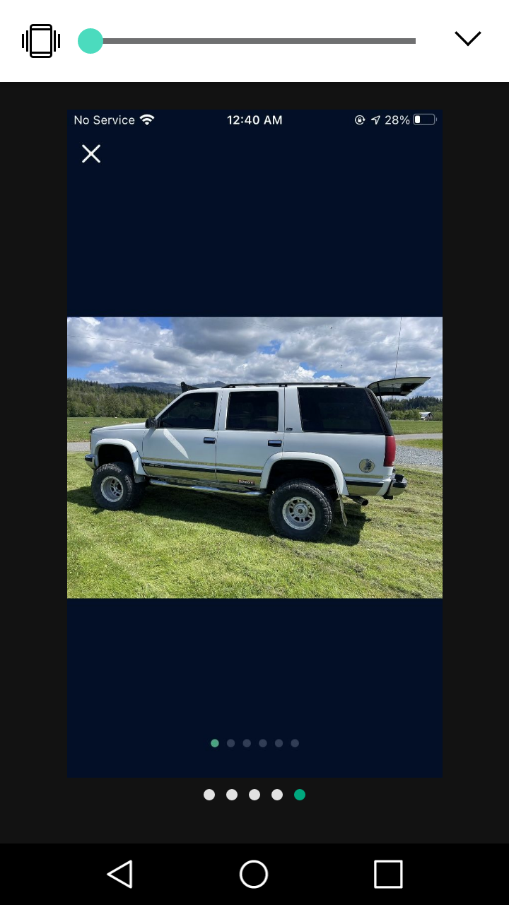

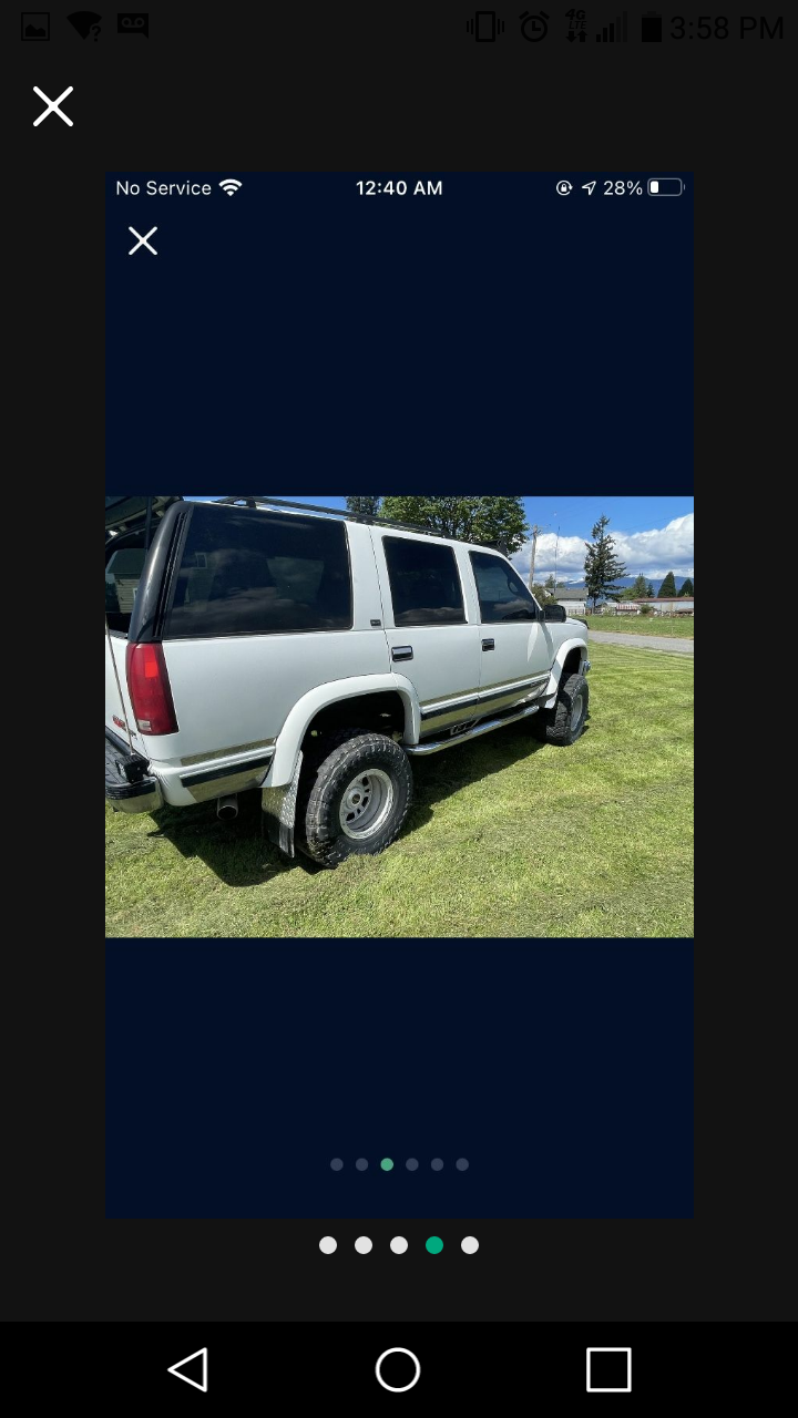

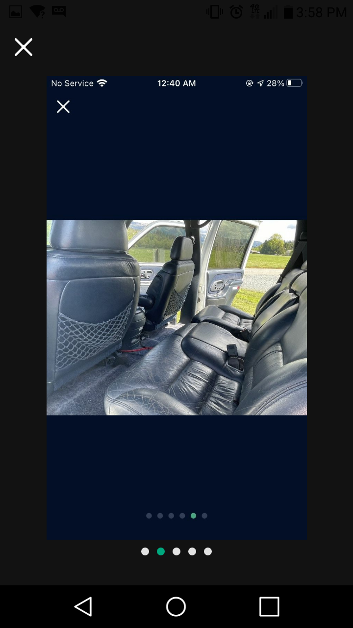

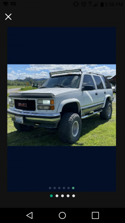

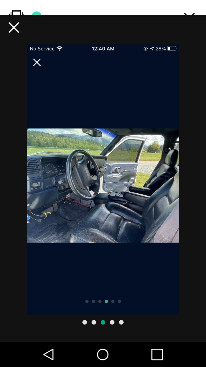

Welcome to the Forum from NH.
Pics of the truck, please.
You are already receiving sage advice from the knowledgeable folks on this Forum.

Screenshot_2022-02-01-15-58-03.pngScreenshot_2022-02-01-15-58-14.pngScreenshot_2022-02-01-15-58-20.pngScreenshot_2022-02-01-15-58-26.png
