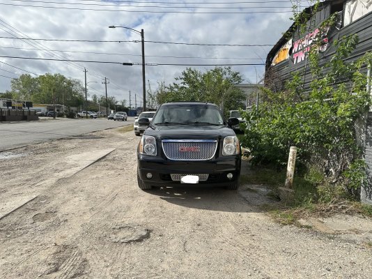

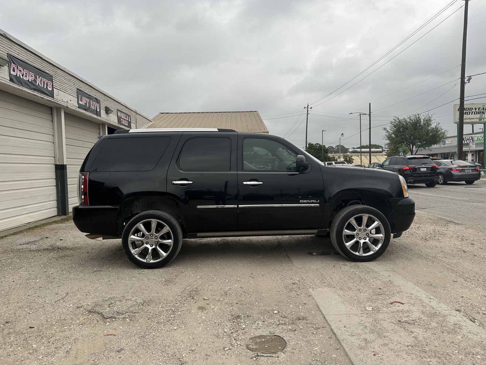

Good morning gurus!! Yes another question about tire fitment....I racked my brain trying to understand Z55 Auto ride, lift considerations, etc. @swathdiver got me lined out with every OEM component for all new suspension.
So here we are - dropped the 2012 Denali off this AM with a suspensionmaxx kit (adjustable front/1.5 spacer rear). I CAN NOT figure what size tire I should run!! As the pics show these are 285/45/22 (OEM 22 x 9 wheels).
I've narrowed it down to : (285/50/22) (33") or 33x12.5r22 , (285/55/22) Squeezing it with a 34" here
305/45/22 (32")
I'm looking for a proportionate fit, slightly wider with sidewall.....which the 22x9 (no offset) will obviously hinder me here. Nitto/Toyo
What size would fit the boxes here? I'm likely splitting hairs but I want to get it right!!
I appreciate any input and anything I might not be factoring.......(Ie - The guy at the shop thinks I'm sitting taller than most....likely because of the fresh suspension work which I'd think would setttle?
Thanks Again!

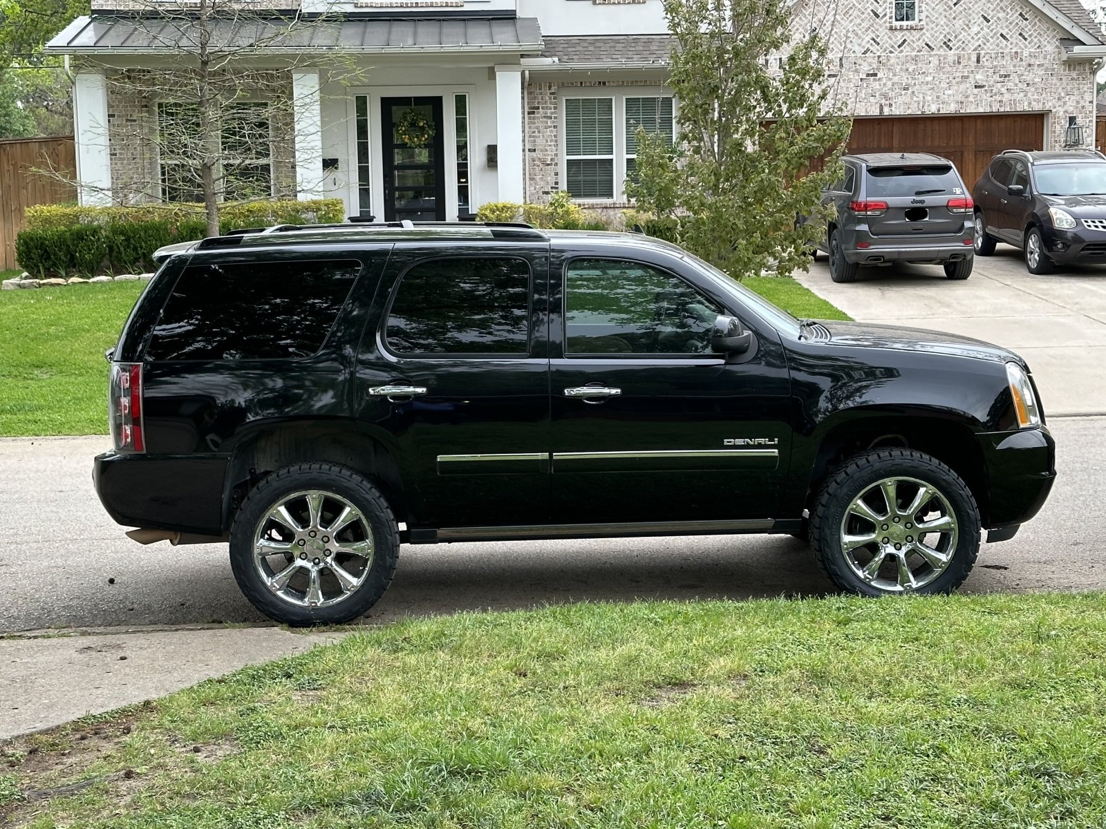

I am running 305/50x20 tires on my 07 Yukon XL Denali with a newly rebuilt Z55 suspension with stock height with no rubbing.
Aside from having a spare on the driver side it turned out well.
I can't decide on tires though: (currently 285/45/22 Duellers) not impressive and weigh 47 lbs
Considering (285/50/22) Nitto Recon Grappler -E rated weighing 60.4 lbs
(285/50/22) Toyo AT3 - E rated weighing 56 lbs
(305/45/22) more options for LT rated tires but still in the 32" range
Anybody have an idea of calculation of power gain loss/lb of weight on tire?
I like those occasions where you can let that 6.2 rip on the entrance ramp and lord knows I already get 13 MPG....I need a happy medium.

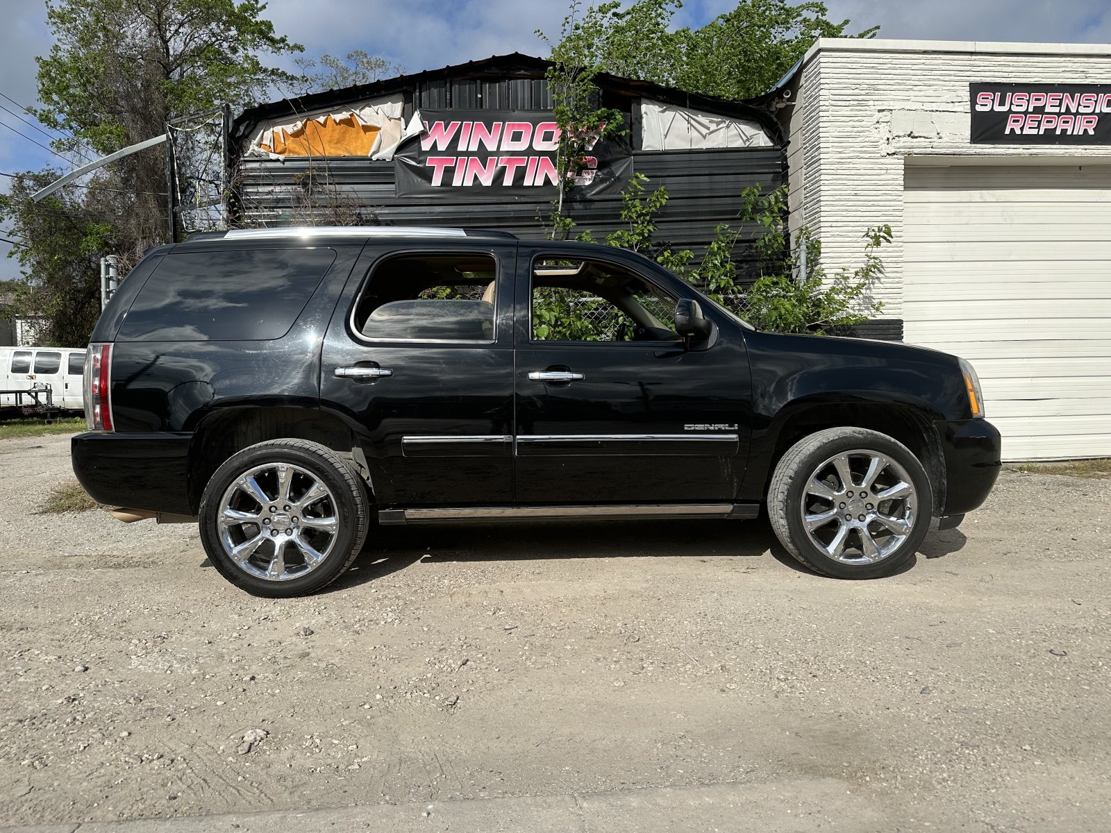

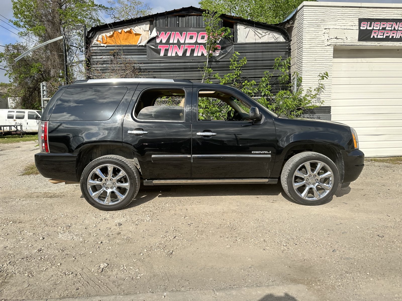

Apologies Gents - I've been out out of town and away from this headache of a project (never thought a level kit would be such a PIA)..... @swathdiver - You have an impeccable way of simplifying things in a logical comical manner! Great analogy!
@Joseph Garcia I installed Nitto Recon Grapplers 285/50/22 (from 285/45/22). Tires are great but rubbing BAD. I believe it's due to the OEM offset being + 24 (or along these lines) as I think they're rubbing on the inside (maybe control arms) NOT WHEEL well therefore theres nothing to cut out.
The only thing I can think of is to add spacers (which I believe is not always advised). Anyone have thoughts/ideas here? I'd thought a 285/50/22 would'be been a cake walk....
