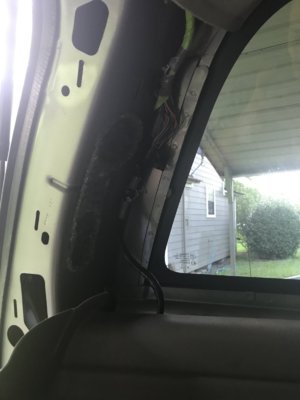

Hey folks, been searching for awhile and can't find the answer to this. Does anyone know which wires in the large, taped bundle that run all the way down the driver's side then up and over to the passenger side are keyed power and ground? I'm trying to install a backup camera and those are my easiest wires to access.
Thanks!

Best place to find the reverse wire(keyed power) is behind the drivers side A pillar...remove the pillar and look for the lime green wire, that's your reverse wire
For ground, you can simply tap into just about any black wire

I'm hooking up a backup camera. I have the headunit hooked to the reverse light wire coming out of the bcm to trigger the camera when I put it in reverse. I want have constant power to the camera whenever the truck is on so I can toggle to the camera even when the truck is not in reverse.

Get a probe and test each wire with key on, tape them off, then turn off key and check those taped off wires again.

Yeah, I guess it's as good of an excuse as any to get some needle probes for my multimeter. I just thought that somewhere out there there has to be a diagram that could get me by.

Thanks guys. Ended up running a wire all the way up to the fuse panels and into one of the ign slots. Camera works great! Thanks.
