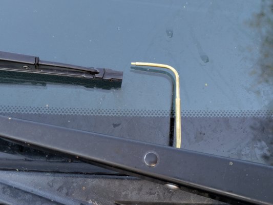

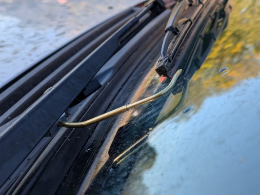

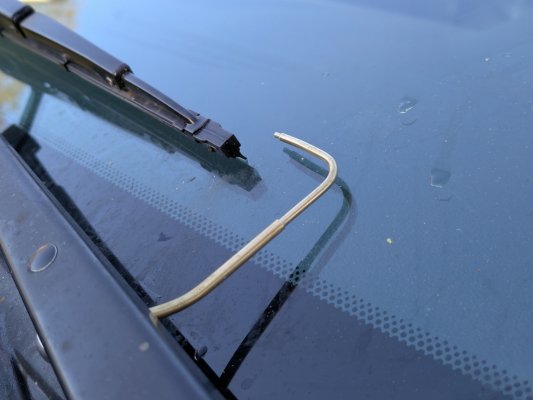

Well, I finally got around to fabricating a solution!
I machined an aluminum distribution block to go under the wiper arm, with barbs to tap into the existing hose and a 10-32 machine screw to attach the block to the arm. The new squirter is epoxied into the block and is fabricated from three K&S brass tubes (8125, 8126, and 8127) and has a nozzle diameter of 0.035".
I'm delighted to say it works great! Now the blade doesn't have to do the first sweep dry, and the ~4"x~8" patch on the lower left that never got cleaned has been reduced to a ~1"x~1" patch.
Once I'm certain this is the final configuration, I'll paint the tube and screw with some SEM 39143.
