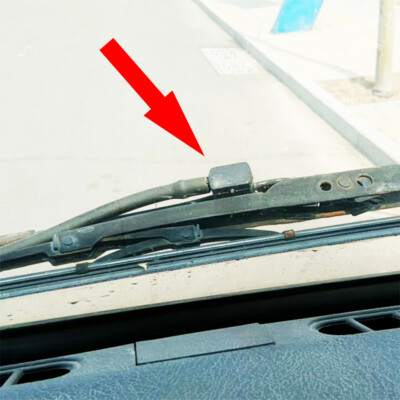

my volt has hood mount sprayers that work great. could do something like that, they sell those retro as well if you went that extreme.
I've not seen the ppv arms. Definitely room on my standard ones. looks like mine spray out of the end, instead of at a right angle to spray up.

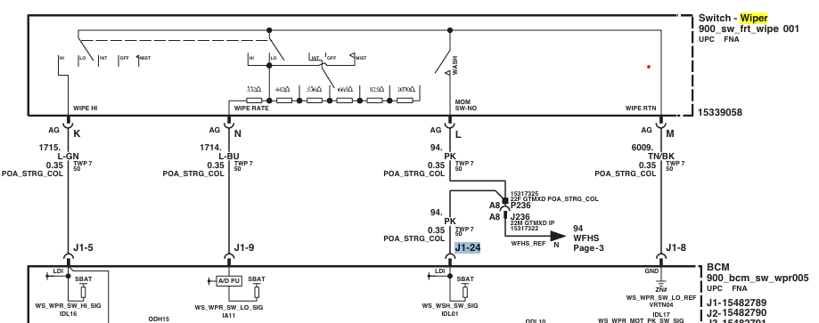

interesting thing. sucks the water doesn't spray first. if these things weren't so canbus based, a small delay relay on the wiper motor would work. 2 seconds would probably do it.
I thought about that too, but then when you want to do a quick wipe, you have to wait 2 seconds..

Think there is a way..
Connect J4-15 on BCM and splice it to L terminal on wiper switch, delay circuit between L and J1-24.
(I'll probably connect everything on the BCM end, but mentioned the L terminal so there's no confusion)
That should activate the washer right away, and post delay circuit will connect to BCM J1-24 to do the wipe.
So we're delaying the ground trigger to the BCM that tell's it to wash/wipe, but are passing that signal to the washer relay immediately.
It's a separate signal from the mist or interval wipes, so there should be no delay there..
De-pinning J4-15 at BCM should work since the L terminal will be grounding the washer pump relay directly.
But leaving it connected should be fine also... (I'll probably de-pin it and wire heatshrink the terminal end so I can keep wire intact)
Will try it sometime this winter!

@j91z28d1, thanks for pointing out those clip-on squirters. I'd seen them, but discounted using them because where they'd clip on would still be in front of the blade. As for hood-mounted squirters, my overall policy for the Tahoe is to not implement anything that cannot be reversed, and cutting into the hood would not be reversible. I suppose they could be mounted through the cowl grilles, but that position looks as if they'd be blocked by the arm, rendering that placement ineffective.
@mikez71, before I got my LTZ, I was primarily looking at PPVs, but the wiper arms being different passed my notice. Do you know the rationale for different arms? It looks as if the squirter in that position on the PPV arms covers both sides, or am I wrong about that? On the subject of an automatic delay, I know that's implemented on other cars, as my '94 Camry had that.
