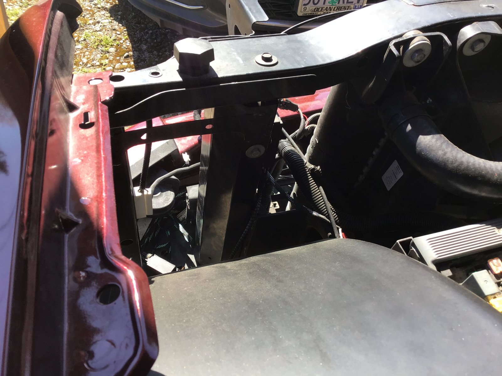

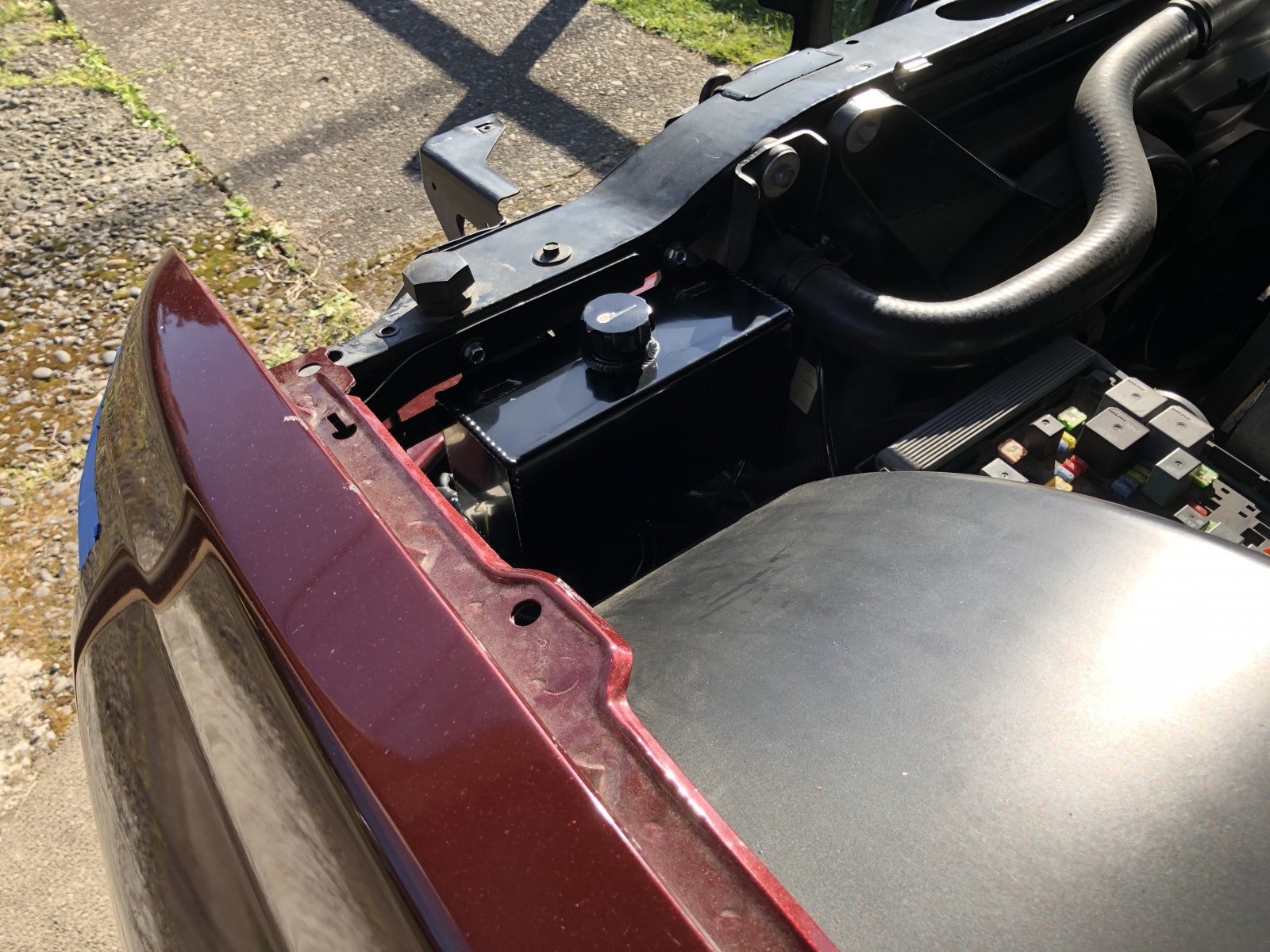

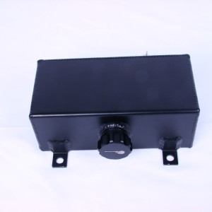

In my Silverado I used an ON3 Performance turbo mustang washer fluid relocation tank. just need to modify the wire harness and find a spot to mount it. I've been using it for a few years without any issues. https://www.on3performance.com/shop/on-3-performance-aluminum-windshield-washer-reservoir-w-pump/
Oh man I like this way better than the universal plastic reservoir I bought. I’m going to order one. Thanks!

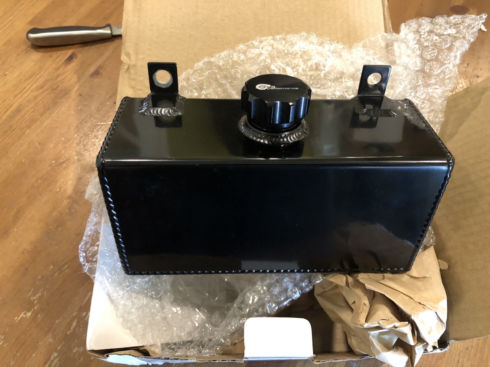

I looked at my engine bay, looked at options, and decided the On3 reservoir made sense for me. It fits in my limited space, it’s not ugly, and it includes a pump. At first I thought $75 was a bit much but that’s about what a new OEM plastic one with pump would cost. It’s ordered. Thanks for helping me spend money @Dantheman1540. It will be nice to have washer fluid.:D

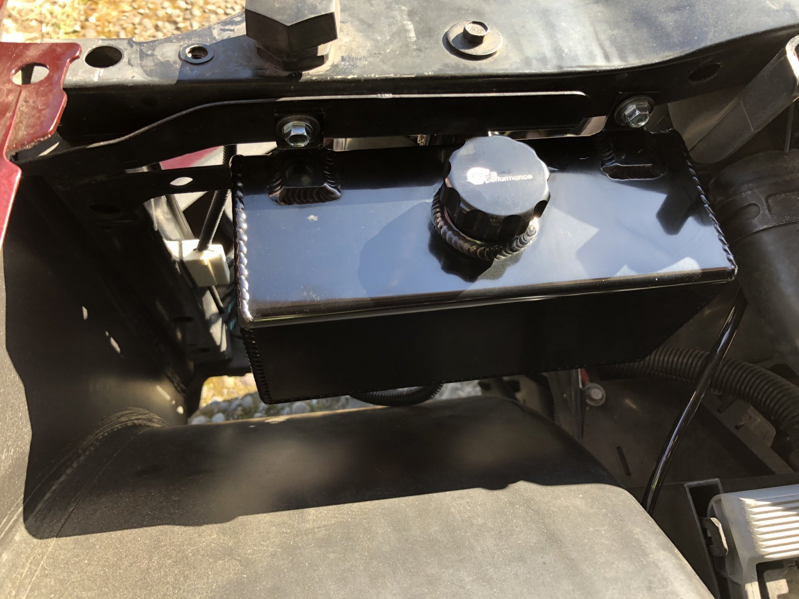

Nice glad I could help! post pics when you have it installed I need to find a new spot for mine.

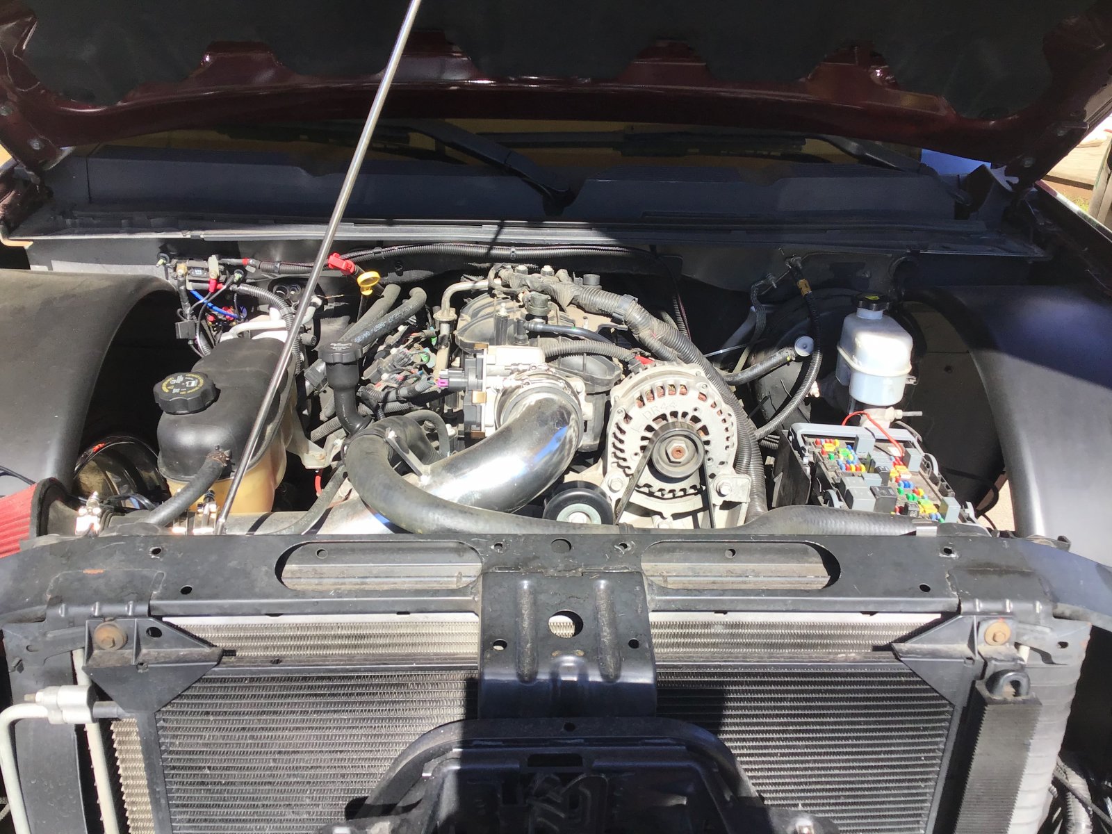

I’m putting it to the left of the radiator but the engine bay on my Silverado has tubs that take up a lot of room. The fuse box, battery, and coolant overflow tank are all relocated.
