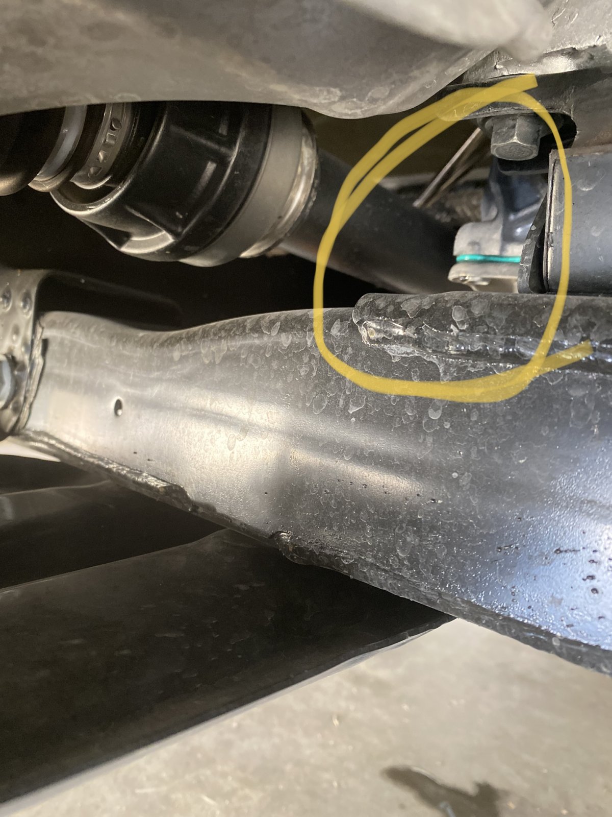

I have a 21 Yukon Denali, just over the weekend I had the low washer fluid warning on the dash. Filled it up, the next day upon starting the warning was on the dash and again the reservoir was empty. I removed the front wheel well liner and looked around the reservoir. All the piping looked ok and when I filled it again, I couldn't find the leak. It must be a slow leak... Has anyone experienced this? I haven't been able to locate the issue. Taking it to the dealer this week, but it is a hassle. Would appreciate any insights.

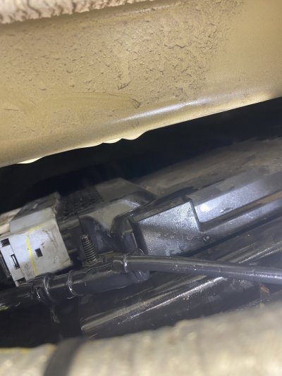

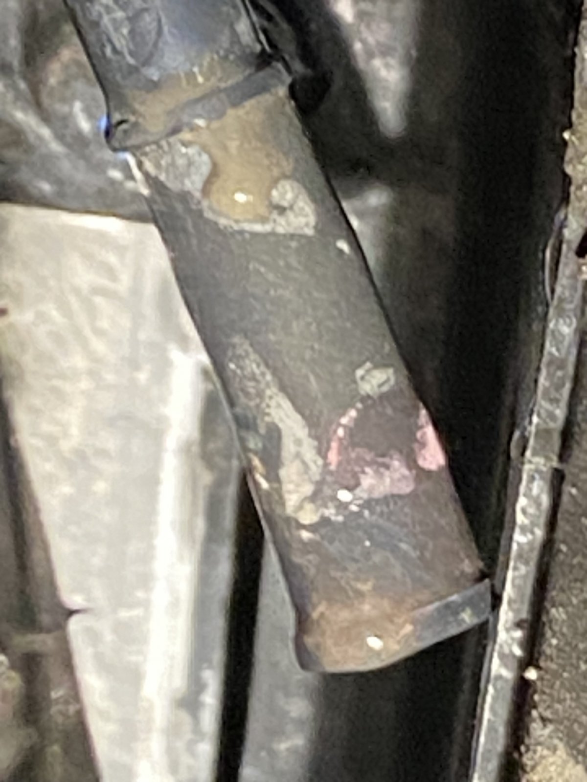

I had a similar issue last week, it ended up being a barb fitting had come loose from the rubber supply hose. The location was the top of the passenger rear frame rail near the spare tire. My leak was obvious once I refilled the washer fluid tank.

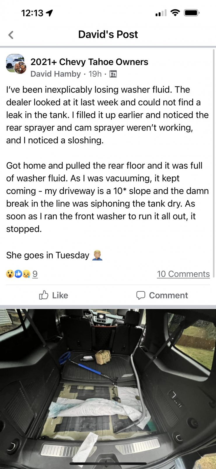

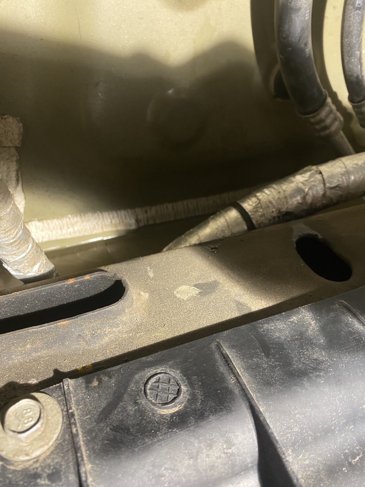

I have the exact same issue with my 21 z71 Tahoe. I’ve filled it up 50+ times since I’ve owned it, leaks out in 1-2 days. Taken to dealership twice with no resolution. I can’t upload the video but looked to be coming from here once while I noticed fluid dripping underneath. I added a screenshot from a Facebook page where someone ripped out their carpet in the rear and found the leak. I haven’t done that yet, but seems it could be something worth checking. Will be taking mine back in as well, just filled it up 2 days ago and it was empty again yesterday.

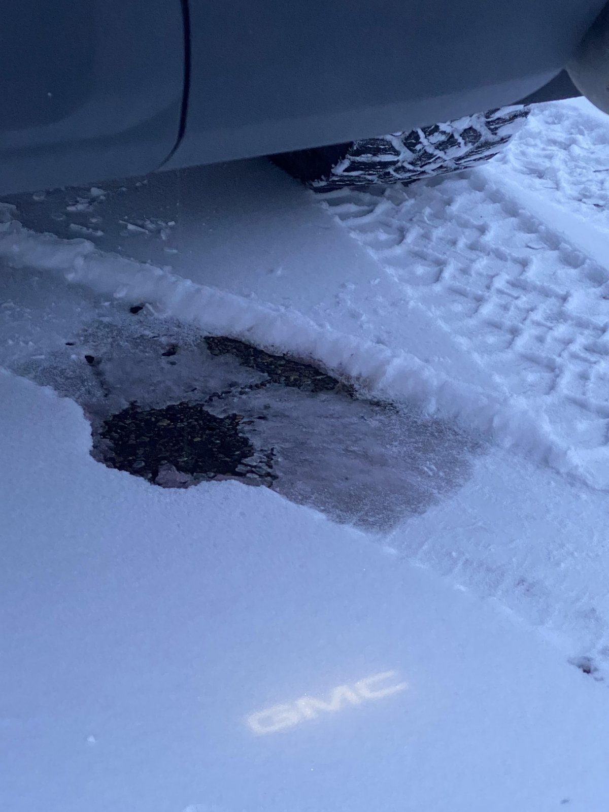

Update on this, took the truck to the dealer and they kept it for two days. They were not able to replicate the error. and the WW Fluid reservoir kept full Despite numerous calls and asking them to literally check everything and trace the lines. I was running really late to pick up the truck and squeezed in minutes before close. It was snowing pretty good at time of pickup. Remote started the car from inside the shop as I completed the paperwork. When I first sat inside the truck, the first error message on the dash was "washer fluid low". Needless to say i was frustrated in this, I walked back to the shop to find the doors locked as they had closed. I walked over to the sales side and asked for a sales manager to come out just so I can "prove" I am not crazy and the truck had no WW fluid. The sales guy apologized and filled the tank for me and indeed confirmed the no fluid level. With the truck still running the front wipers ere intermittently coming on as it was snowing. I turned on the rear wiper and activated the rear wash, it all looked good. The sales guy asked to photocopy the sales receipt so he could pass it along to the service department the next day with some notes. While he was inside I walked around the truck, the colour of the WW fluid he had just put in was bright pink, while standing behind the car I saw a small pink puddle start to appear in the snow just underneath. When the sales guy came back out I showed it to him and there was a constant stream of liquid pouring out from underneath. I was able to take video as well as a few shots. Back to the dealer again, @d_hawk was absolutely correct and this is where the leak is originating.

Glad you were able to figure out the leak. It is easy enough to push the barb fitting and rubber supply hose back together. I saw no evidence of a spit hose or other damage, it seemed like it was not connected correctly from the factory. FYI, I could not fit my hands in to reconnect the fitting without dropping my spare tire down to make some hand room. Literally took longer to get the spare tire tools out and crank down the spare than to fix the leak.

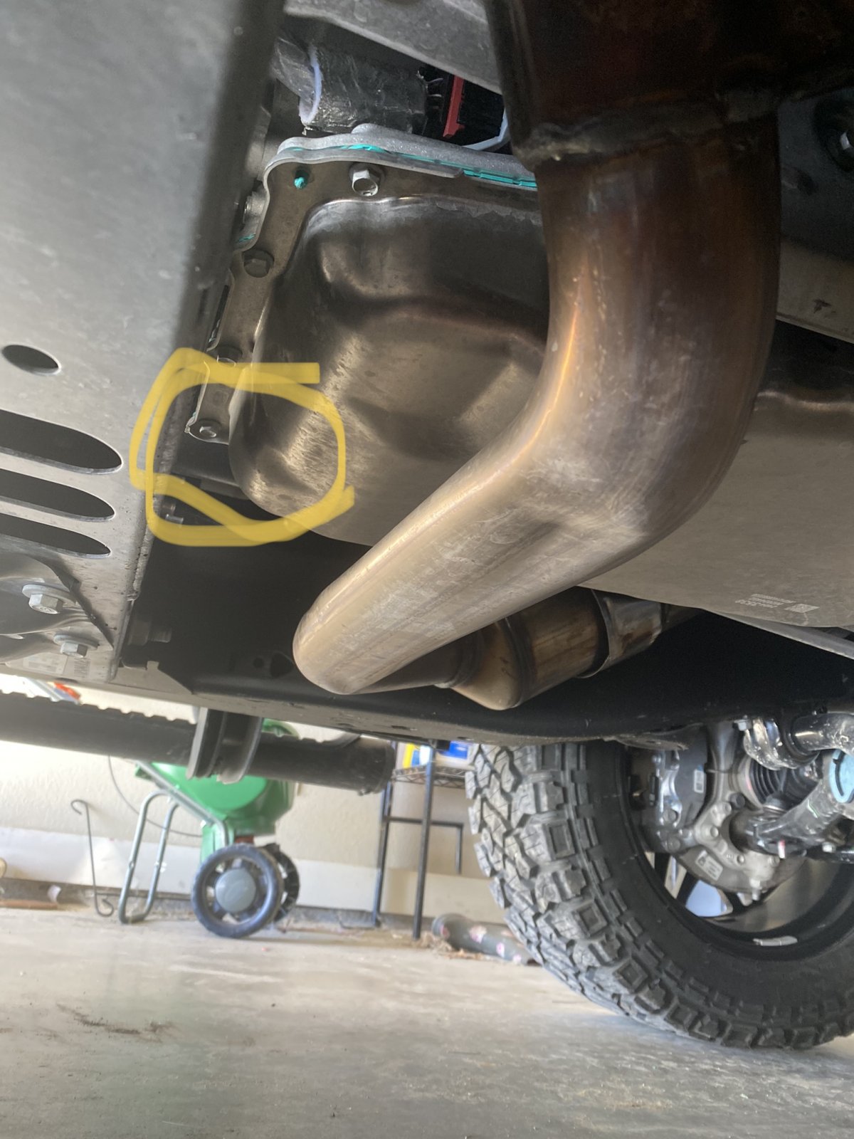

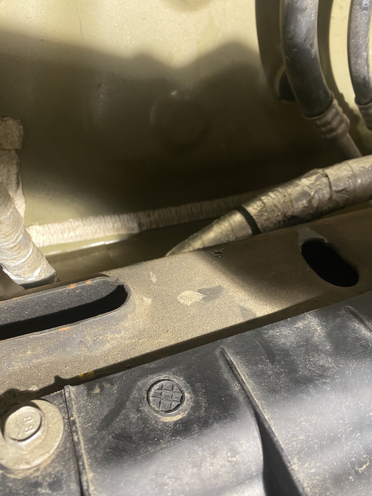

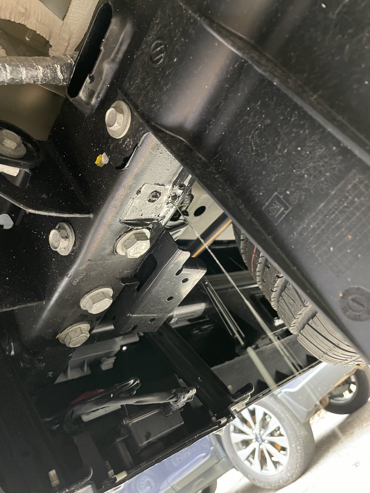

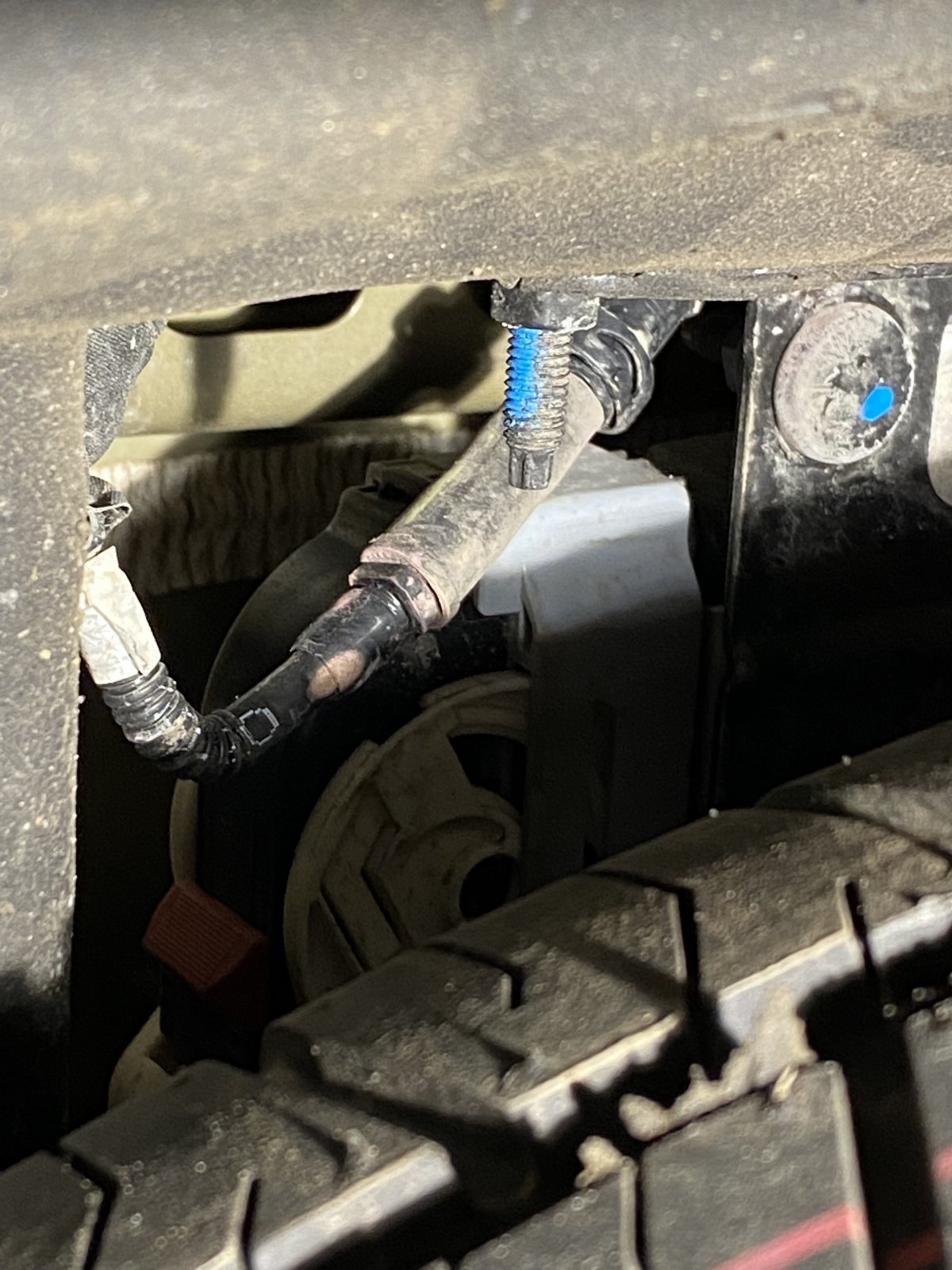

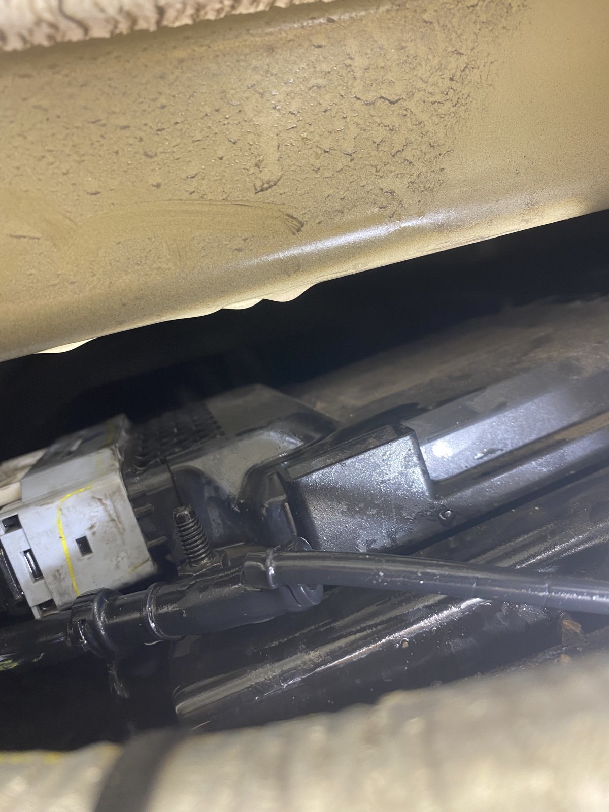

Crawled under the truck this morning and was able to make the fix. As you said @d_hawk fairly straight forward. For anyone else with this same issue, i have uploaded a couple of photos. Best way to access is just above the frame of the passenger side rear quarter. I was lucky to be able to do this without dropping the rear tire. The one photo is of the frame, the rest are the two lines essentially lying next to each other.

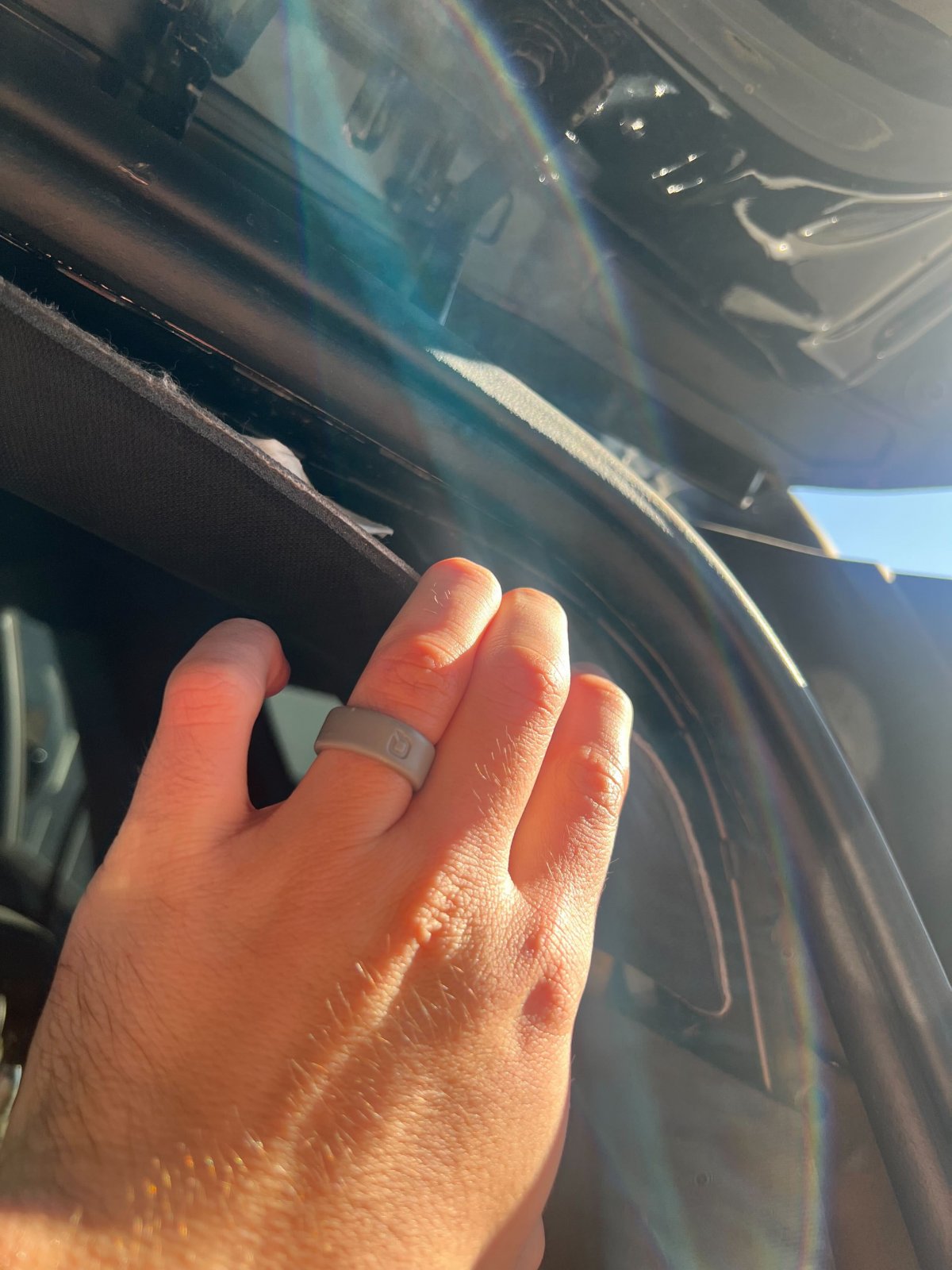

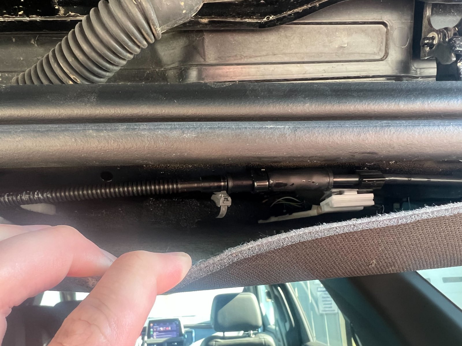

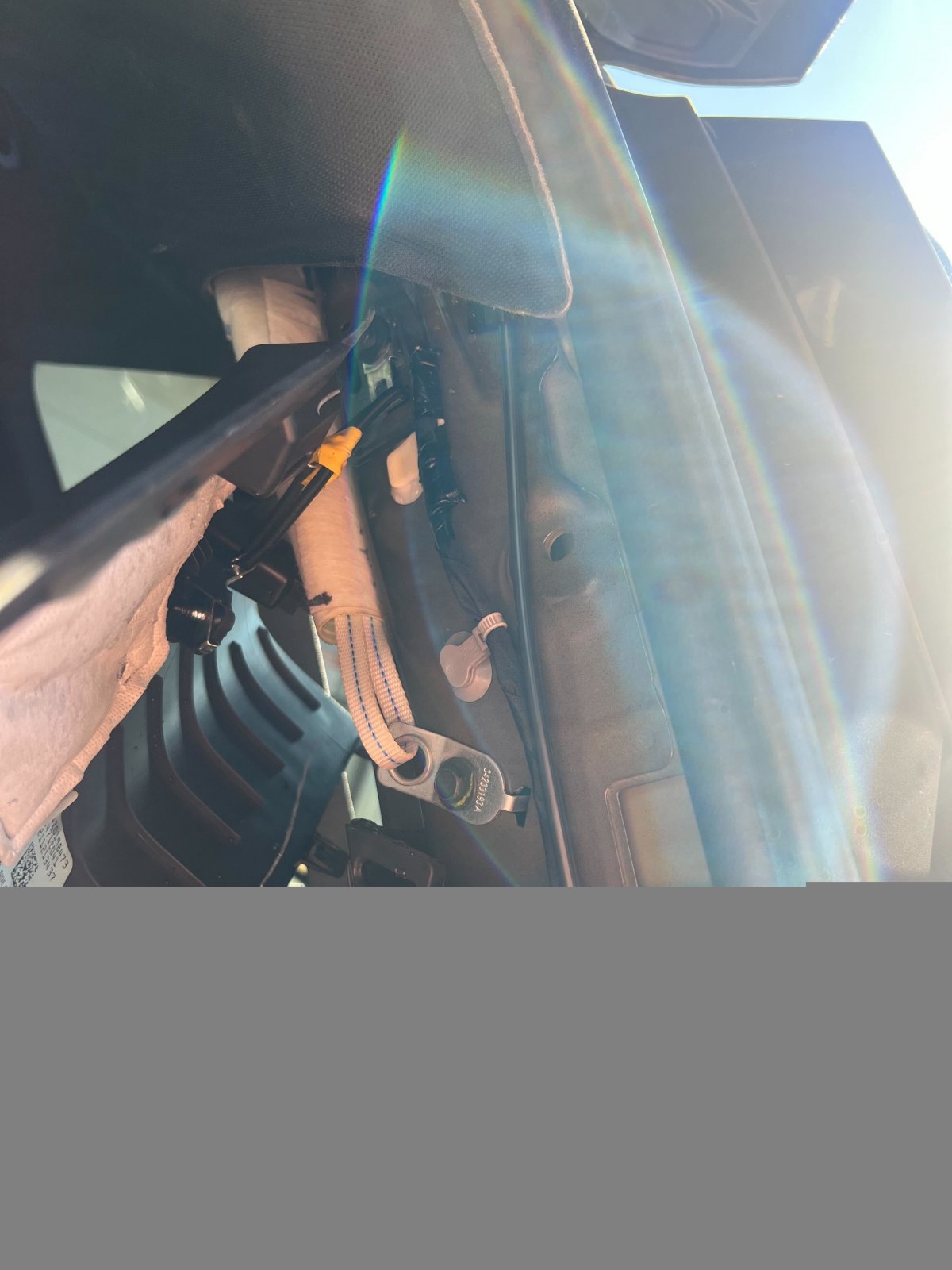

If anyone wants to save $318 or a trip to the dealer. Try what @Samuel Ross said. Mine was also disconnected there. When I reconnected it, I experienced the same thing that @KGC1978 did. I pulled off the small panel at the top & rear, next to the rear hatch. Then, pulled back the top liner and found another tube connection completely separated. Everything seems to work and the reservoir holds fluid now.

There's a connection inside the cabin just as the hose comes inside. You'll need to remove the rear floor storage console, D-Pillar trim and rear sidewall trim to see it. It's this connection point circled in the picture. If that is leaking, then the area under the floor storage is probably filling up with washer fluid and hence you can't find the leak.

Hey
I wanted to thank you again. This is the spot it was disconnected, and I think it would have taken me a lot longer to find it without you help.
Glad it helped you find the problem! Was the back of your rig filled up with washer fluid? :confused:
