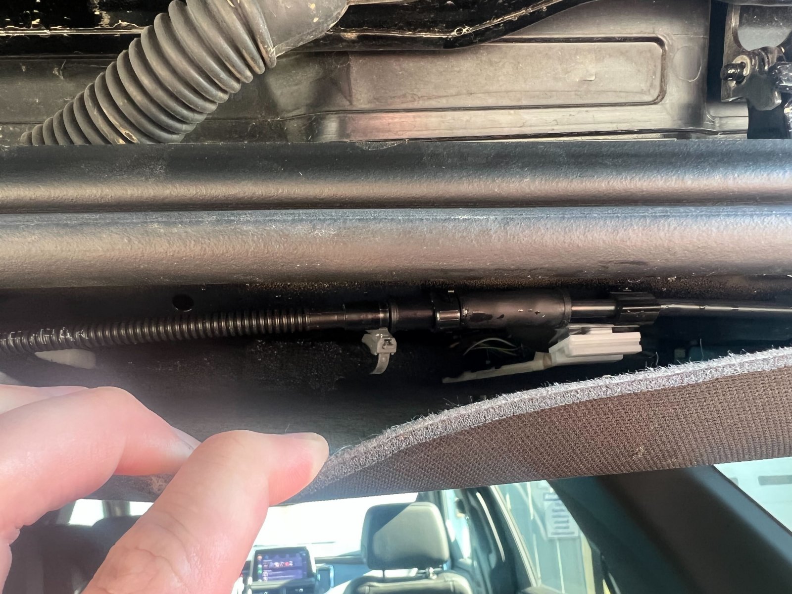

This is happening to my 2021 model. I have traced the lines and tested for fluid flow to the connection above the battery. It is good. My rear is not spraying at all. I checked the connections under the right-side rear and under the rear headliner and they are connected. I am going to separate the hose above the headliner and see if fluid is reaching this point. If not, it has to be the nozzle or where the hose is attached to the nozzle or I am missing where a hose connection is. Feel free to chime in if you guys know something I don't!! Now I just have to figure out how to access the nozzle area.

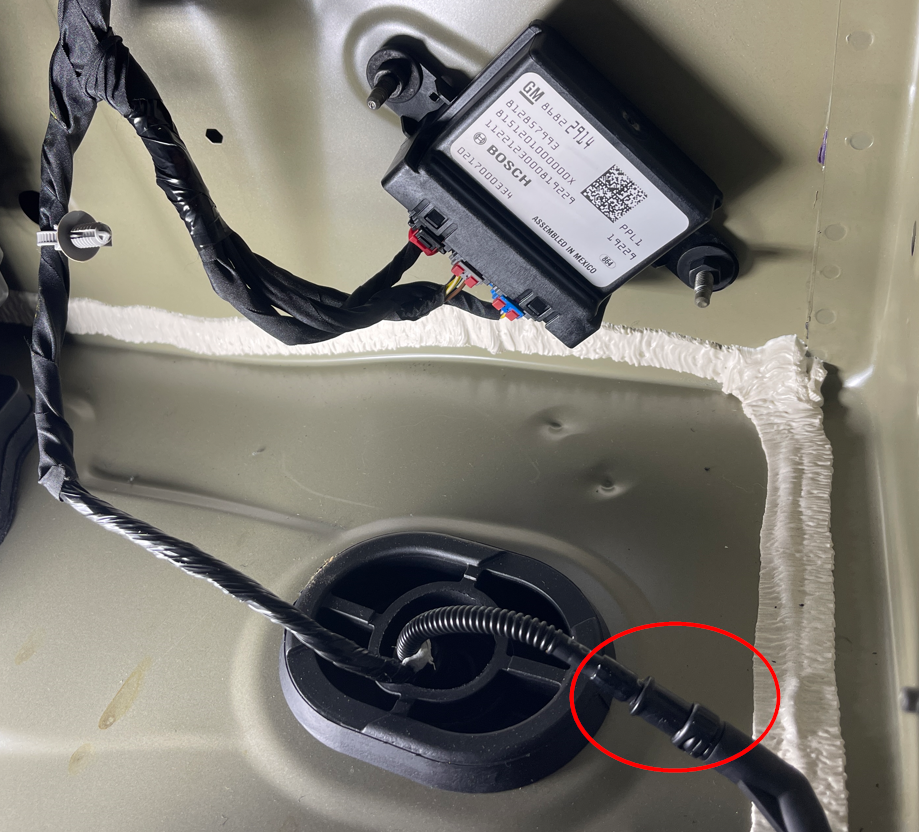

There's a connection inside the cabin just as the hose comes inside. You'll need to remove the rear floor storage console, D-Pillar trim and rear sidewall trim to see it. It's this connection point circled in the picture. If that is leaking, then the area under the floor storage is probably filling up with washer fluid and hence you can't find the leak.
So I've got a leak somewhere in my '23 Denali. Same routine -- no fluid from the rear, then no fluid from the front, and a freshly-filled reservoir emptied during/after (2) 1-hour drives (but within 6 hours of refilling the reservoir).
Now, I DON'T feel dampness at the rear seats' carpet. Does that mean that I don't have a separation of tubing inside of the truck/at the rear headliner?
Also, what's the above pic showing, exactly? Are those two lines coming out of that black grommet in the CEILING, or FLOOR, or... Where?
Thank you!

The picture is the lower RH corner - removing the rear floor console and then the side panel trim will show that area in the picture.
You won't feel dampness in the carpet if it's leaking at that point. Your floor area below your floor console will fill up with washer fluid though, but there's a ledge between that area and the carpet in the 3rd row so it won't leak into there.
Take out the floor console - if yours is a standard length, there's two large plastic nuts to remove and then the console comes out (4 if it's an XL length). Then you'll see the underside and if any washer fluid is leaking into that area. To get access to the hose as shown in my picture you just need to remove the plastic trim around the 3rd row speaker, the tie-down for the cargo net + anchor and then you can pull the sidewall trim away from the cab and get to that hose.

If anyone wants to save $318 or a trip to the dealer. Try what @Samuel Ross said. Mine was also disconnected there. When I reconnected it, I experienced the same thing that @KGC1978 did. I pulled off the small panel at the top & rear, next to the rear hatch. Then, pulled back the top liner and found another tube connection completely separated. Everything seems to work and the reservoir holds fluid now.

Thanks again for this. Was going to give this a whirl yesterday, but didn’t know just how much of the side panels I’d have to remove to access the tubing. Do I just need to pull enough away at the D-pillar to find the hose? Or do I have to remove the side panels completely? And, do I just need to remove the rear passenger side side panel, or could the tube be running up the driver’s side D-pillar? Thanks!

The D-Pillar trim piece that does not have the speaker and is up near the headliner needs to come off first. Just pull it away from the body. The trim with the speaker in it has one 7mm head screw that needs to be removed, then pull it away from the body.
Once those two pieces are removed, remove the cargo net hook from the sidewall trim along with the D-Ring anchor. You can then pull away the large sidewall trim piece and get access to what I showed in the picture. There is no washer fluid line on the driver's side.
