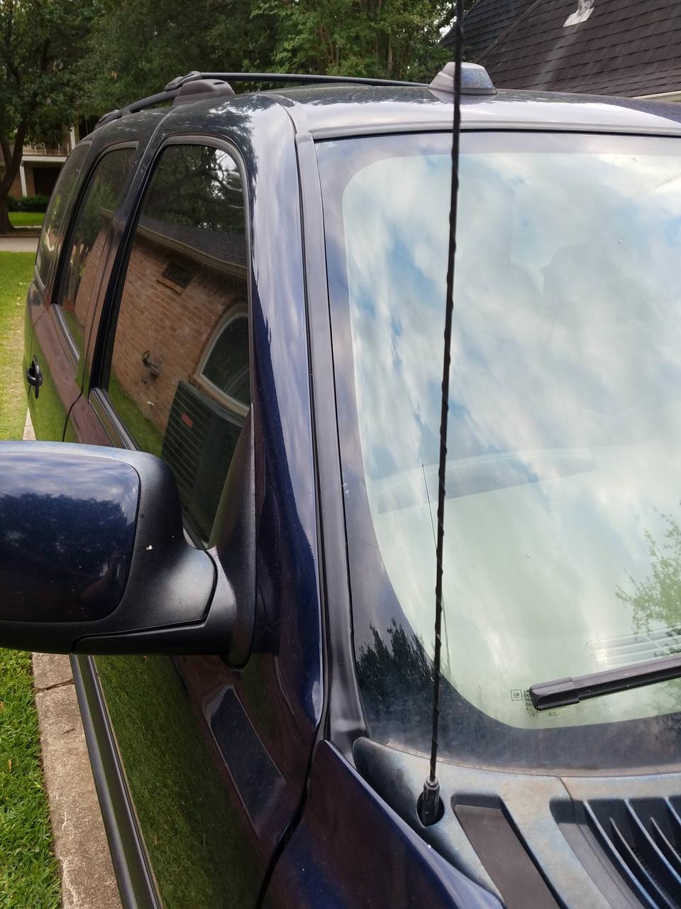

Anyone have the part numbers for the trim that runs vertically on the left and right sides of the windsheild? my truck hasnt had it since i bought it and i i get some wind noise at highway speeds that im guessing is from missing that piece since it basically blows right into the already loose rubber weather strip. 05 tahoe LT
this ^^^^ piece right here that runs up the edge of the door.
Ive been scouring LMC truck, GM parts websites and i cant seem to get the verbage correct or a part number. i need it for both sides.

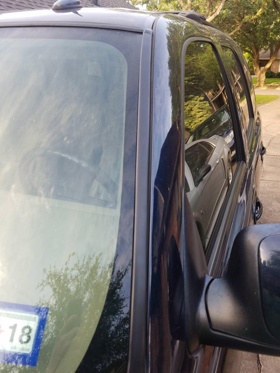

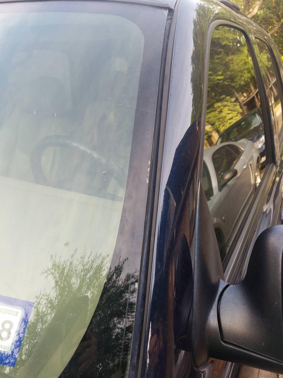

i have located the part numbers for this incase anyone else needs them.
pass side 15291274 drivers side 15291275
now im hunting for what fastens them to the vehicle itself. realized that my weatherstripping is supposed to clip into this piece as well which explains the small leak i have on the passenger side. seems to be a coarse thread screw/bolt but havent found it yet.
