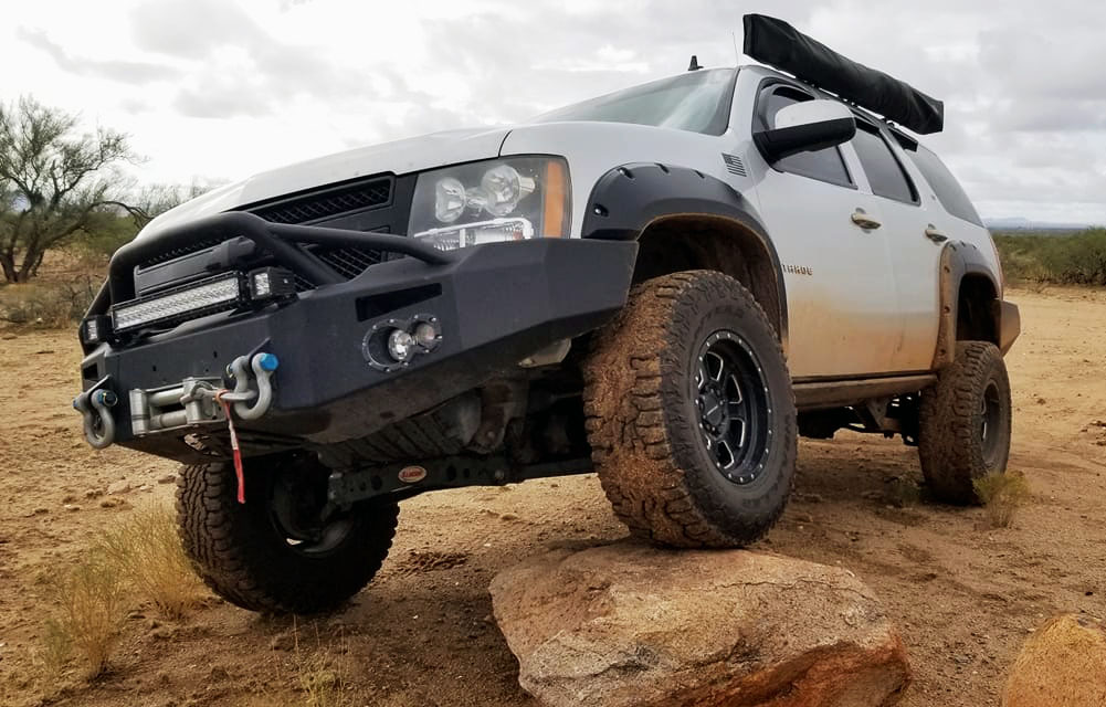

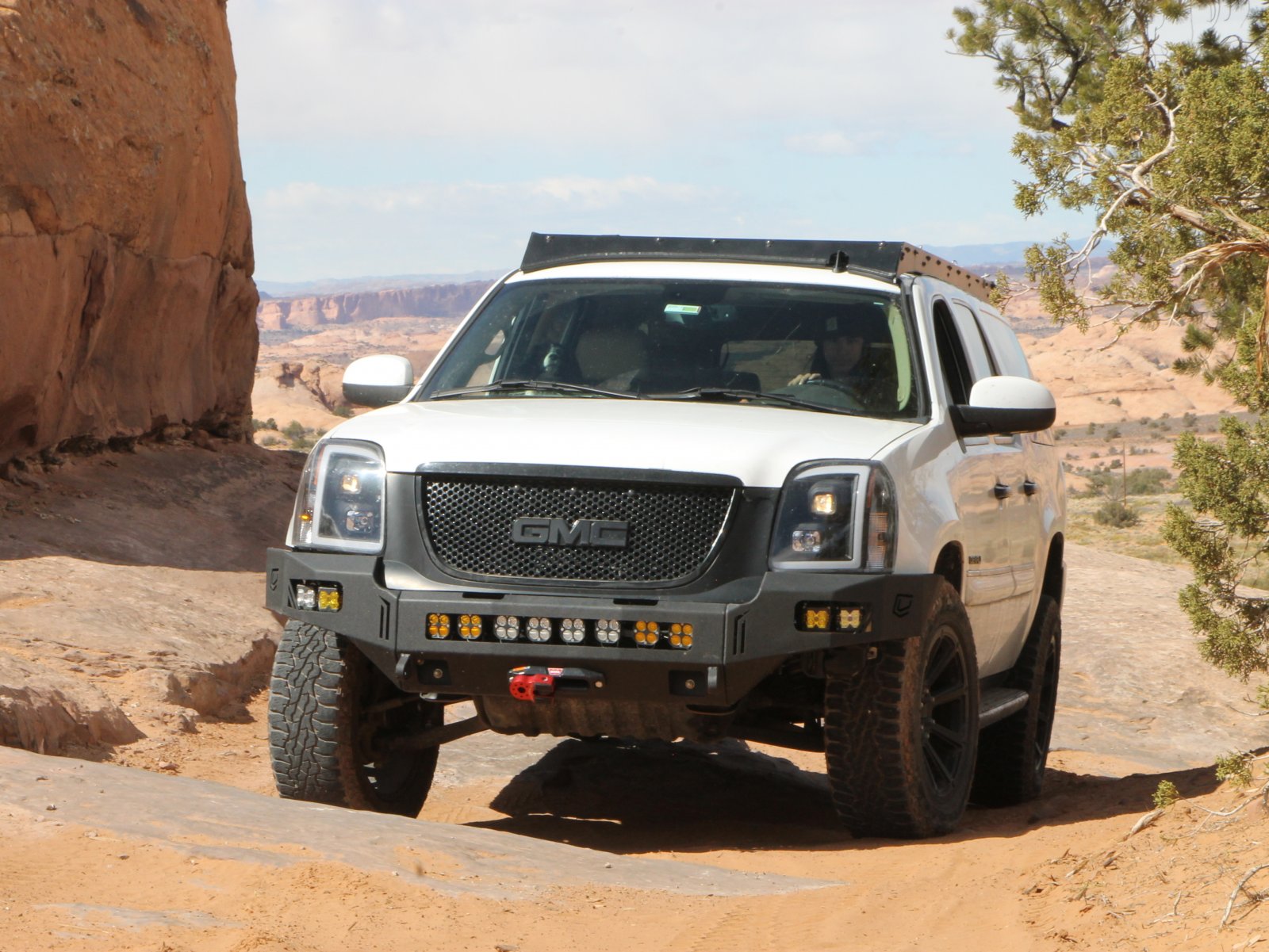

Yea most bumpers on these are pretty expensive this one is not available anymore. The cheapest you might find will be at least $1500. If you have a good fabrication shop in town you might find a cheaper alternative.
