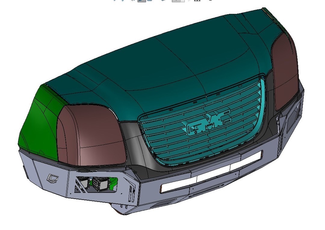

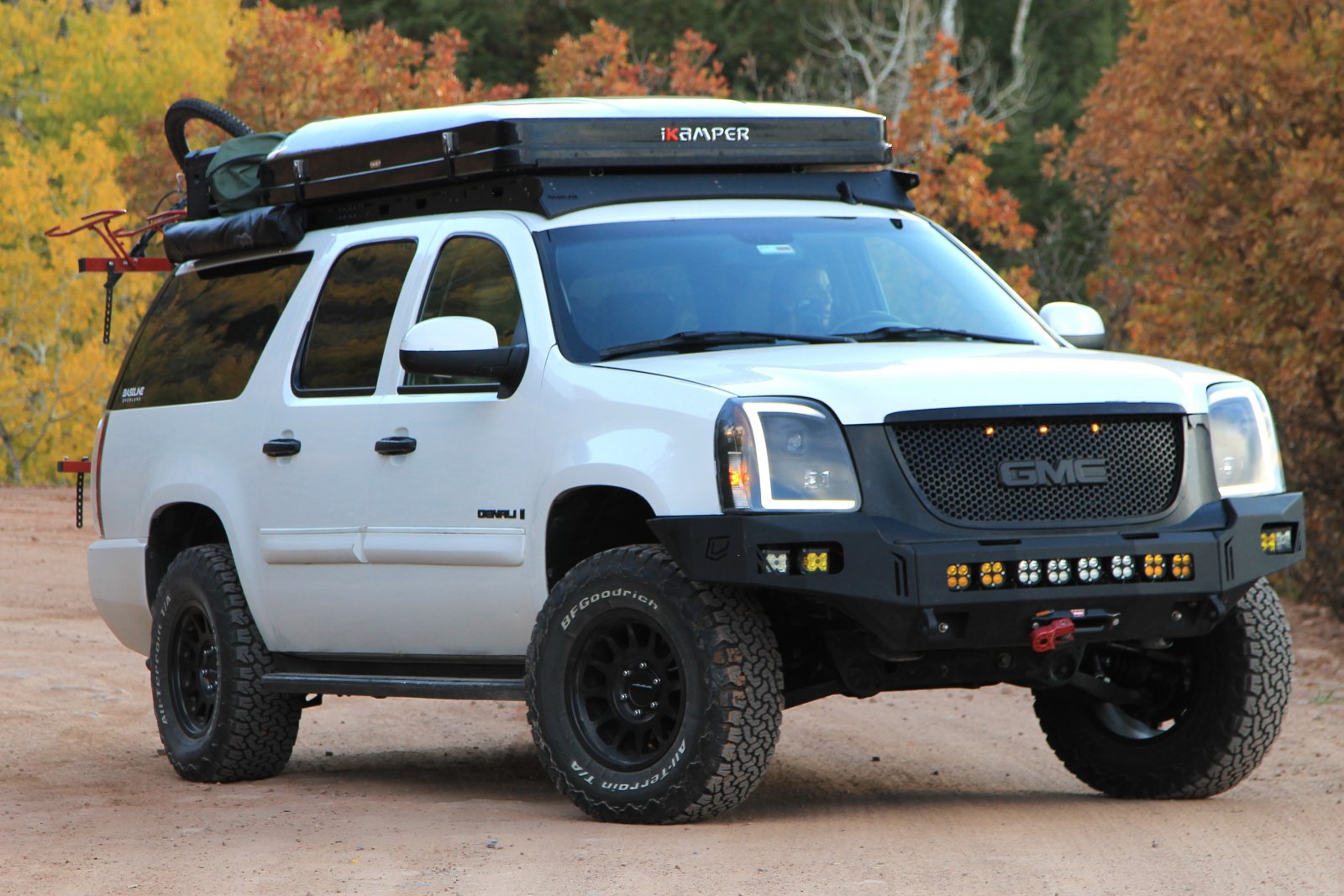

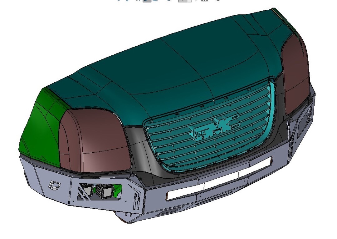

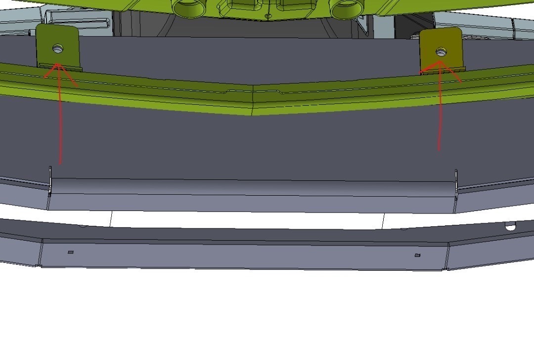

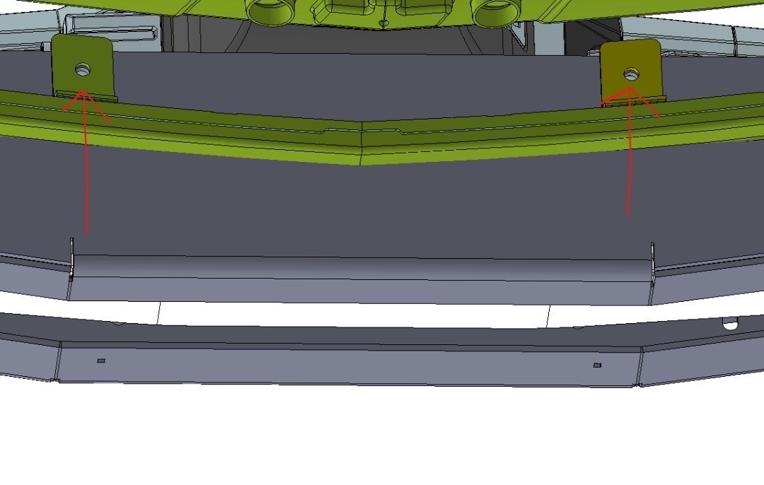

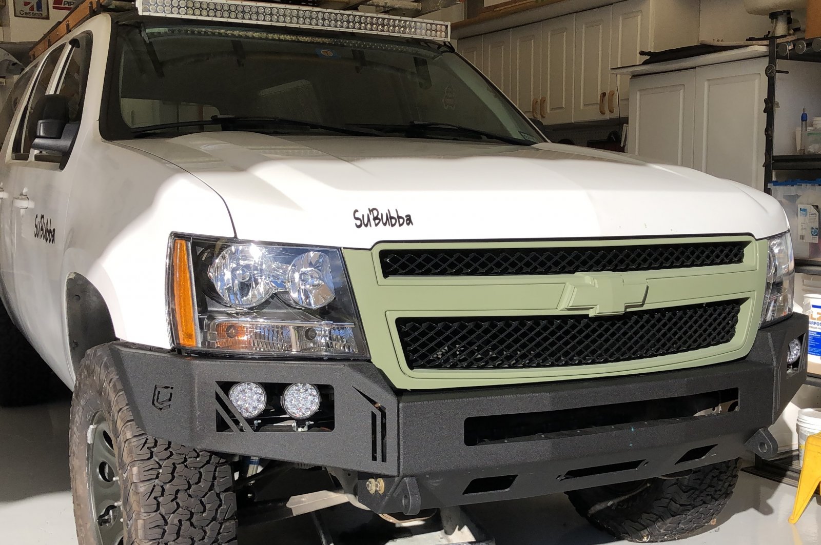

These bumpers are finally in production and available at baselineoverland.com
Bumper has two holes on the top to line up with the factory tabs behind the grill to support it. Hoping to get some better pictures soon. There is a minor difference in the Yukon, but now they are basically the exact same bumper for the Chevy and GMC.
