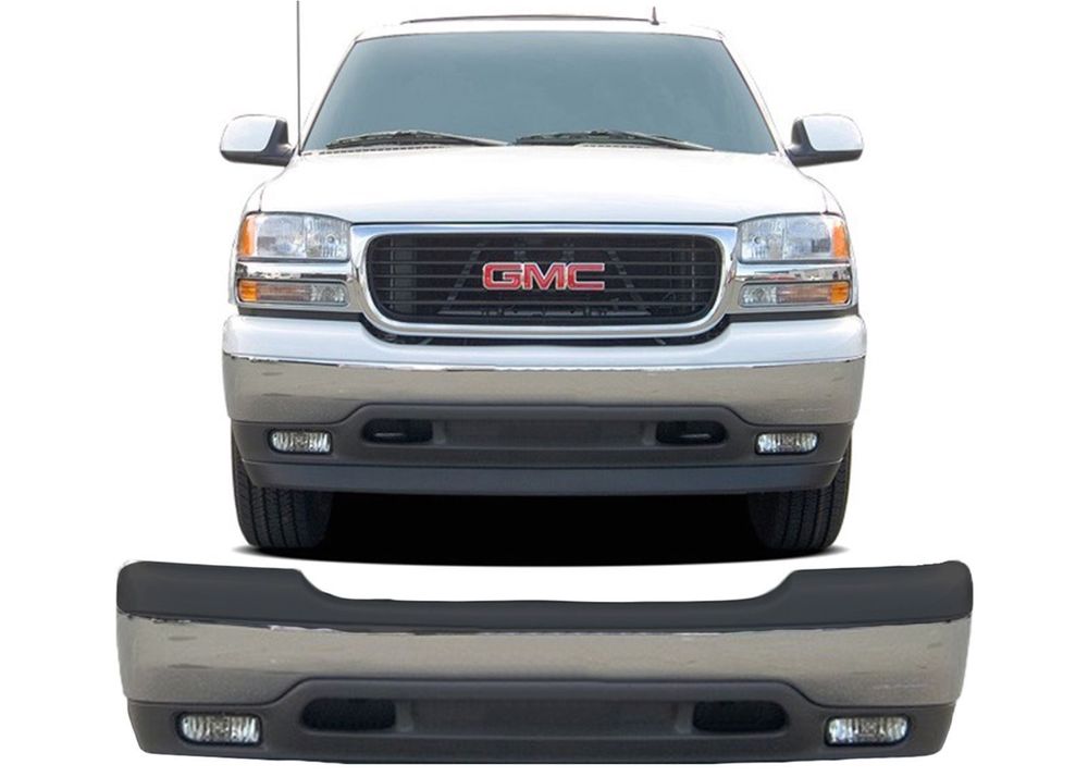

I want to change the bumper.on my Yukon. I'm trying to find out if all I need to do is change the bumper and grille to make this work. I currently have the rectangle fog light bumper.

You need the bumper, grille, bumper mounts. You also have to cut off your frame horns and bolt on 03+ Silverado ones.

I believe 2500 bumper and 1500 are exactly the same. The 2500 just has a black filler piece between tje bumper and grille because gm didnt want to add a higher bumper pad like they did with the silverado.
I think the frame horns are different.
