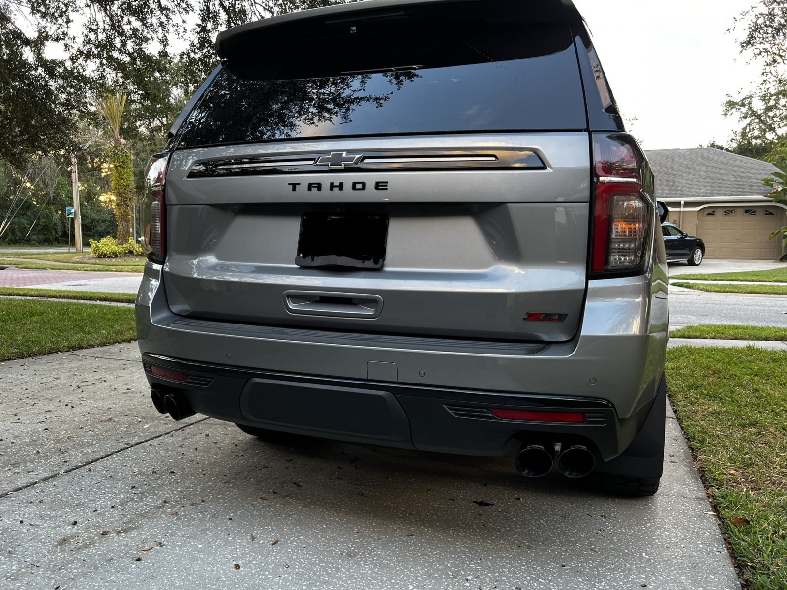

Perfect timing - I have a 23 Z71 with the 5.3L and just had the Corsa 21127BLK put on today! Yes - all bolt on & if you have single exit exhaust like I did - there is a full list of Chevy parts you can buy to make it a tru dual exit… about $400 worth of extra parts - mainly because of the rear lower fascia but well worth it and it all bolted right on!! Loving it by the way it freaking sounds terrific. Best pic I got - it was getting dark out.

Perfect timing - I have a 23 Z71 with the 5.3L and just had the Corsa 21127BLK put on today! Yes - all bolt on & if you have single exit exhaust like I did - there is a full list of Chevy parts you can buy to make it a tru dual exit… about $400 worth of extra parts - mainly because of the rear lower fascia but well worth it and it all bolted right on!! Loving it by the way it freaking sounds terrific. Best pic I got - it was getting dark out. View attachment 383912
That looks killer man, Thanks for the info.

No drone / it is nice and calm at low RPM’s and while cruising - but starts to roar when you get on the throttle. My favorite Tahoe exhaust so far - I have a 2016 with a Gibson set up - and had a 2012 with a Magnaflow kit… Corsa is the best all around in my opinion.

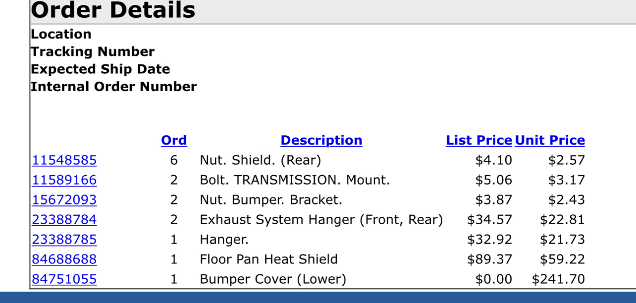

Do you have the single to dual parts list? I ordered everything listed on Corsa's website, but it has exhaust hangars and nuts, but only 1 extra bolt. It looks like their list doesn't include the bolts required to mount the new hangars...

Here is exactly what I ordered - I did order a couple extra bolts - just in case and I did have extra ones when I finished…

Here is exactly what I ordered - I did order a couple extra bolts - just in case and I did have extra ones when I finished… View attachment 396107
Thanks! The transmission mounting bolt on Corsas website only says 1, when I laid everything out in my floor I was thinking I was one short! Those bolts mount the exhaust hangars to the body right? I couldn’t find any directions or videos for single to dual instructions

Sorry - I don’t recall - a buddy did mine with me and he did that part - we definitely used a couple of existing hangers and bolts - my suggestion would be to lay it out under the truck before you take the stock single exhaust out… hopefully you have access to a lift. It’s pretty straightforward - I’m still loving mine - 6 months later!
