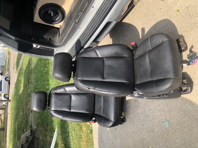

I went and got them. Not sure why the picture is sideways. But I paid $360... I watched a YouTube video on how to power them up if the harness doesn’t fit. Just two wires. I’m hoping if needed I can do what’s in this video. But these seats are going to be for a Bass truck I’m building.

The power and ground will likely let the power adjustment functions work but nothing else will work. You will also need to connect the seatbelt switch and the seat position sensor or the seat belt and airbag lights will be on. I'm not 100% sure it would be possible to make all of the functions work because of module programming differences but if it were possible it would take quite a bit of wiring. Your PPV seats have a 6 way connector and the Escalade seats have a 30 way connector.
