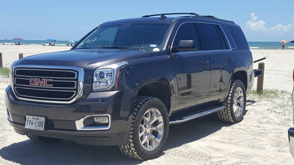

This is the look I'm going for with my Yukon, this one imo looks badass

wonder how much lift i will need for any of the three tires sizes you gave me? Anyone tried running bigger aggressive tires on your yukon or tahoe with stock 22 inch wheels? i like the last pic but just want to keep my 22 inch stock wheels looks like those are 20 inches

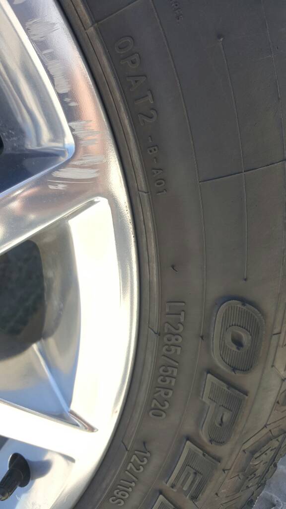

You can run 285/55r20 on stock run with a 2 inch level without rubbing. Im running 285/55r20 on a 20x9 rim with a rough country 2 inch level. Had to trim a little to keep it from rubbing.

Does a 2" make it completely level or is a 2.5" better? I'd prefer 295/55/20s if they will fit, but if 285/55s are better I'll roll with those

2" levels the front with the back. You'd have to use a 1" coil spring spacer in rear with 2.5" level up front. Depending on what tire brand you go with there isn't a big difference between a 285/55 and 295/55. Not sure how a 295/55 will work with stock rims. With that said if you go with a 295/55 and aftermarket rim go 2.5" in front and 1" in rear. I have a 15 Sierra with 295/55 Toyo MT and my 16 Tahoe has 285/55 Toyo RT. The tires side by side you can not tell a difference at all.
