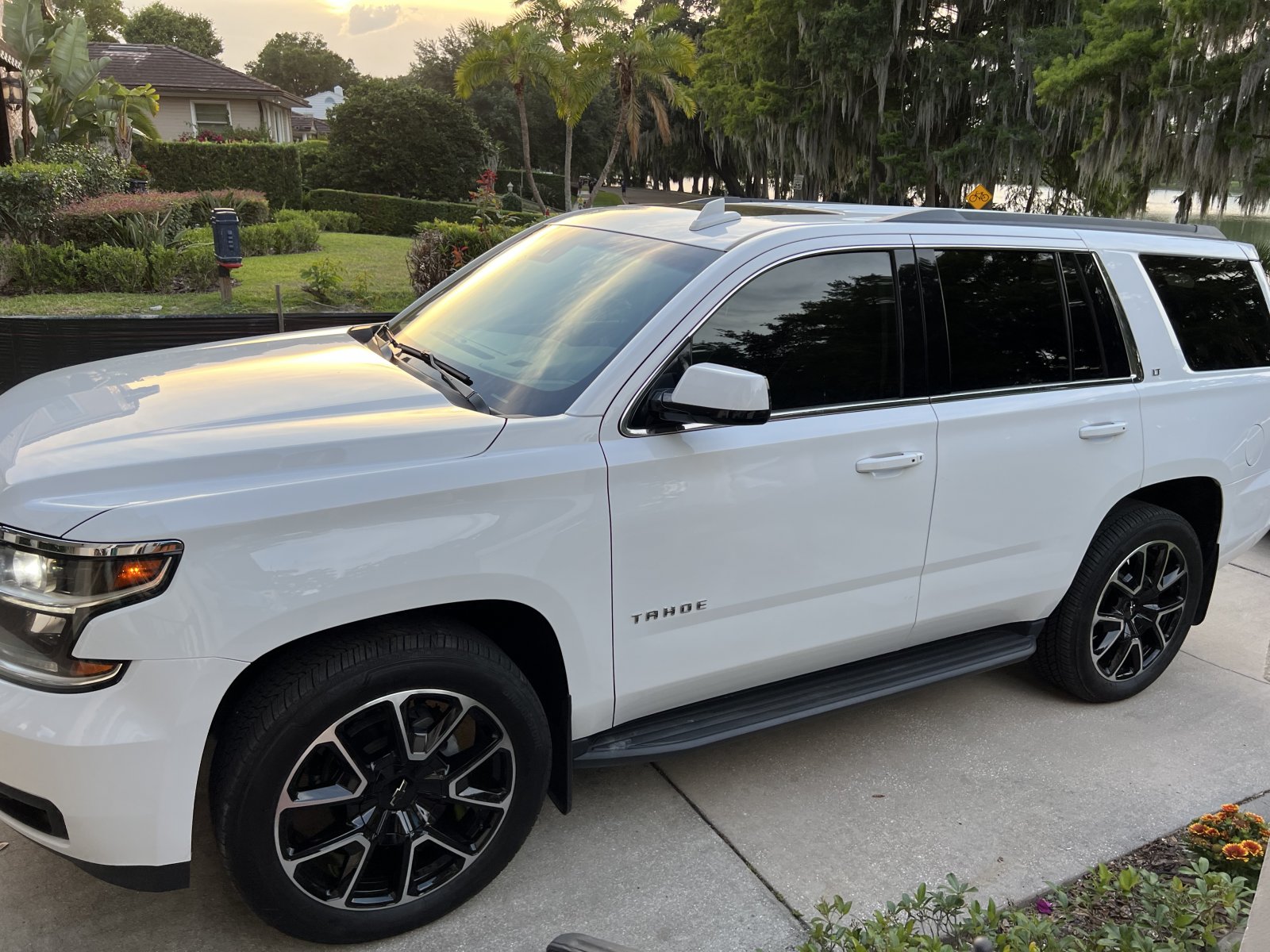

Well, I went ahead and gave it a try.
2022 RST 22s with the 275/50r/22 tires. Fitment was great. Slight rub on my right front aftermarket mud flap which I easily trimmed to eliminate rub completely.
As mentioned in other threads, the TPMS sensors in the 2021+ do not work in 2020 and earlier vehicles. Swapped those out with a factory set. All good to go.

This looks pretty good. Somewhat surprised you didn't experience more rubbing with the 275/50/R22 tires; That's 32.8" tall tire.
Are you all stock ride height?
S
sspearsau
Mar 12, 2020
43
25
With the mud flaps off, there is no rubbing at all. After a slight trim of the mud flap that had an unnecessary edge on it, those are back on with no rubbing at all.
Stock height all the way around. Rides great. Love the larger tires to fill out the wheel well.
