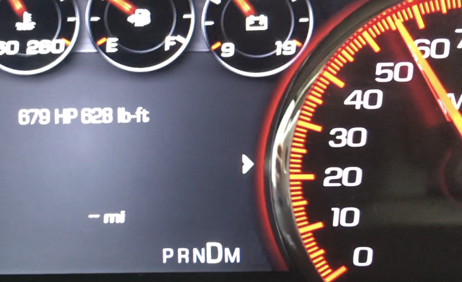

I'm still babying it but the added power feels great so far!

If that's RWHP and your truck weighs about 6,300lbs, that'll get you right about 112mph through the traps in the 1/4 mile. With a perfect launch that'd be a 12.0 - 12.10 time wise.
Thanks! Even more interesting...
I don’t know what it’s reading though, I assumed flywheel? NORCAL SS is running low 12’s with his similar setup. A track visit for me will follow soon after the Texas weather cools off though, which will likely be after a pulley change and dyno tune if everything works out.

DashLogic is pretty close & its also crank estimated HP
(it estimates a little on high side from my dyno runs)
it can also do the following... 2 @ a time on each page:
60' time, 0-60, 1/8 mi time, 1/4 mi time, lateral G, boost
its has lots-O-options
