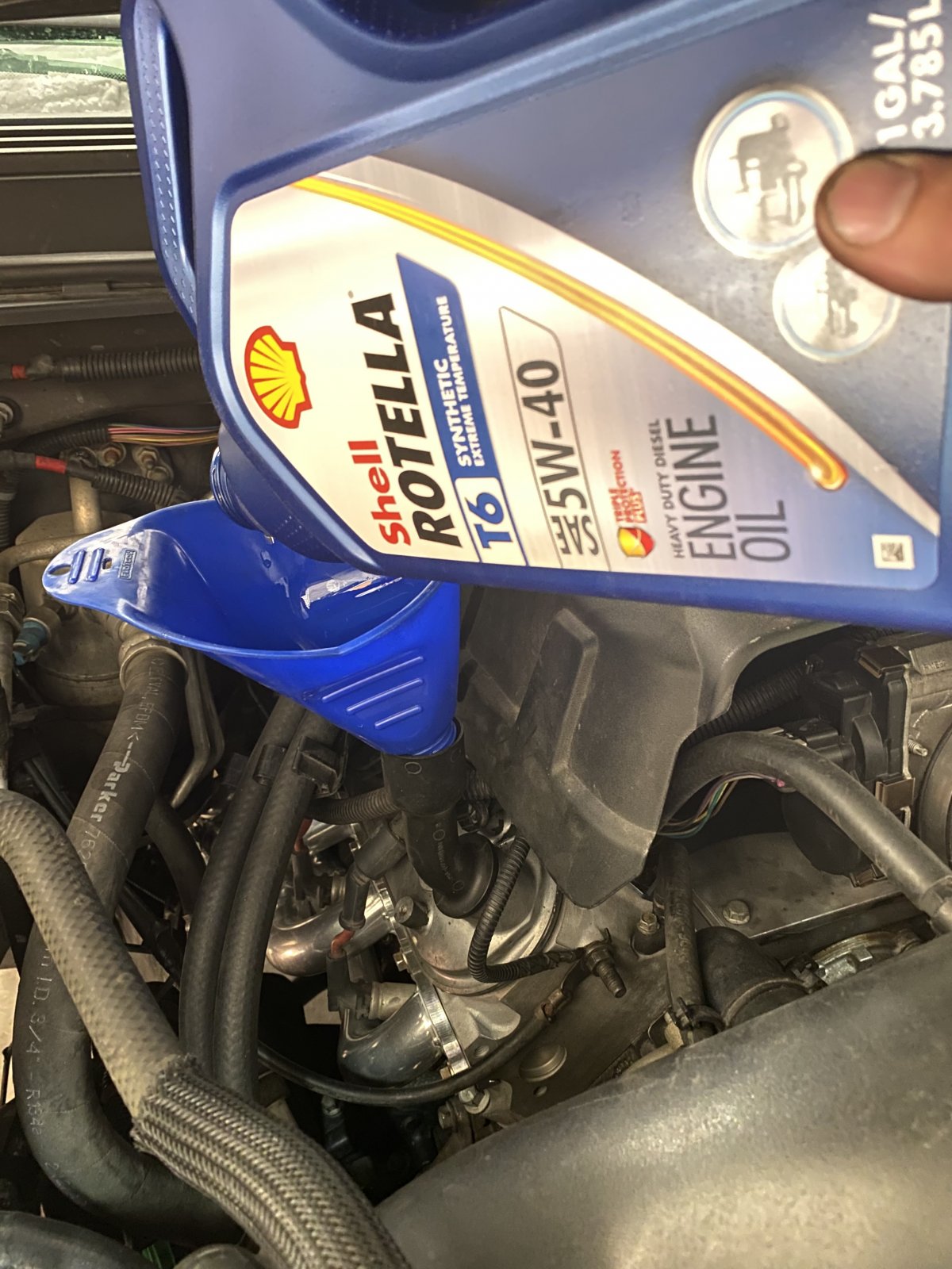

I got this Tahoe ab 3 months ago. The guy I got it from had done a lot of work to it. He was already running T4 in the engine. I don’t really know too much ab it. Would T5 or T6 be any better for it?
45,016
You don't HAVE to continue running diesel engine oil. You can run anything you want. It is said that the high zinc content in diesel engine oils, while great for engines in general, eventually kills the catalytic converters that gasoline engines have. Some say that's not true, others say it's true but will take a really long time. I ran gasoline engine full synthetic oil (Pennzoil Platinum) until recently when I removed the cats. I switched to Rotella in the T6 flavor cuz I'll only run full synthetic. There is now a Rotella formulated for gasoline engines that appears to be an excellent oil. Since you asked specifically about Rotella, I'd say the one that's best for your '07 is the new one for gasoline engines. If some of that work that the previous owner did was removing the cats, then you can still run that gas engine Rotella or the continue with the diesel engine Rotella, again, in full synthetic.

The T4 is probably why he had to do a lot of work to the engine. We see on the pages of these forums lots of AFM problems caused by folks running the wrong oil in their motors. Stick with Dexos approved oils such as Rotella Gas Truck if your engine still has AFM whether active or not. If it's been deleted or you're running a 4.8, to each his own.
