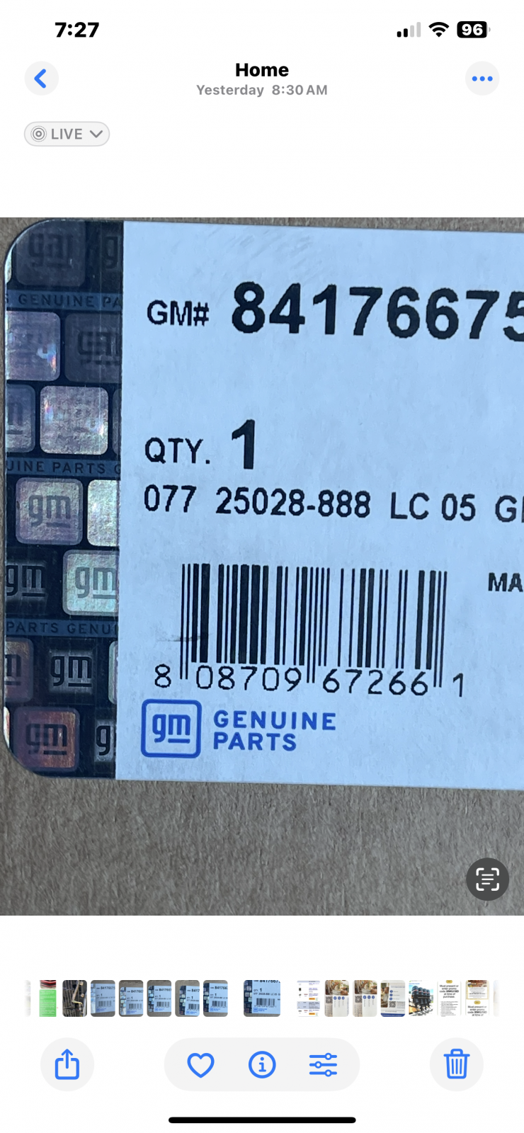

I know this is an older thread, but the ebay magneride you listed are 100% counterfeits. ACDelco does not sell loaded spring/shocks for this denali. I hope you got this from a reputable retailer.
Try Newparts.com I just got a pair of rear z95 at good price GM label made in mexico
Ordered Monday/ arrived Thursday
