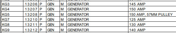

Here are some of the generator codes and their associated amp ratings:
I'm not sure about upsizing and compatibility. Worst case you'd need to compare connectors and how everything is clocked.
KW1 is the RPO code for the 160A alternator. My 2013 has this code
