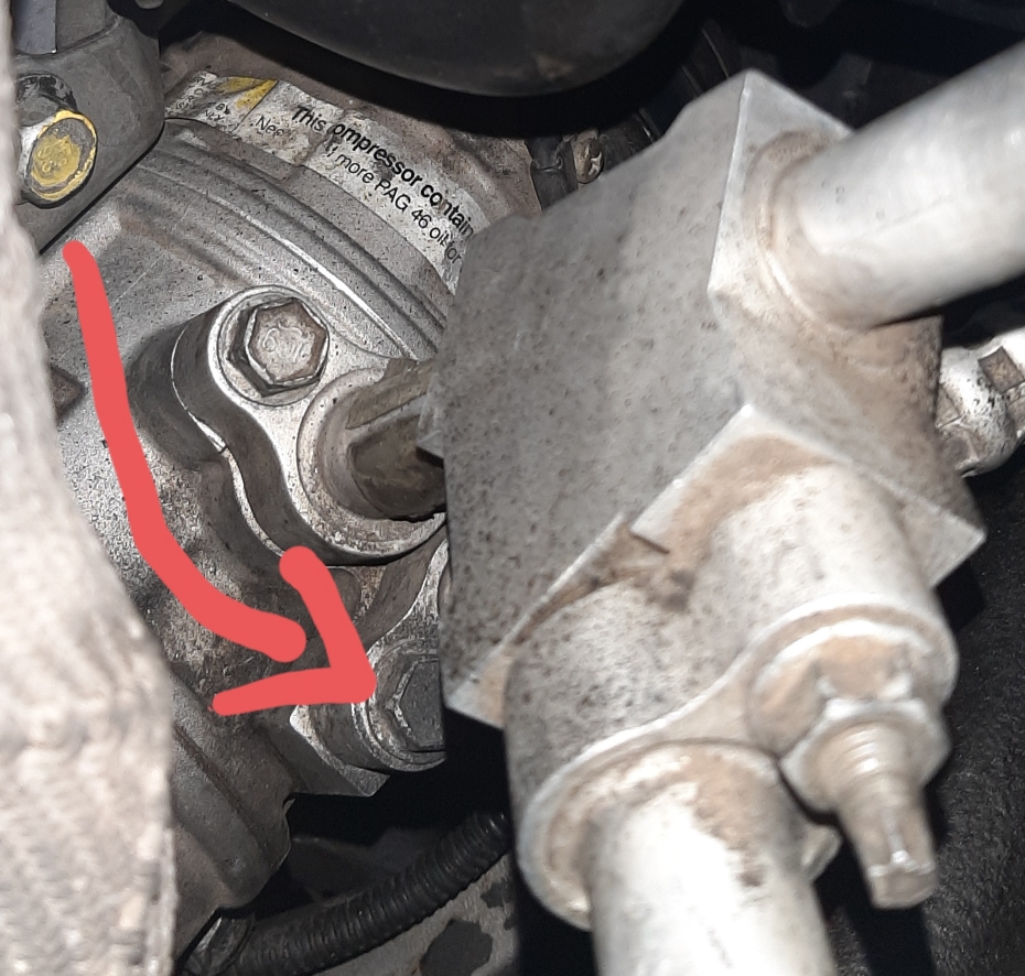

There's a line leaving the compressor, it goes directly to bottom of condenser unit. It's leaking on my truck and I need to replace it but I cannot figure out what hose that is called? It's a 2001 Z71 Tahoe

It is bottom connection on compressor closest frame. It runs up towards the condenser unit. Not sure if is top or bottom connection.
I have rear air. The splitter connection above goes to fron evap and rear evap.

I keep lookong there... hrm. I hate to go to effort to take it apart. before i get the part.

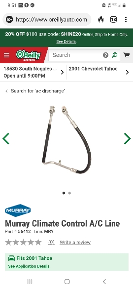

I installed the line, it was the discharge / suction line. New one is great, no problems with it. However, I thought dang I should probably replace the oriphice tube while I am in there.
I charged the AC with two cans of refrigerant and the low side runs too high. I get 70 PSI on low side. What could cause this? Could it be a bad oriphice tube?
I should be getting 55 PSI on low side.
