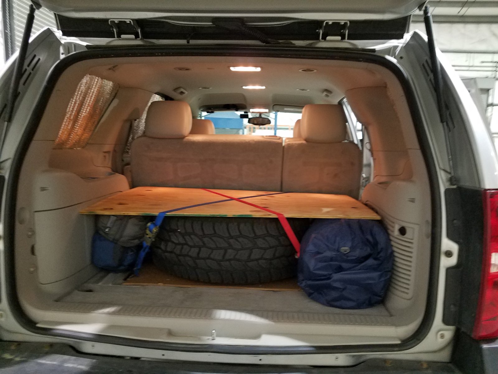

I am still working on building a swing out tire rack and hope to get it done after Christmas but... In the mean time I am taking a long trip and I need a spare tire... So what to do with that big 35 inch tire and where do you put a big jack to lift it up... Here is my solution.
I am sure some of you have seen my post on a rear Installing a bed / storage platform.. Well here is a quick solution kind of like that only this is for stashing a spare tire on the cheap... All total about $20.00
Just put it on the floor, cover it with a piece of plywood and strap it down. You will still have room around it to store extra gear. For winter driving I have a double wide zero degree sleeping bag just in case you get stuck out in the middle of nowhere you can see it on the right side of the tire.. On the left side is an electric air pump, some personal snow gear and a set of snow chains to fit my big tires. There is still plenty of room for suitcases shopping bags and other stuff on top.. Not to mention I still have a foot of space between this and the rear door, plus I can still use the small storage compartment on the left side.

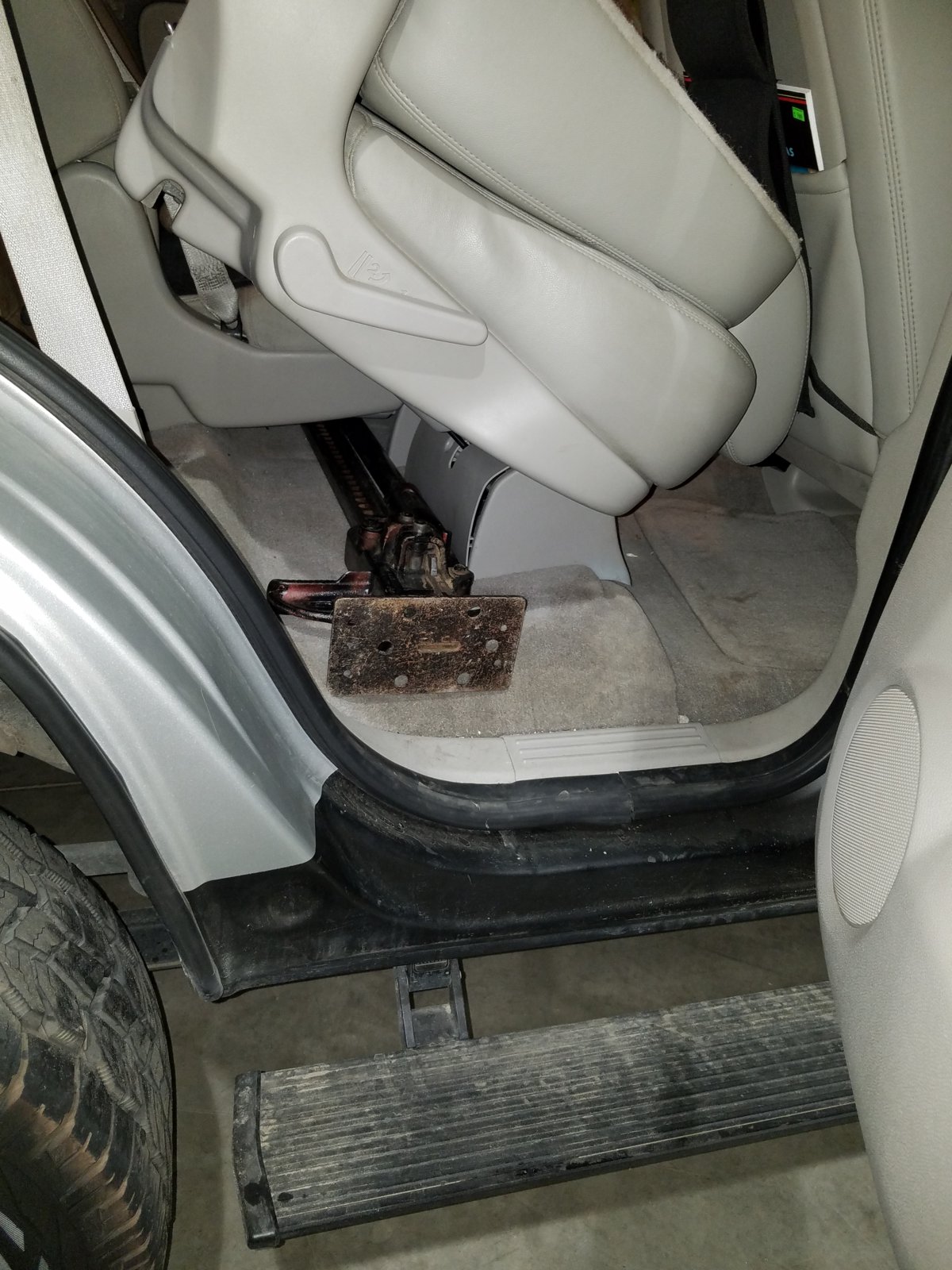

The Hi-lift jack... I opted for the 48 inch jack for highway and in city travel but, for more serious off road I like the 60 inch jack the 60 will mount on my roof rack... The 48 in jack will actually fit under the rear seat and not rattle or fly around in sudden turns or heavy braking... I also removed the stock jack, rear tire hoist and all the stuff no longer needed due to my lift and larger tires I also added a long 1/2 breaker bar and socket to remove the lug nuts easier... I got a small tool bag that fits in the left side jack compartment and also keep a set of jumper cables, spare lights, a tire patch kit and other things I don't want flying around in the storage place too.

Where do you hook the high lift?
Will your spare fit under your bed platform?

Yes, I will be building a swing out carrier in Jan. but I have Fab Four steel bumpers front and rear. My 48 inch high lift is under the rear seat right now and is held in place by the seat. I will be putting a 60 inch on the rear swing out carrier when I build it.
Unfortunately the spare wont fit under the shelf because it is to wide of a tire.

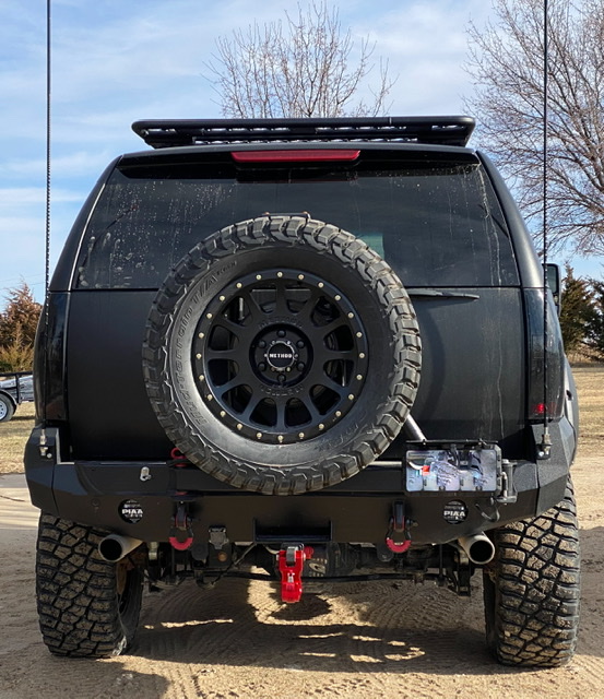

I am running 35X12.5 BFGs and originally went with the Wilco Max hitch mount solution. Decided to go heavy duty for strength and security, so I went with an Iron Bull rear bumper and cut bumper and welded in the Wilco Hitchgate Max. Modified the Wilco to mount wheel with standard wheel studs as well.
