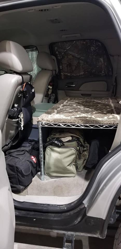

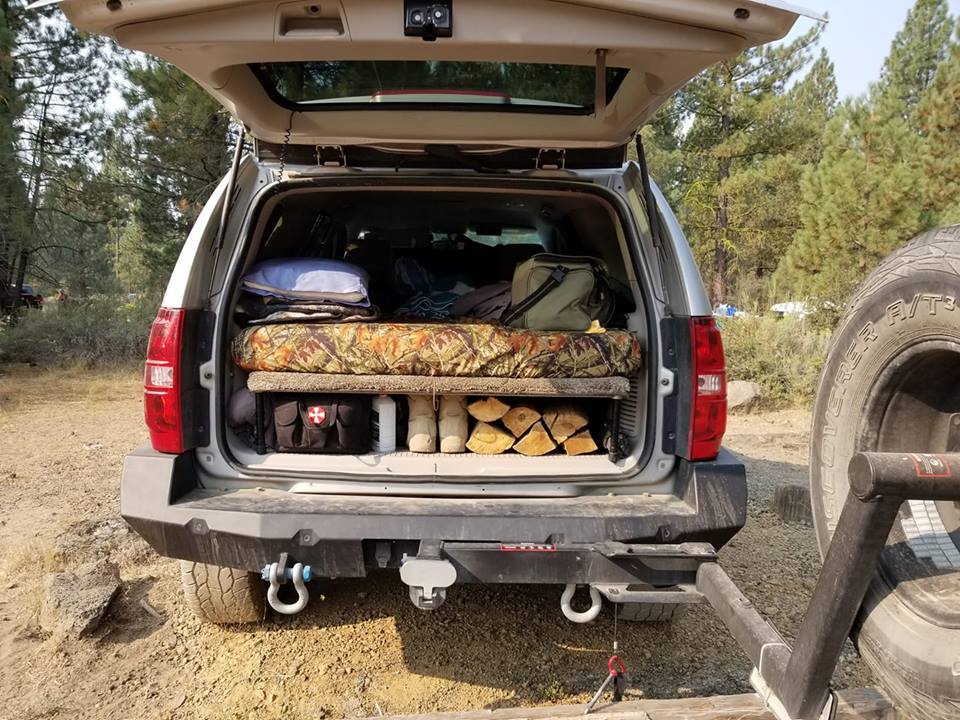

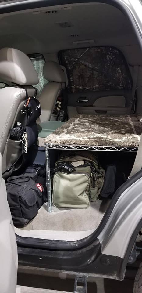

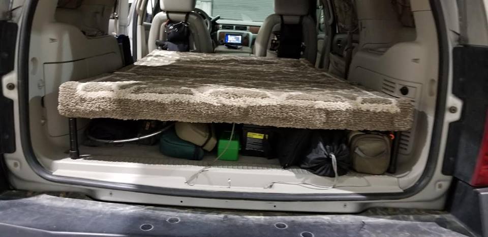

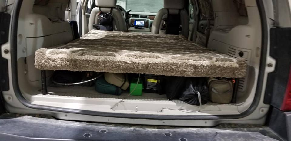

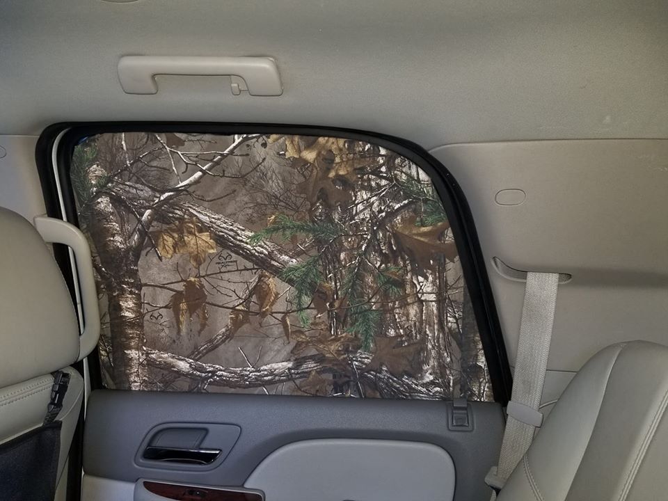

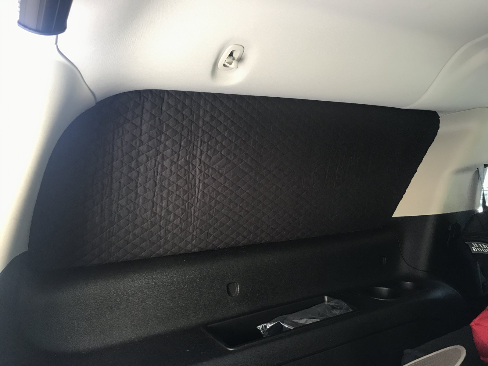

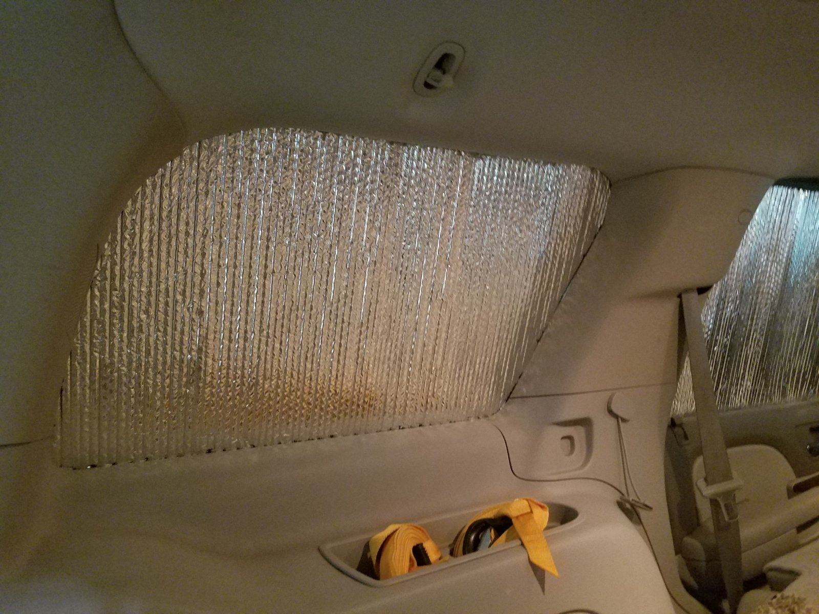

My wife and I sometime like taking a spur of the moment camping trip I just toss in some things and go... I also like to be able to hide things out of view in everyday use and reduce the inside temperature during the day and keeping it warmer at night... These modifications will make camping a lot easier and camp set up almost instant.

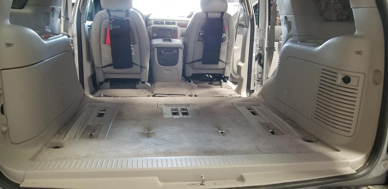

I have a rear bench seat I am not sure how well this will work with the rear bucket seats if you have them you may need to be more creative...

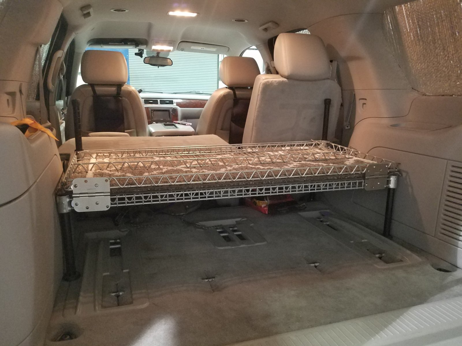

Parts list.
1 Metal grate shelf unit 4 feet wide and 24 inches deep and at least 3 feet high.
2 Steel hinges 4 inches wide
8 1/4 inch bolts and locking nuts for the hinges.
1 3/4x 36 inch piece of strap steel.
2 Pieces of carpet 2x4 feet or if you can a 4x4 would be even better.
25 zip ties
1 Roll of Reflectic insulation or bubble insulation.
1 Full size 6 inch foam mattress pad.
You will need a saw / grinder, drill, hammer and maybe a few misc hand tools.

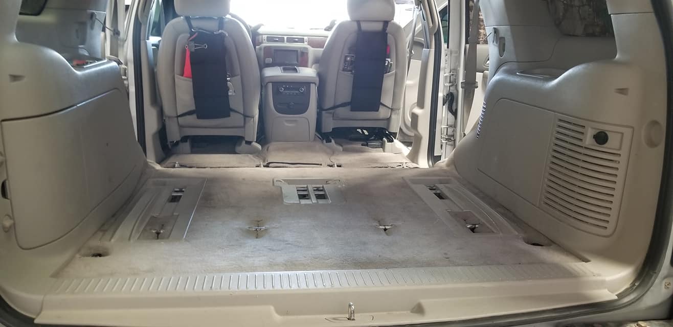

With the third row seats removed and the rear seats folded down you can install the racks to store things under and put a full size bed mattress on top.
