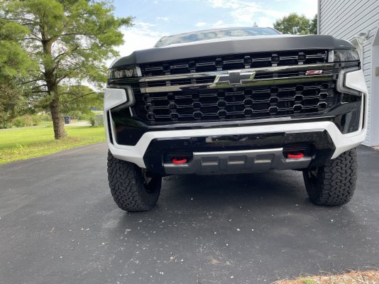

3.5 RC installed …. Tiny trimming/pin back to make 285/65/20s fit. Will post more pics later.

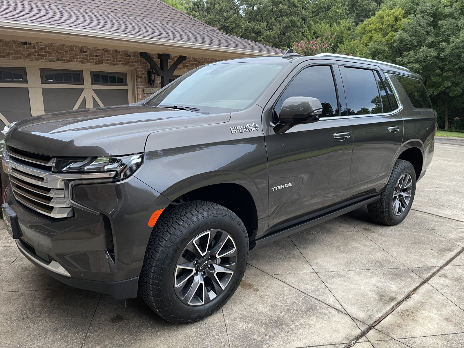

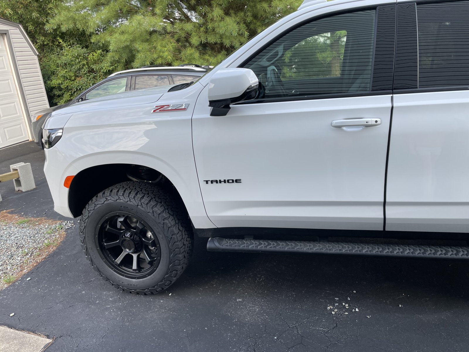

I actually bought my High Country used from the Hurst dealer you guys are talking about. They are owned by the same people as the Lewisville one. Both locations have quite a few lifted trucks. Mine didn’t come with a lift, but I asked the salesman for some references. He said “we are the only ones that know how to do it”. I’m sure that isn’t true but after having my own very talented mechanic install the RC 2” kit, I think the sales dude may not have been 100% full of crap. My mechanic had a ton of issues, mostly sensor related. He resolved all but one - the adaptive ride control system is still throwing a code. I may have to take it back to Hurst for a fix… or at least get them to tell me what needs done. The sensor modules made by aFe say they only work up through MY19.
anyway, I can say that while I’m happy with the extra height, I really hate the “level” look. I have lifted lots of trucks in the past but never once did a level. Trucks have a rake. No rake, truck looks wrong. Load anything more than a tank of fuel in the back and the truck looks like it has worms. I wouldnt have done it this time except that the only non-level option available is spending $3k+ on a full set of Kings. I think I may live with it until Fox or someone makes something more reasonable.
edited to include before and after pics of the 2” RC kit. I also swapped the soccer mom wheels out for a stock z71 set

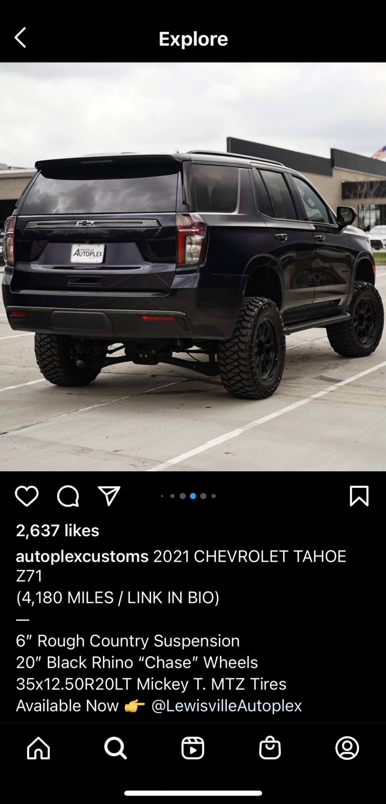

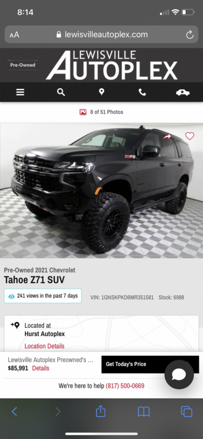

TexasTZ71
Aug 13, 2021
12
So looked at the Lewisville Autoplex and they have lifted Suburbans and Tahoe’s and they all look sweet. Screen capped the dealer notes. Looks like they are using the Rough Country 6” lift with 37’s. Might be using a small custom body lift to fit the 37’s. It looks sweet!

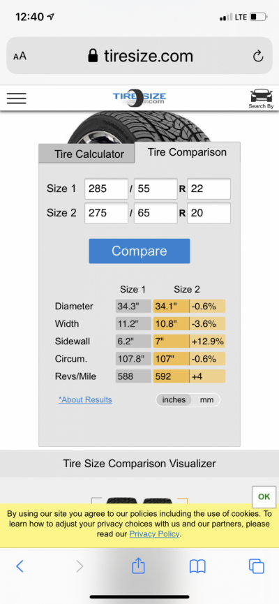

I’m running 285/55/r22 +24 offset with the RC 2” front and rear kit. Very minor trimming required to the front fender well.
Stock offset is +27 on a Z71, right? I'm wondering if I could run 275/65r20s with your kit and the stock rims. If I'm doing the math right, those are about .2 inches shorter and half an inch more narrow than your tires. Unfortunately none of my local shops can give me a straight answer.
DWSmoot
Jul 22, 2017
532
448
Charleston, SC
You should be fine, maybe slight trim if any in front inner fender that you would never notice if they do a good job.
