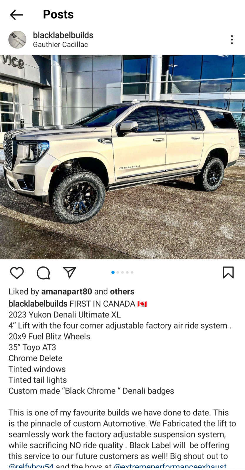

Punteh
Apr 24, 2022
55
46
I've been seeing custom builds with air ride that talk about custom lifts. This one speaks of a fabricated lift. If you zoom in on the front wheel well it looks like it has ready lift control arms. Also I've seen Hurst Autoplex customs selling Denali Ultimates that say they have a custom lift

LuckyHorn
Apr 24, 2023

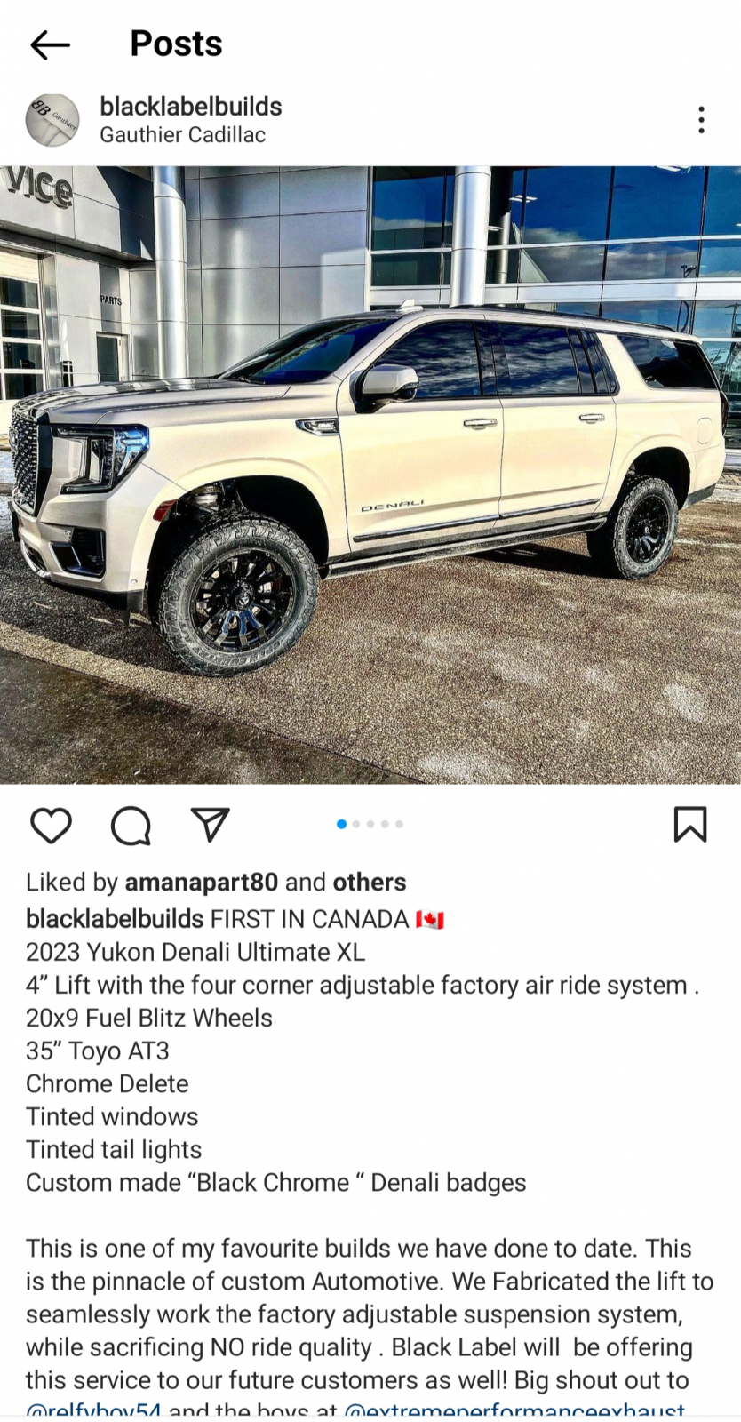

I've been seeing custom builds with air ride that talk about custom lifts. This one speaks of a fabricated lift. If you zoom in on the front wheel well it looks like it has ready lift control arms. Also I've seen Hurst Autoplex customs selling Denali Ultimates that say they have a custom lift View attachment 398426
Yes! I’ve been seeing autoplex posting the same things, which is what originally triggered me looking into it (and not really finding anything)
