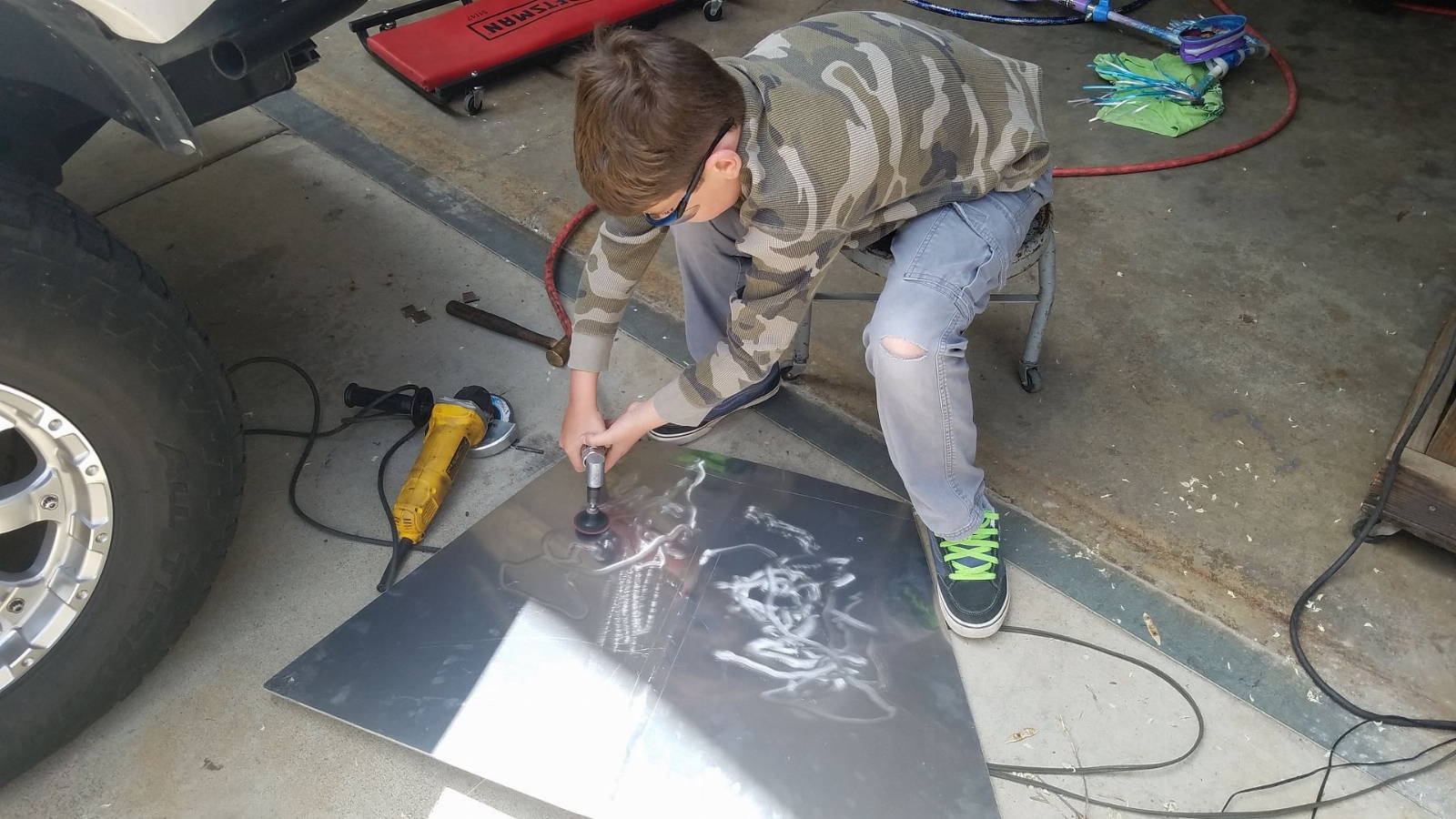

I know it's been forever since I've updated the thread. Life gets in the way. Meanwhile the Wife is driving around with stock front suspension and fiberglass fenders. Luckily, she doesn't care. Anyways, finally got the skid plate cut, bent and mounted.
Summer is coming up and I almost have the Lexus driveable again so the time to take the Denali apart to build the front end is approaching fast.

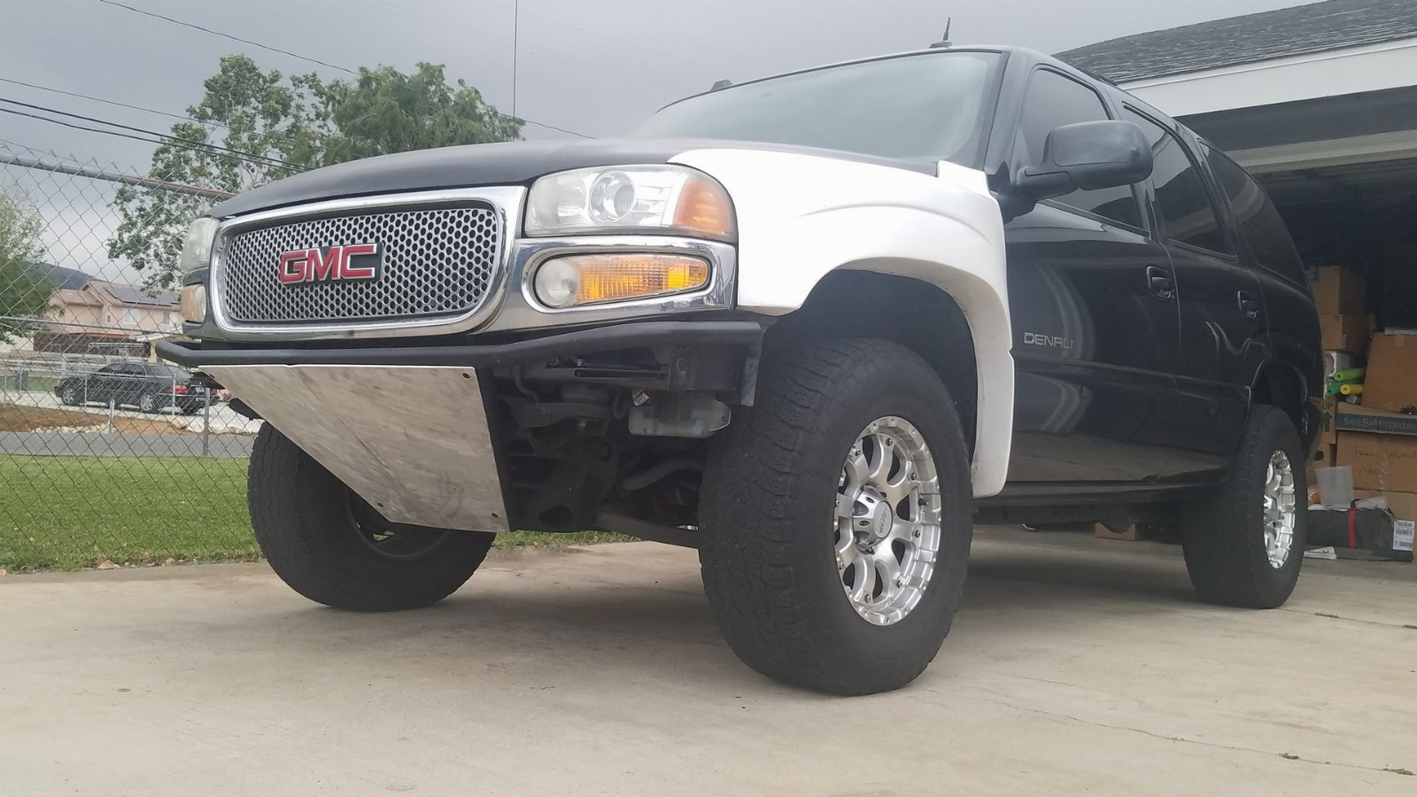

We finally mounted some tires on the KMC Machette single beadlock wheels. The truck fills out the front fenders a lot better with these. 17x9 (I believe 0 offset)
Once again this project just keeps getting put on the back burner. Well, unfortunately, this time it's fate is uncertain. Since I last posted we have broken a driver side axle, broken another driver side hub, and most recently broken a passenger side hub. Each time this **** happens, I basically replace everything up front. This hub that just broke had maybe 1000 miles on it. This time we were lucky it was only at 20 or so mph. It ripped the caliper off the knuckle, broke the spindle and the wheel landed under the truck. The Wife did a great job of keeping her composure and got the truck off the side of the road with the wheel/tire as a crutch.
*Note* the tire wear in roughly 1000 miles
Needless to say, something is clearly not happy with the front end right now. I gave up and just ordered a 4" lift for it hoping to correct CV angles(which is where I believe the problem lies). This was after extensive searching for a 1500 diff drop. Quite honestly, reading the internets for such products is quite interesting. Comment after comment about how the upper ball joints fail and the CV angle is fine after blah blah blah amount miles. Ball joints have never been a problem for me, just these damn axles and hubs. To add to my confusion there are diff drop kits for 2500's all over the place.
I still have the NNBS axles I bought years ago sitting in a box in the garage. Again, with the hopes of making custom arms roughly 2" wider. The 4" lift currently on order is not where I wanted this truck to be but I am backed into a corner. This is my Wife's daily driver and she loves the truck but I can't in good conscious let her drive it this way anymore. With my back up car also not drivable this has left us with one vehicle.

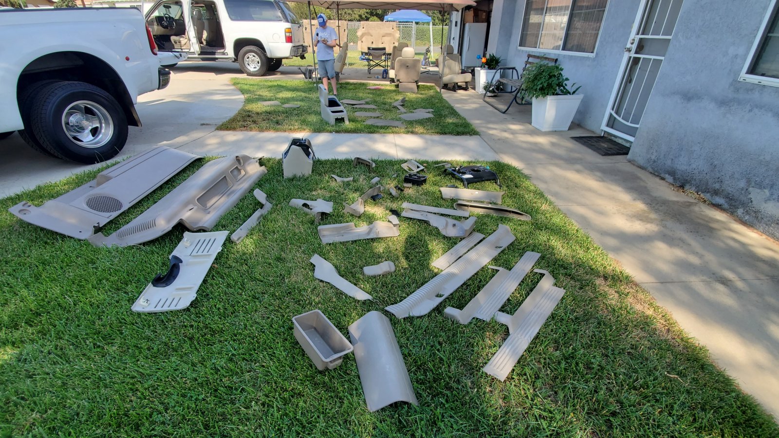

During this time (covid) parts availability has been an issue so the lift kit delivery date just keeps getting pushed back. In the meantime we looked and found an '02 2500 Suburban 6.0 in good mechanical condition, with great paint but the interior was thrashed. So we found a couple donor vehicles and made it super nice inside as well.

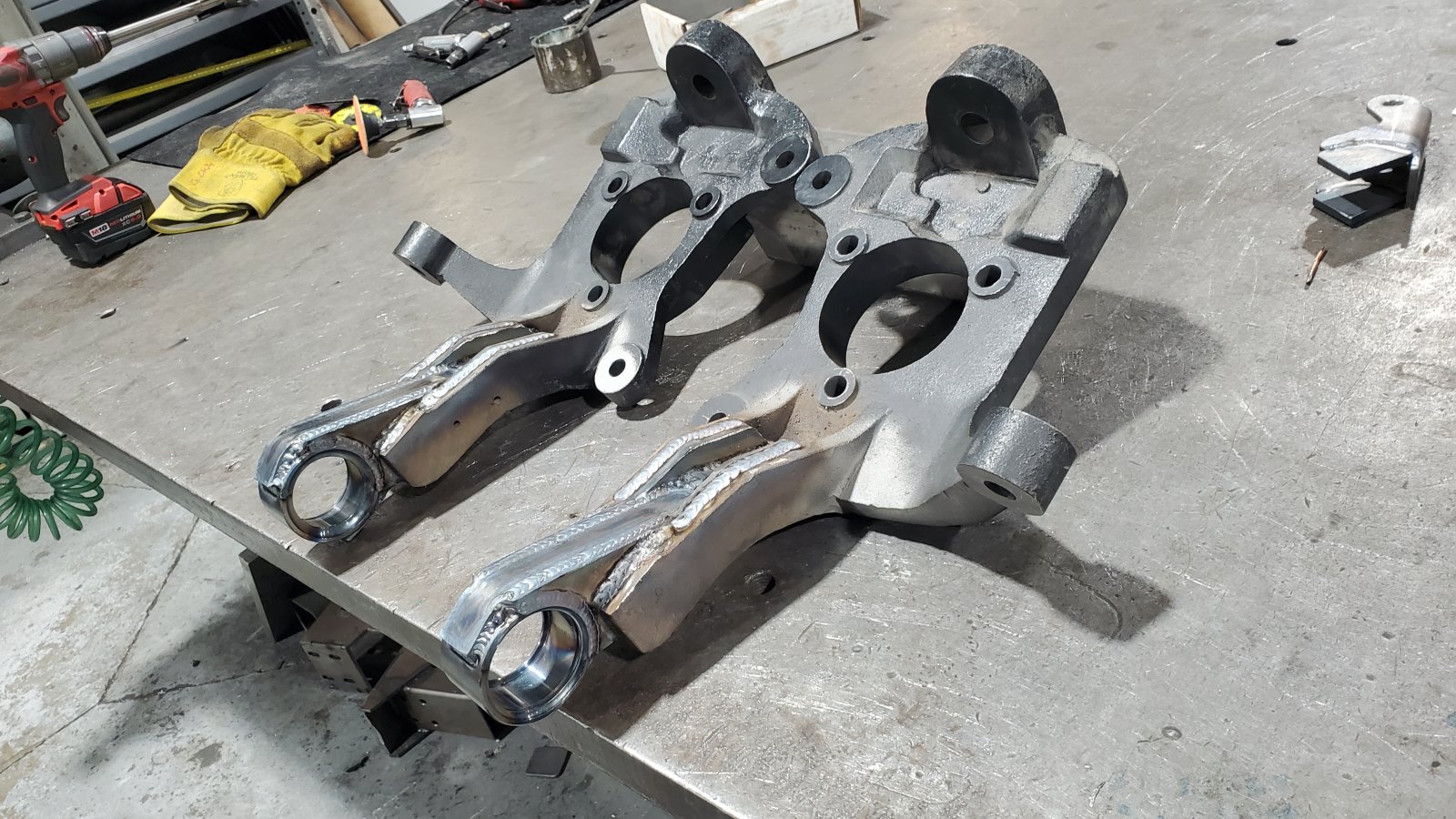

Long story but the Cognito Uniball mounts weren't seating deep enough for my liking. While retapering one of the knuckles I messed up the angle. I contemplated replacing that one knuckle and then just said "eff it" and cut the upper ball joint mount off. Certainly not the best option having to weld cast. I captured as much area as possible, properly heat cycled them and also put a thru bolt to hold it all together(just in case).
