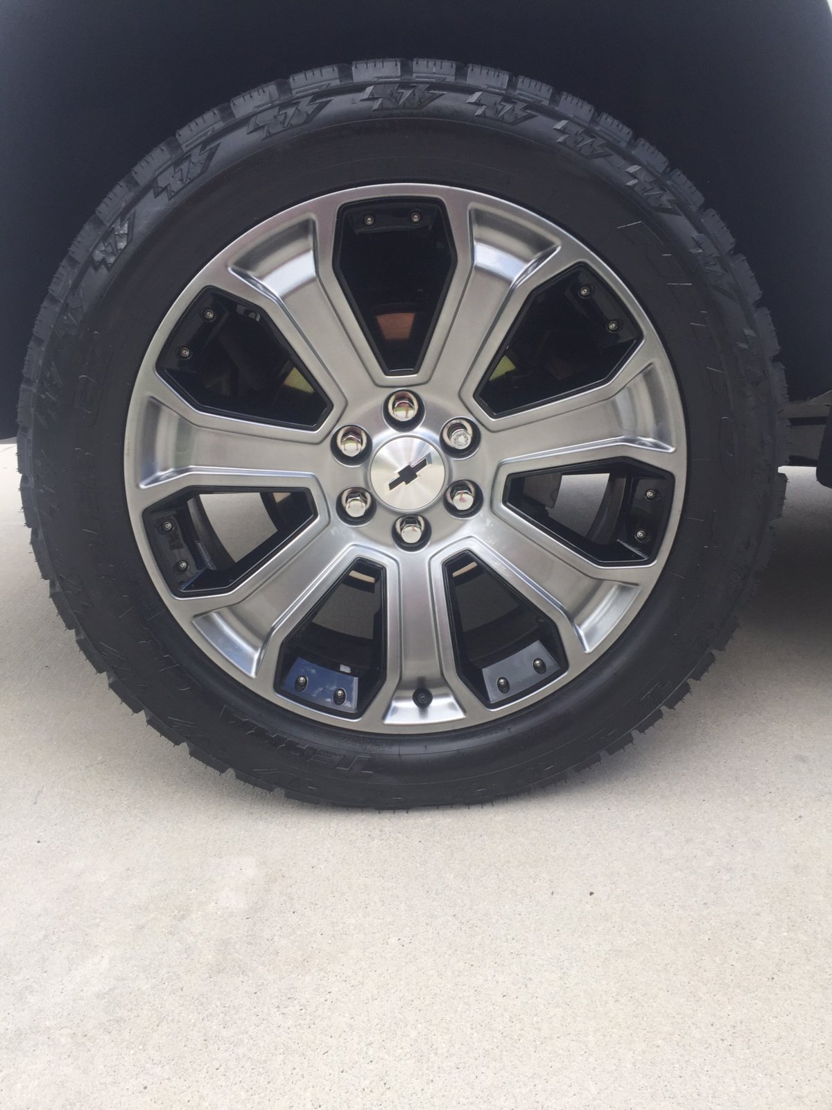

It will push your wheel out about 44mm from where it is now, so depending on the offset of your stock wheels (+31mm?) you're probably close to a -12 offset wheel
I am running a 2" spacer with stock wheels (20x8.5 +31) and 305s just for some comparison:

Thanks BigMac. My wheels are 22x9 24 offset. Your setup looks good. Concerned mine would push out more even with a 1.5 spacer. Do you have any other pics at different angles?

with a 20x9 +24 wheel and 1.75" spacers, yours will stick approx 1/4" further out than mine pictured.
