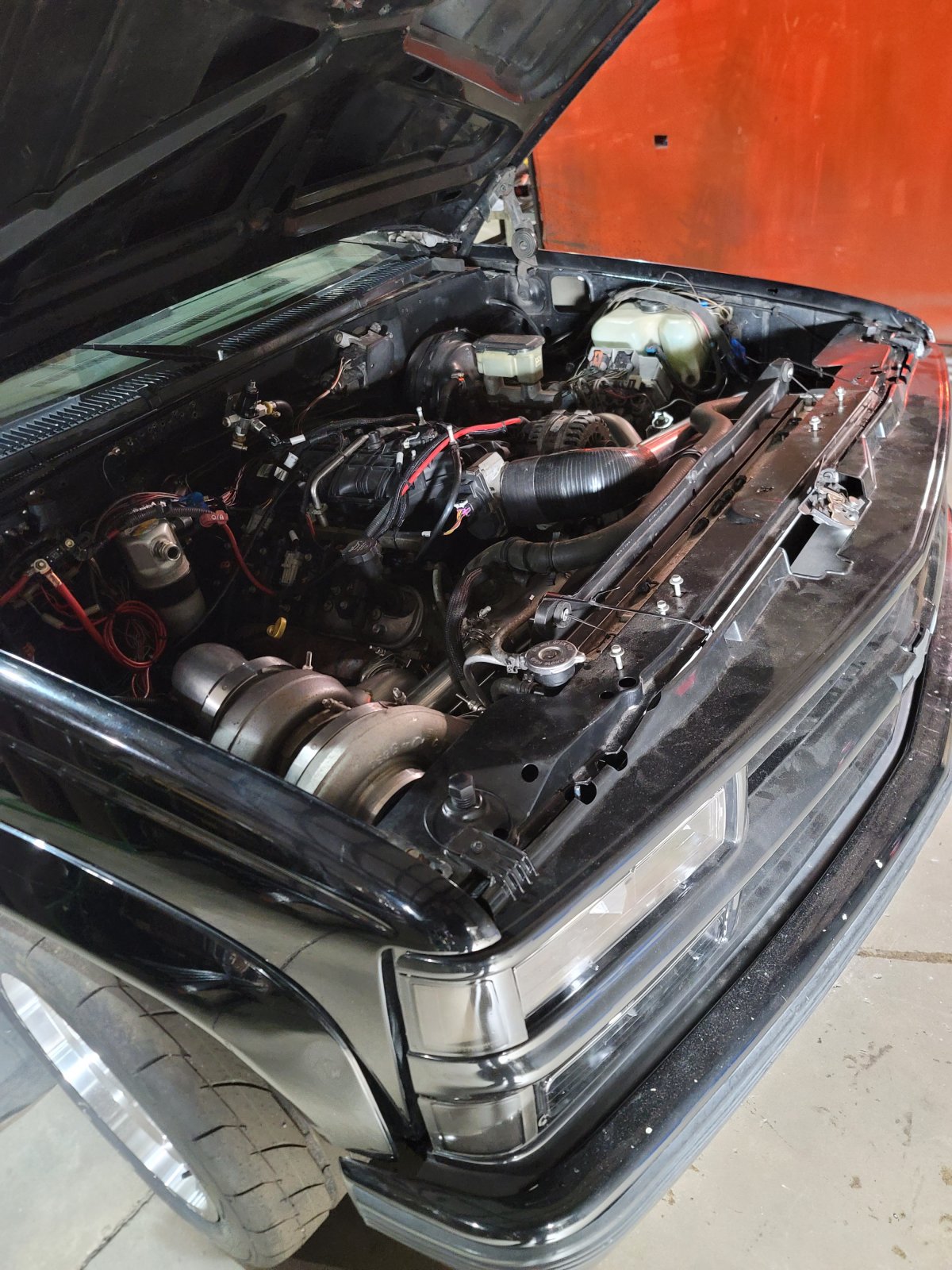

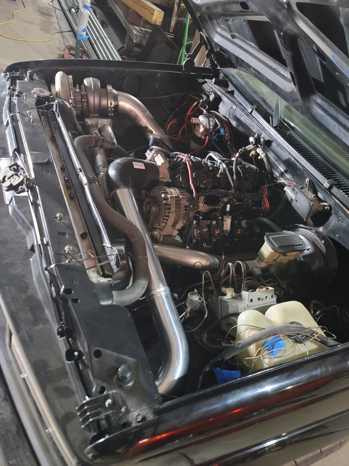

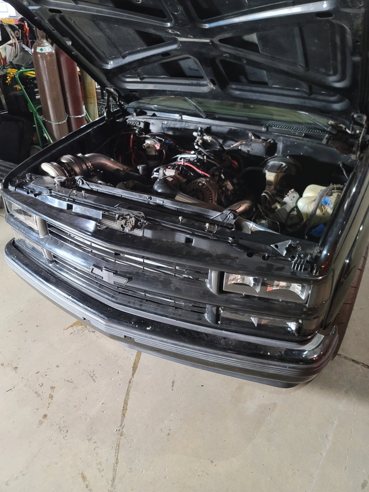

Got the s475/96 looking right at home in the ol girl!
Along with a 4" thick core intercooler tucked in perfectly behind the grill
Any bets on how long that factory ring gap would hold up if I left the 96k mile 5.3?
Going to be installing a holley I/O expansion on the terminator x-max shortly so I can install some accessories.. trans brake, 2step, some sensors, e-fan control, and a few other odds and ends..
Also going in will be SEC1500cc injectors..
Will probably run this thing off a mixture of pump 93 and e85..
Recently installed a holley Terminator x-max, and a holley drop in ck sending unit with 525lph pump,
And universal fuel filter along with a aeromotive FPR, 5/8" feed line, and 1/2" return using gates rubber fuel line..

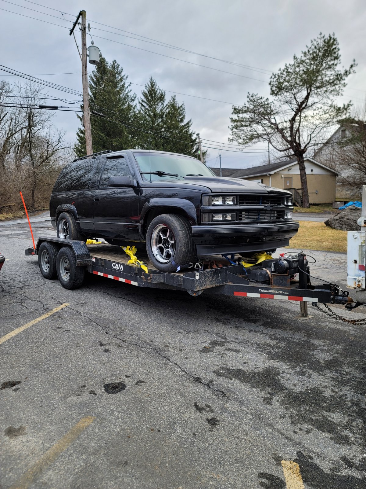

Finally got the ol girl loaded up on the trailer and brought it home today, so I can do some more work in the leisure of my home garage without having to move it out of my shop everytime we get a delivery..
