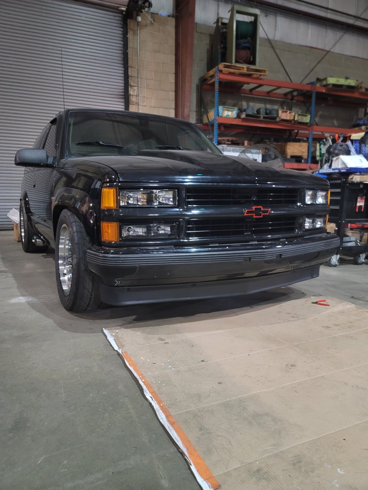

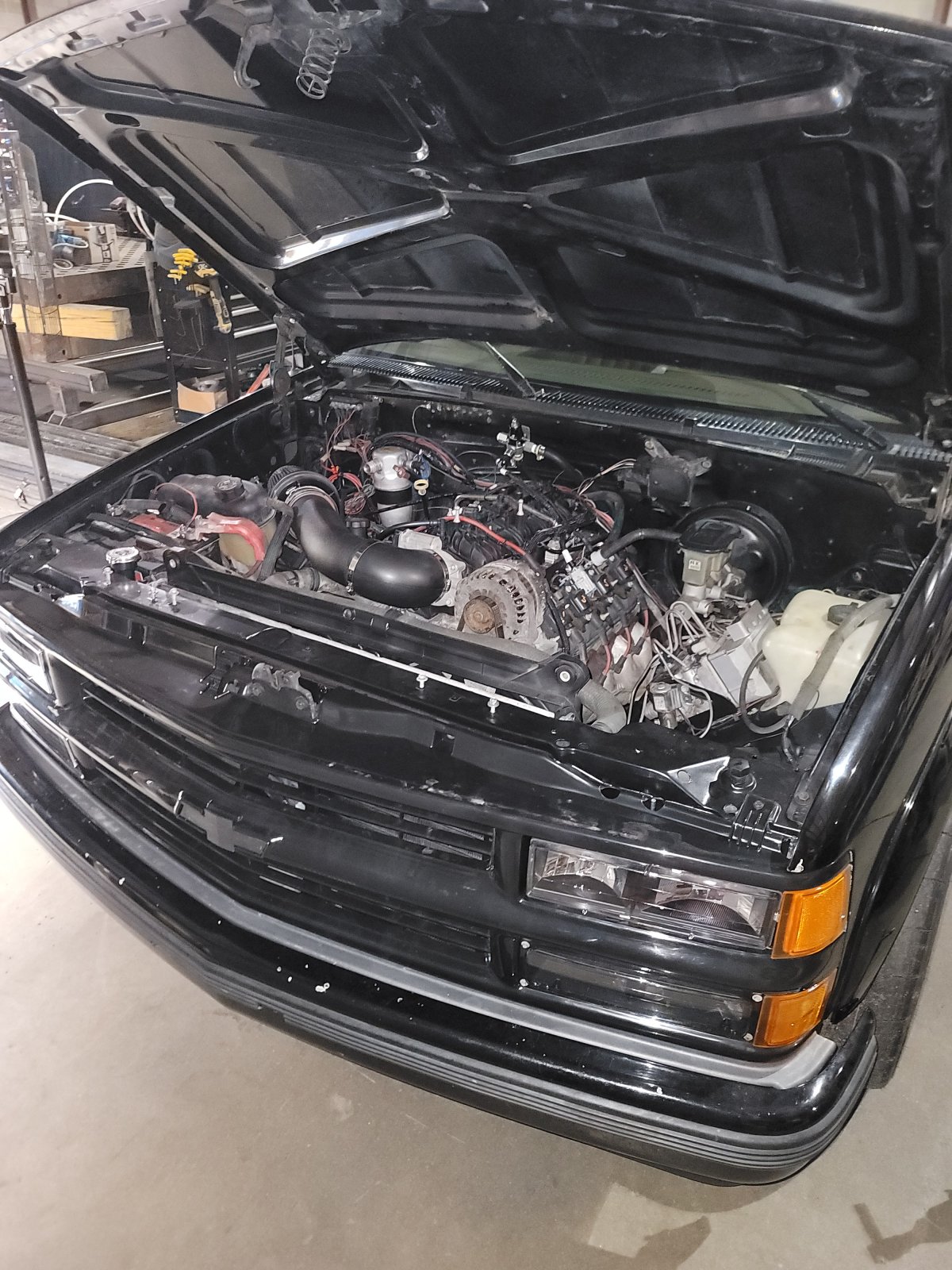

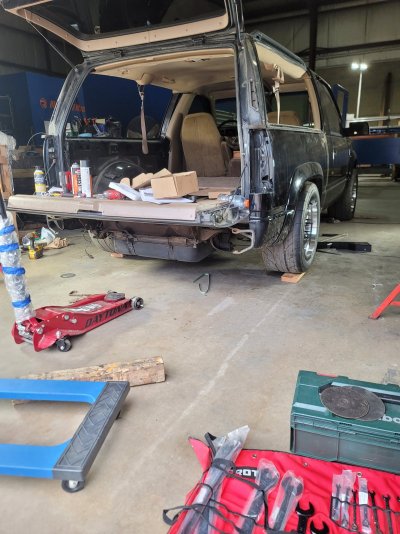

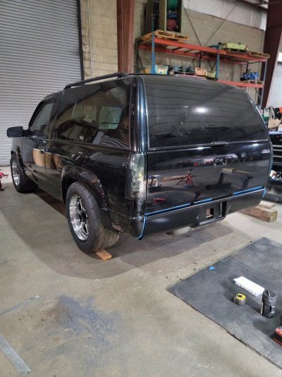

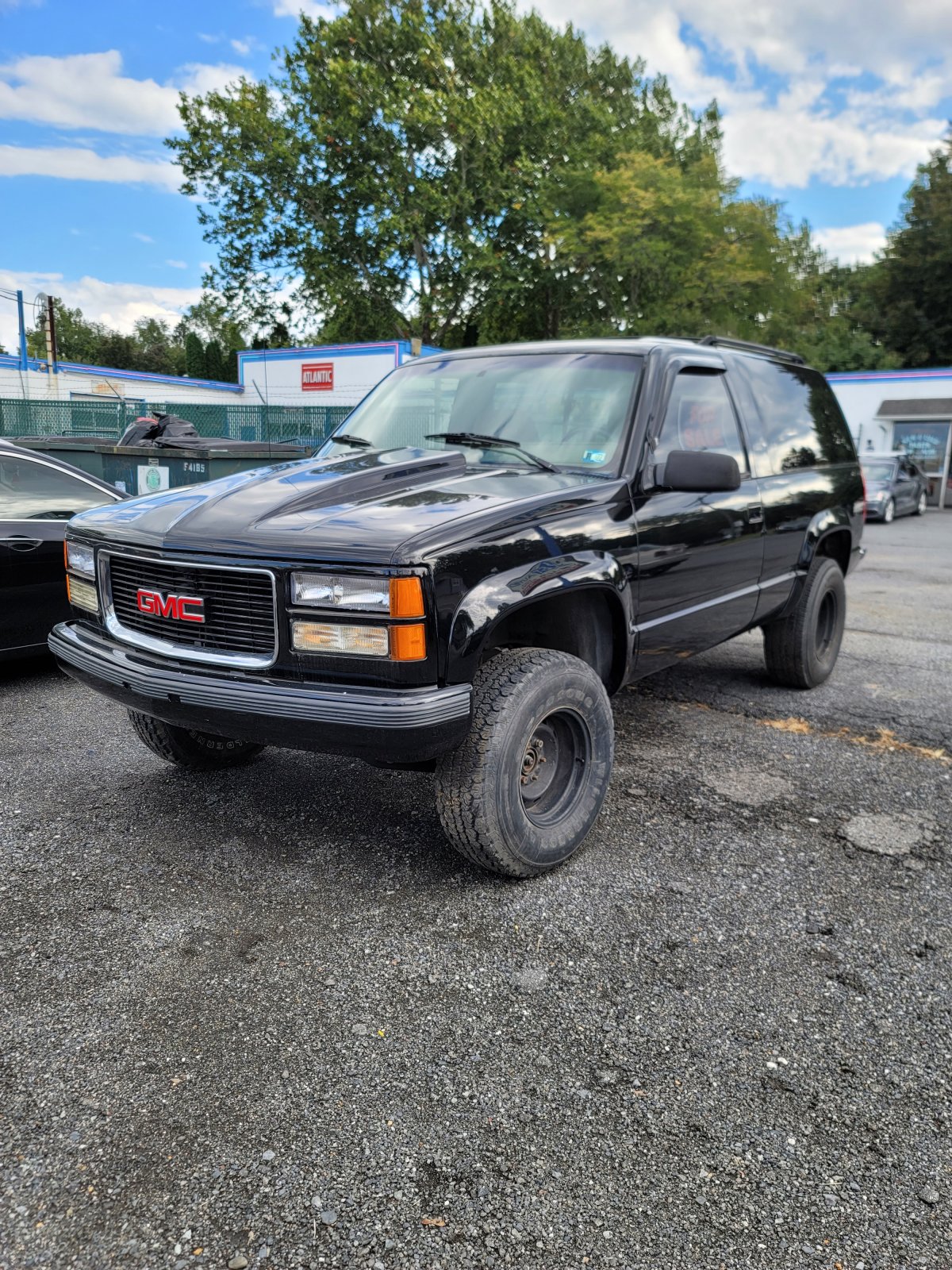

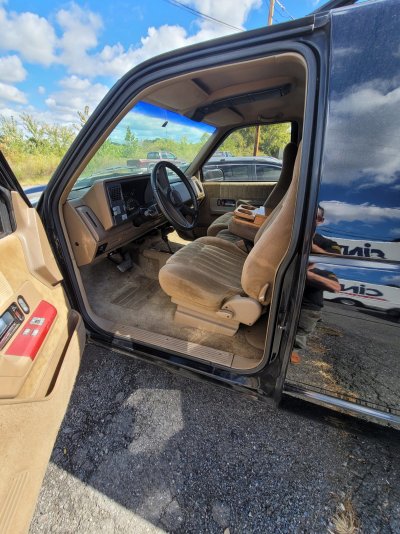

Hey everyone!
My name is John, I'm a machinist/welder/fabricator/mechanic with 20 years exp.

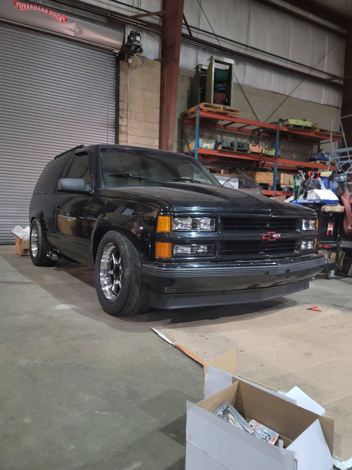

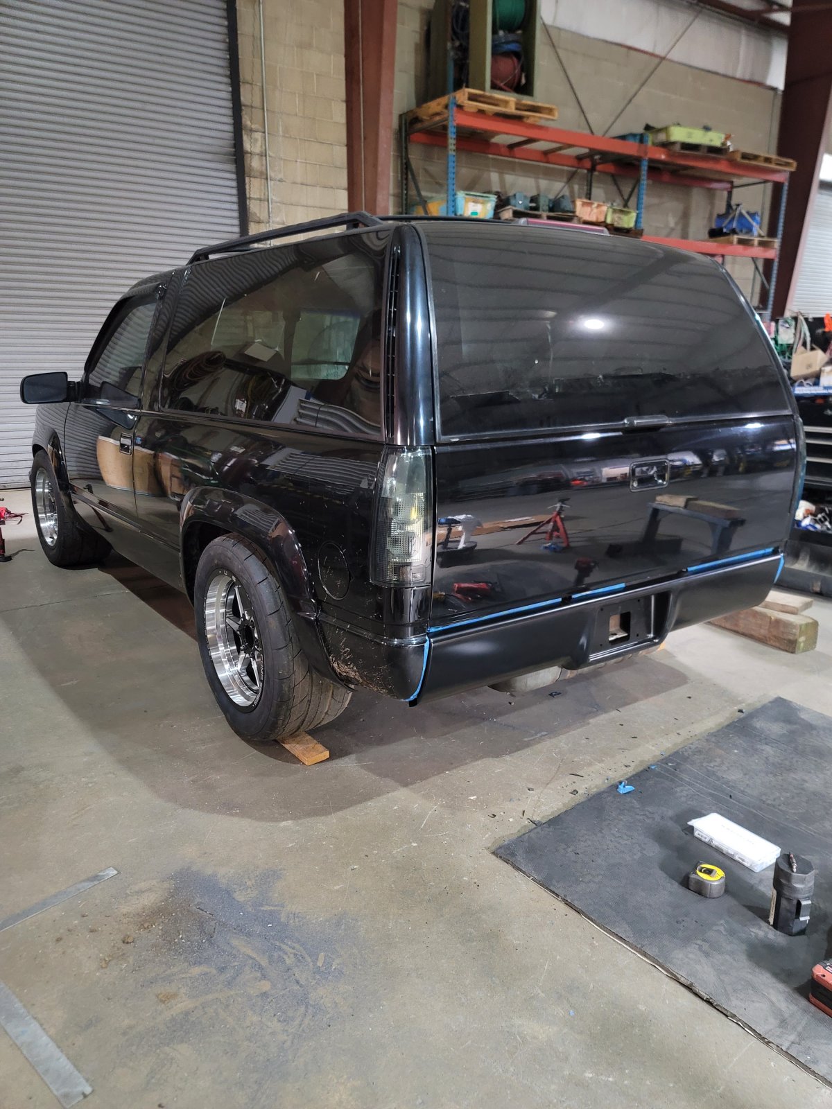

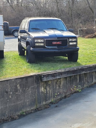

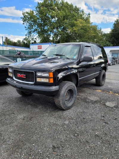

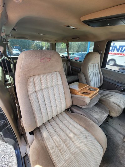

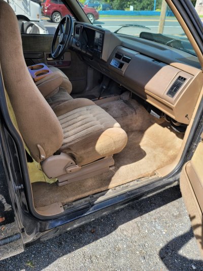

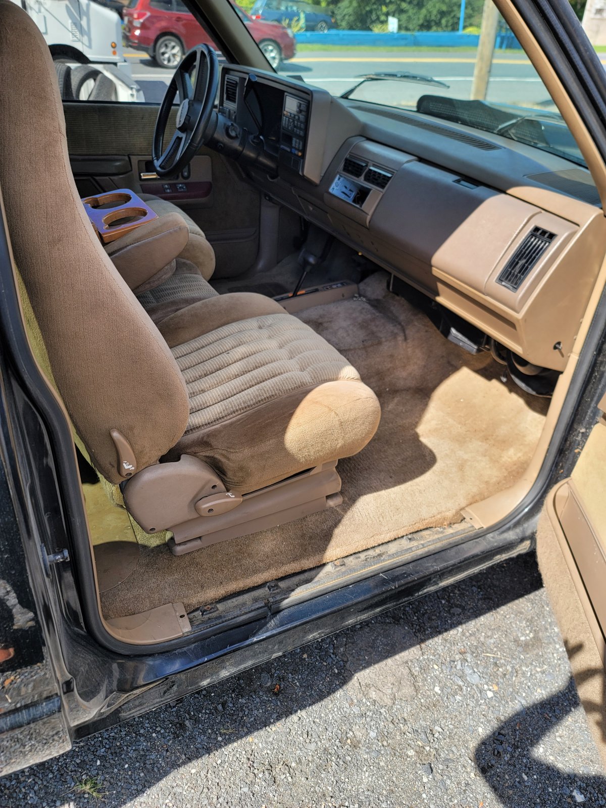

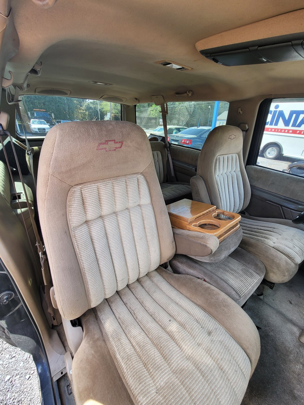

I enjoy building fast/one off vehicles, and recently picked up this minty 1994 chevy blazer gmt415 4x4!
Truck had approx 120k miles, I got it from a friend's father after it had blown up an older built 350..
Truck is now on its 3rd owner, I got it as a roller, and always wanted to build one!
My plan was to find something to swap one of my LS engines I had been acquiring over the past year, turbo, and learn to tune with a terminator to 1000hp..
This truck ticks all the boxes and have kept it 4x4! Check it out!!

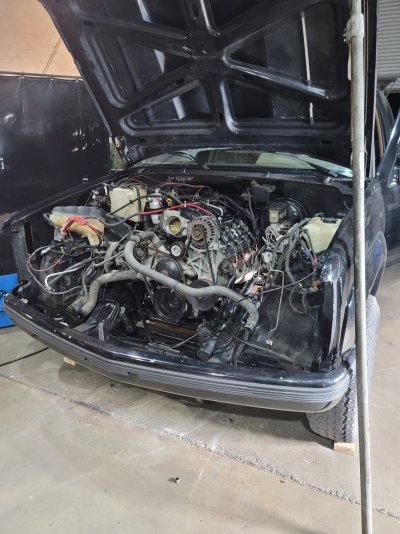

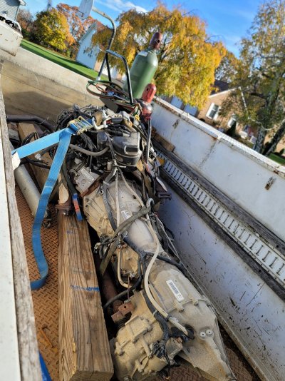

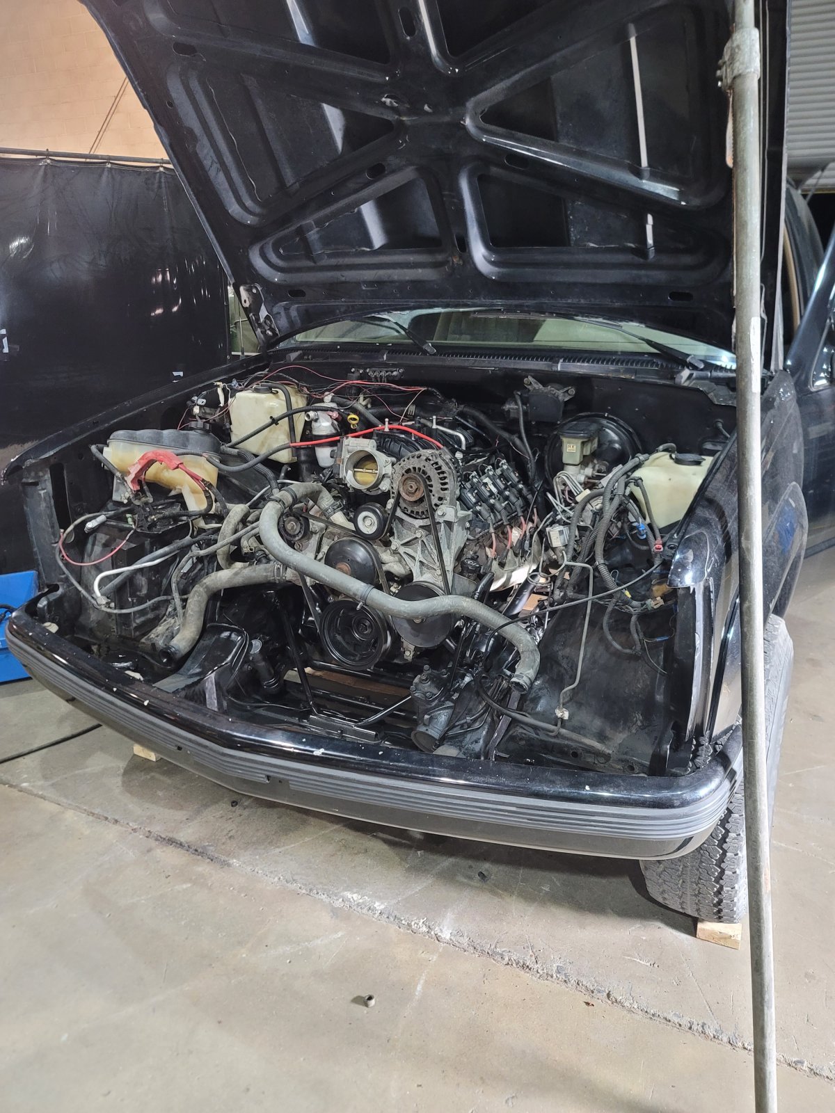

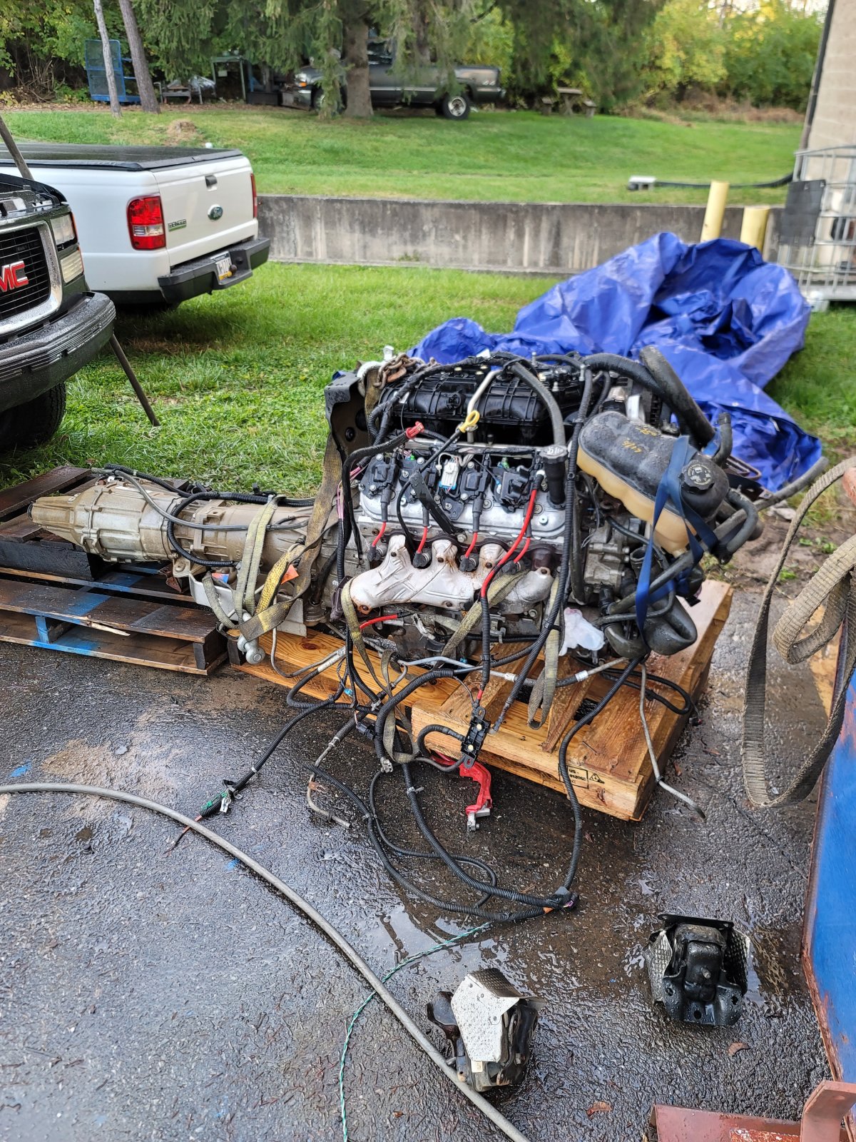

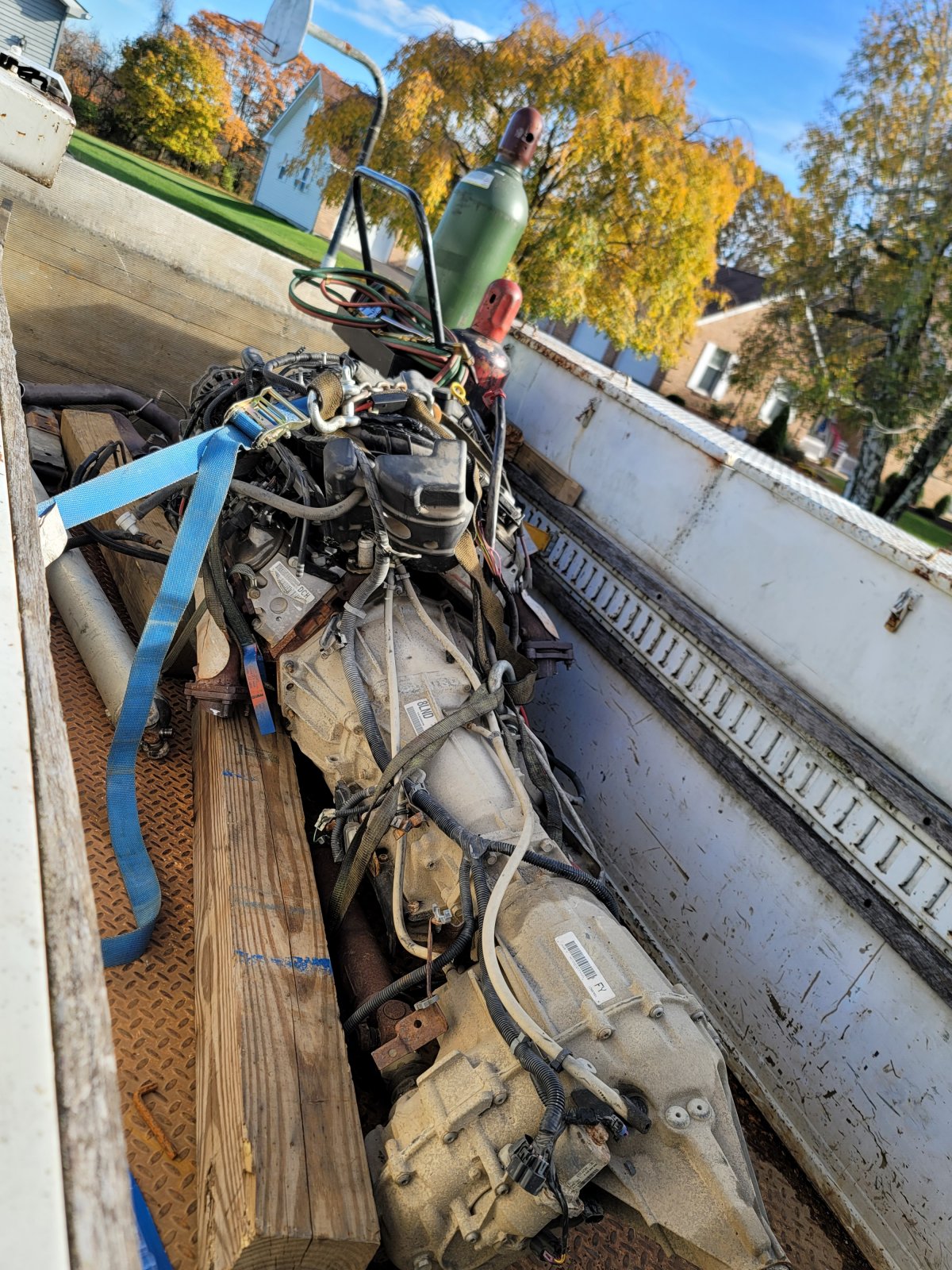

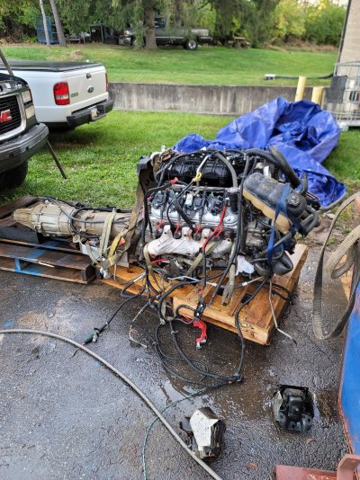

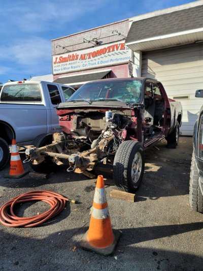

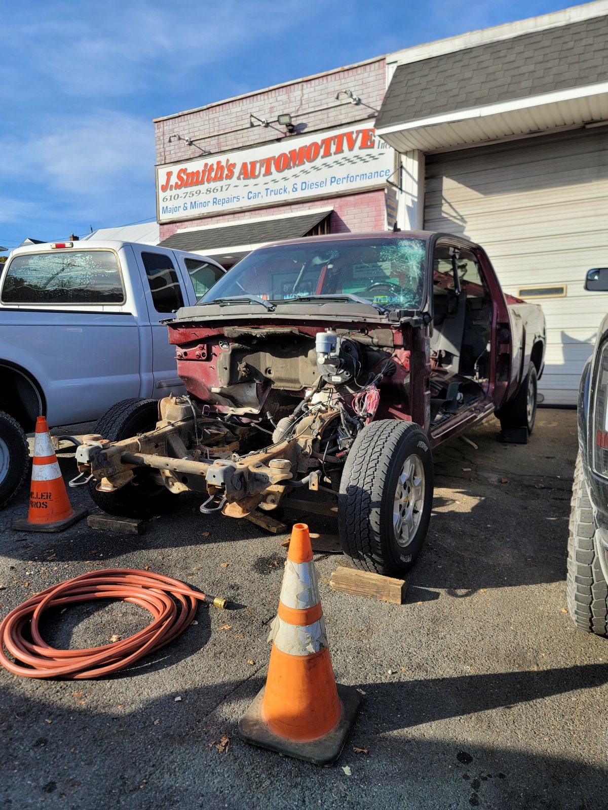

The drivetrain donor is a 2008 sierra 1500 with a 5.3 ls and 4l60, and 96k on the clock..
Motor had amsoil in it since new!
The donor was a no start at my buddy's shop for the past year ..
The truck was too rusty to continue to dump money into, and therefore I was given the opportunity to come pull the drivetrain!
Went down to my buddys saturday just after lunch, and by 6pm that evening had the donor looking like this!
I suspected a corroded harness/computer being the reason for the no start, and had found some evidence of that being the likely culprit along the dismantle

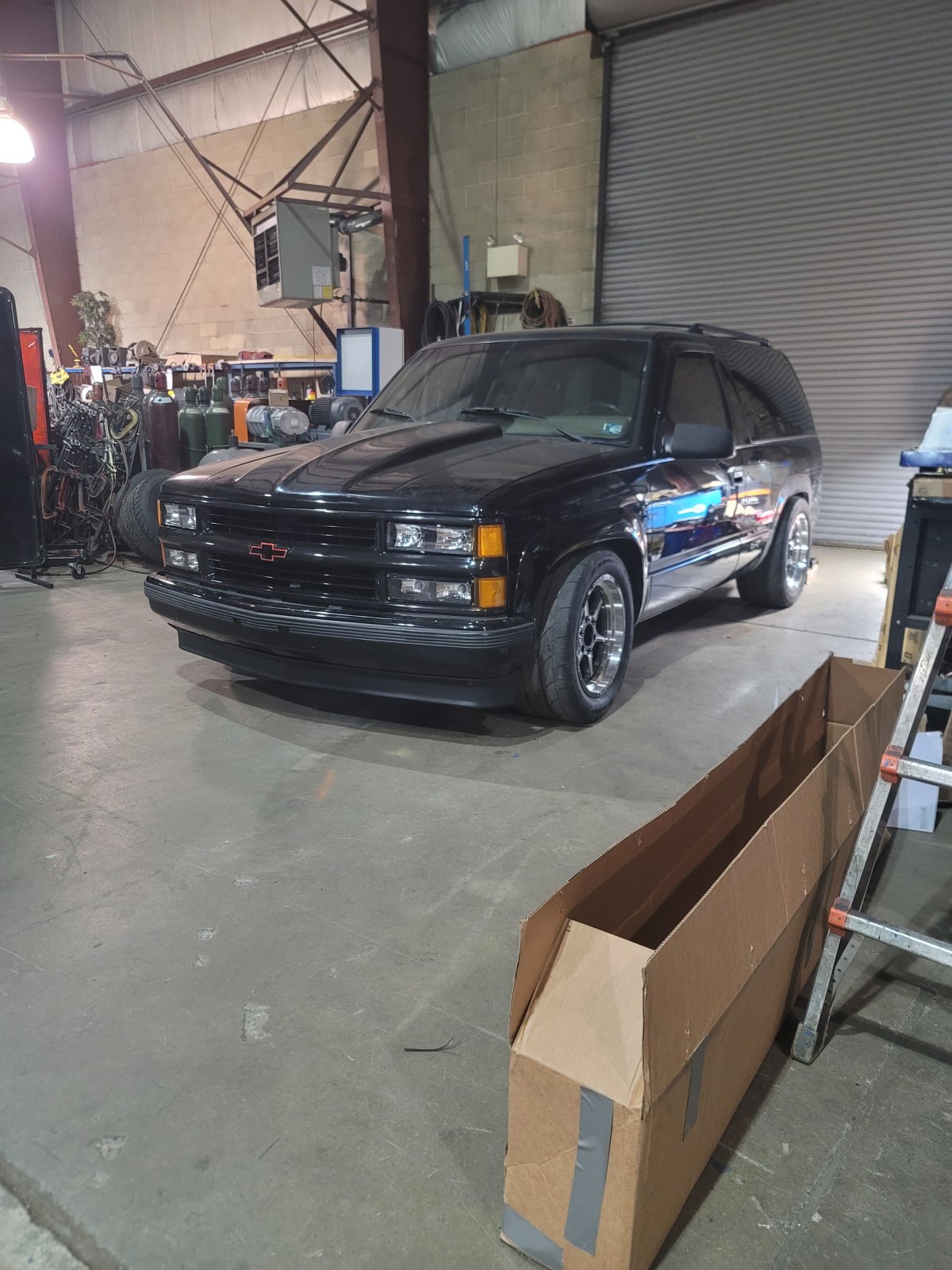

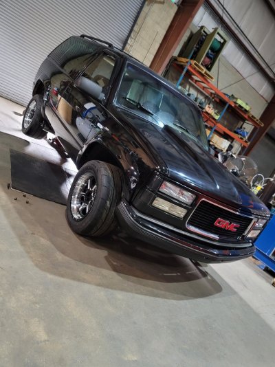

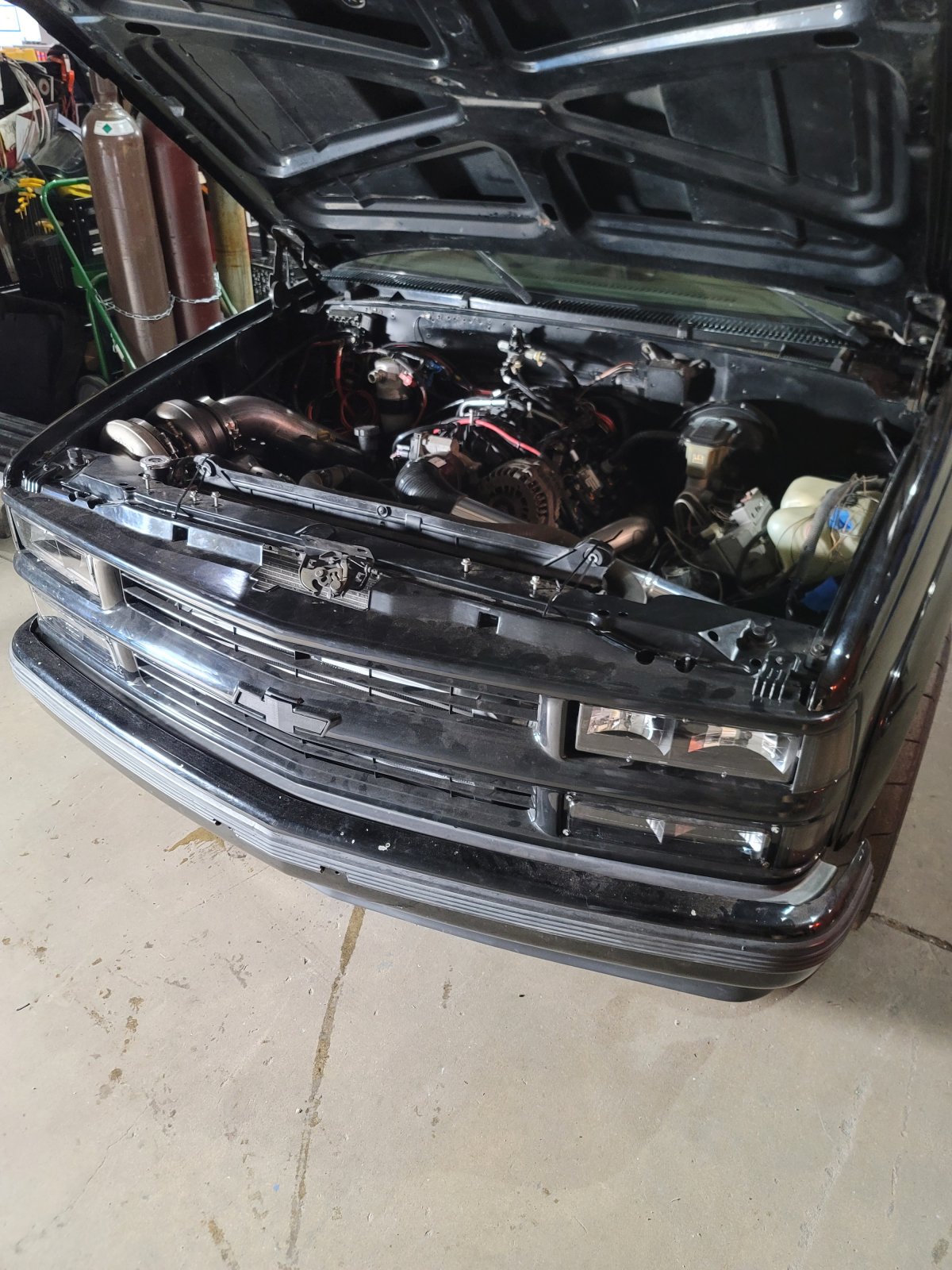

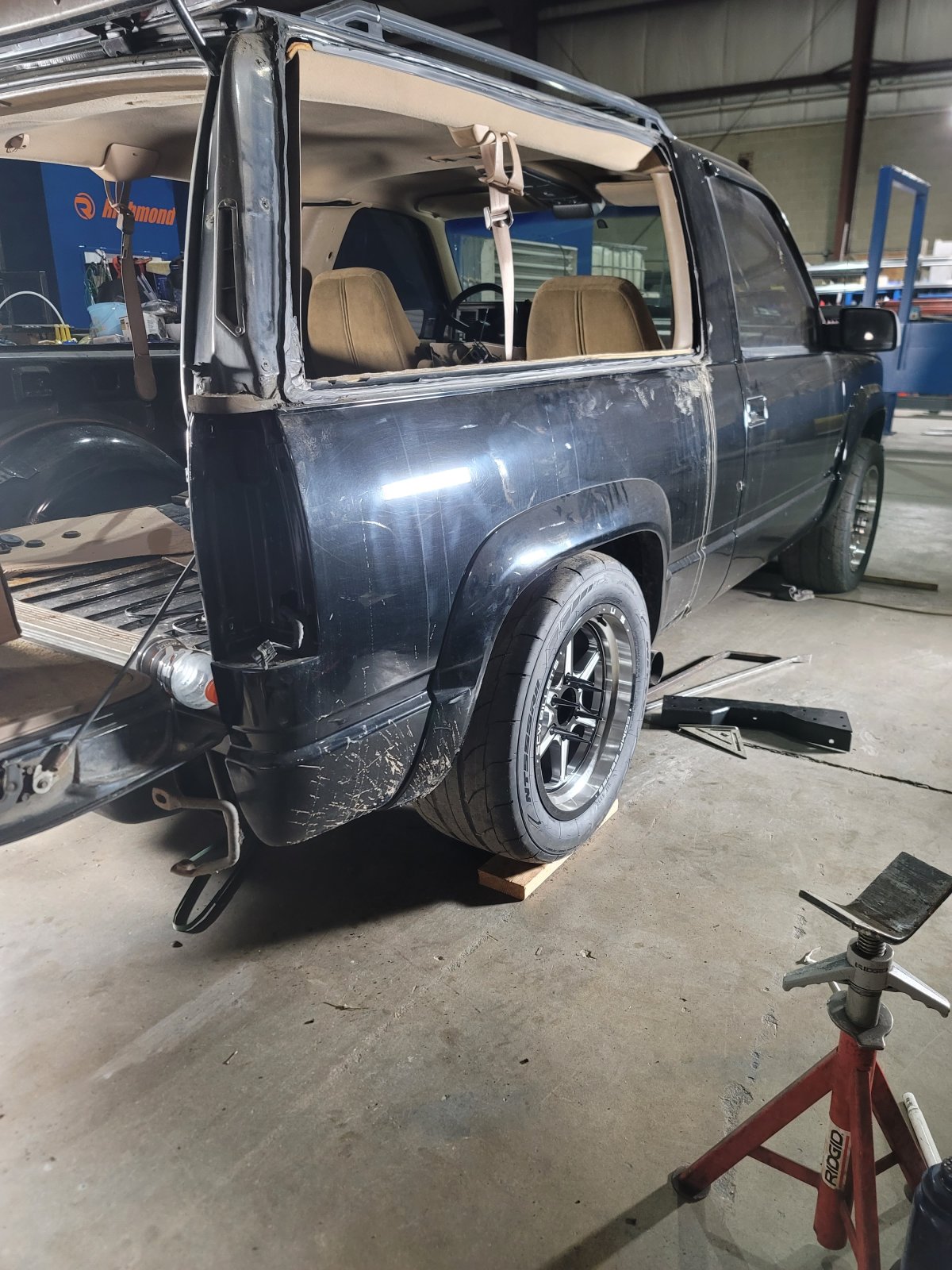

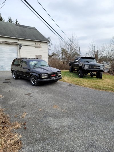

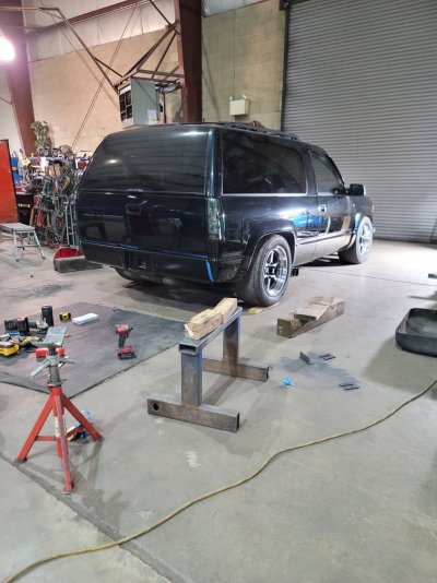

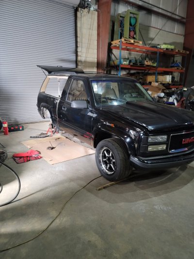

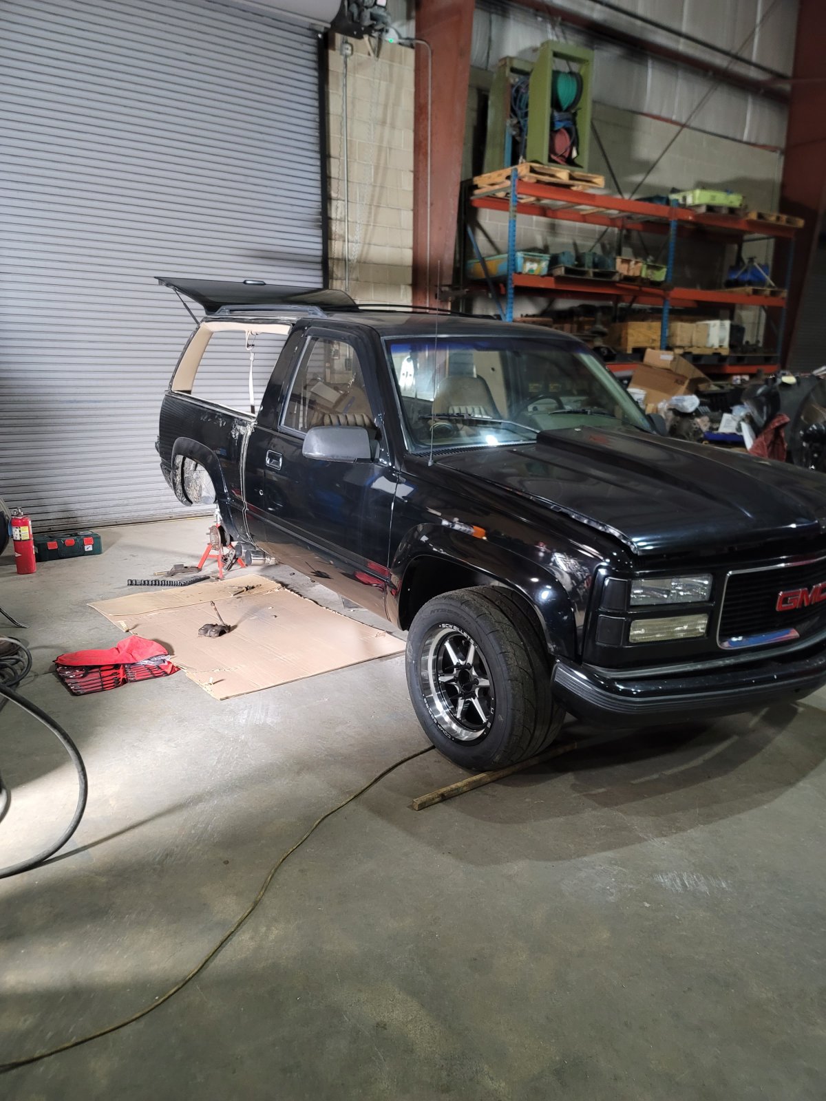

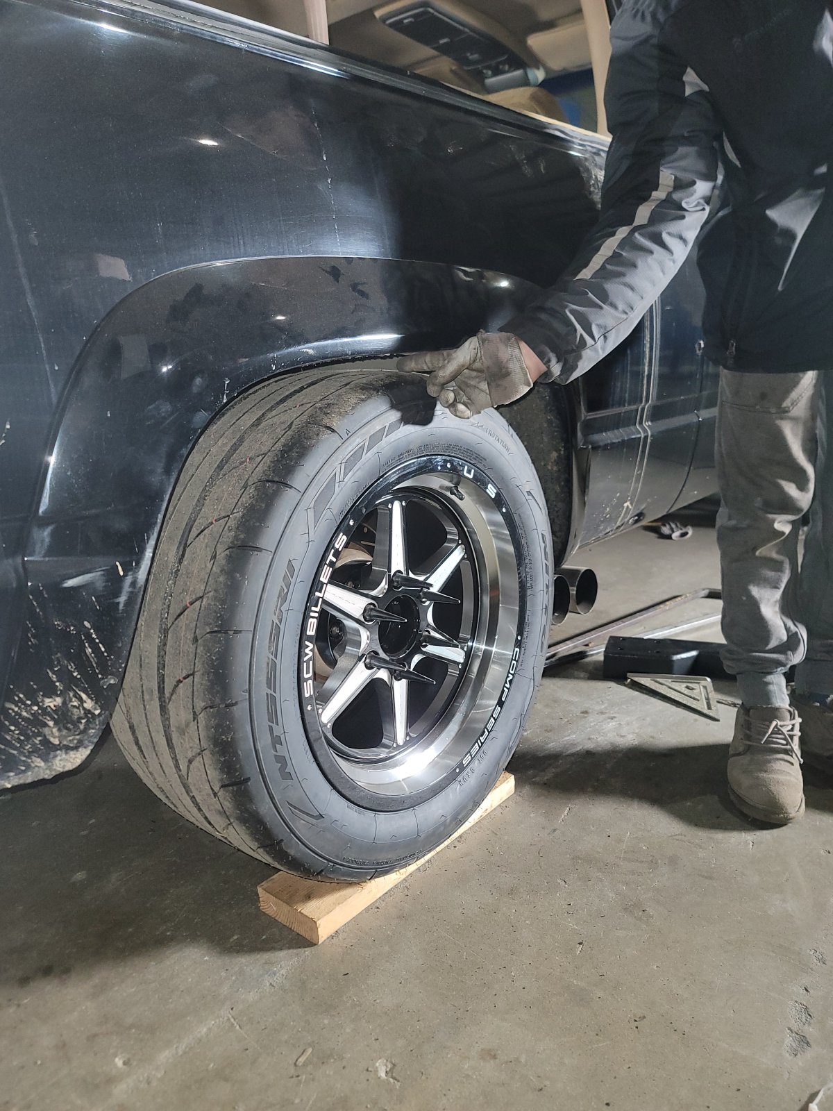

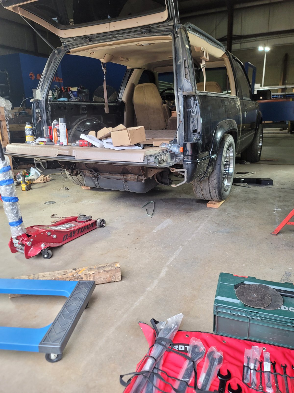

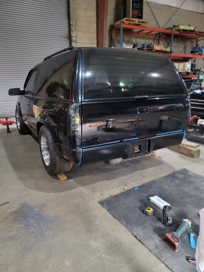

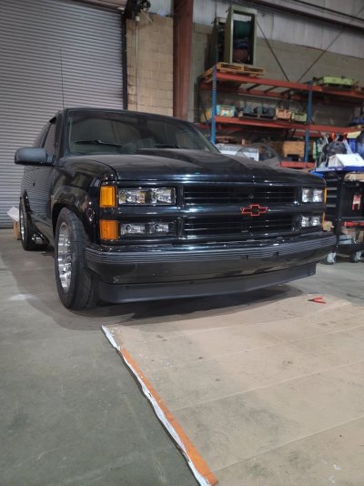

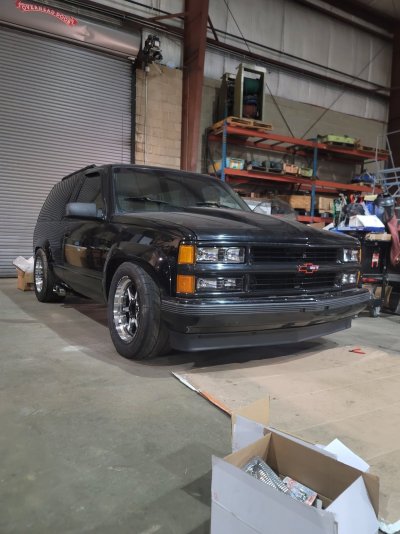

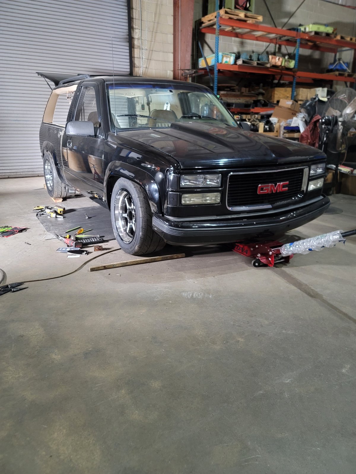

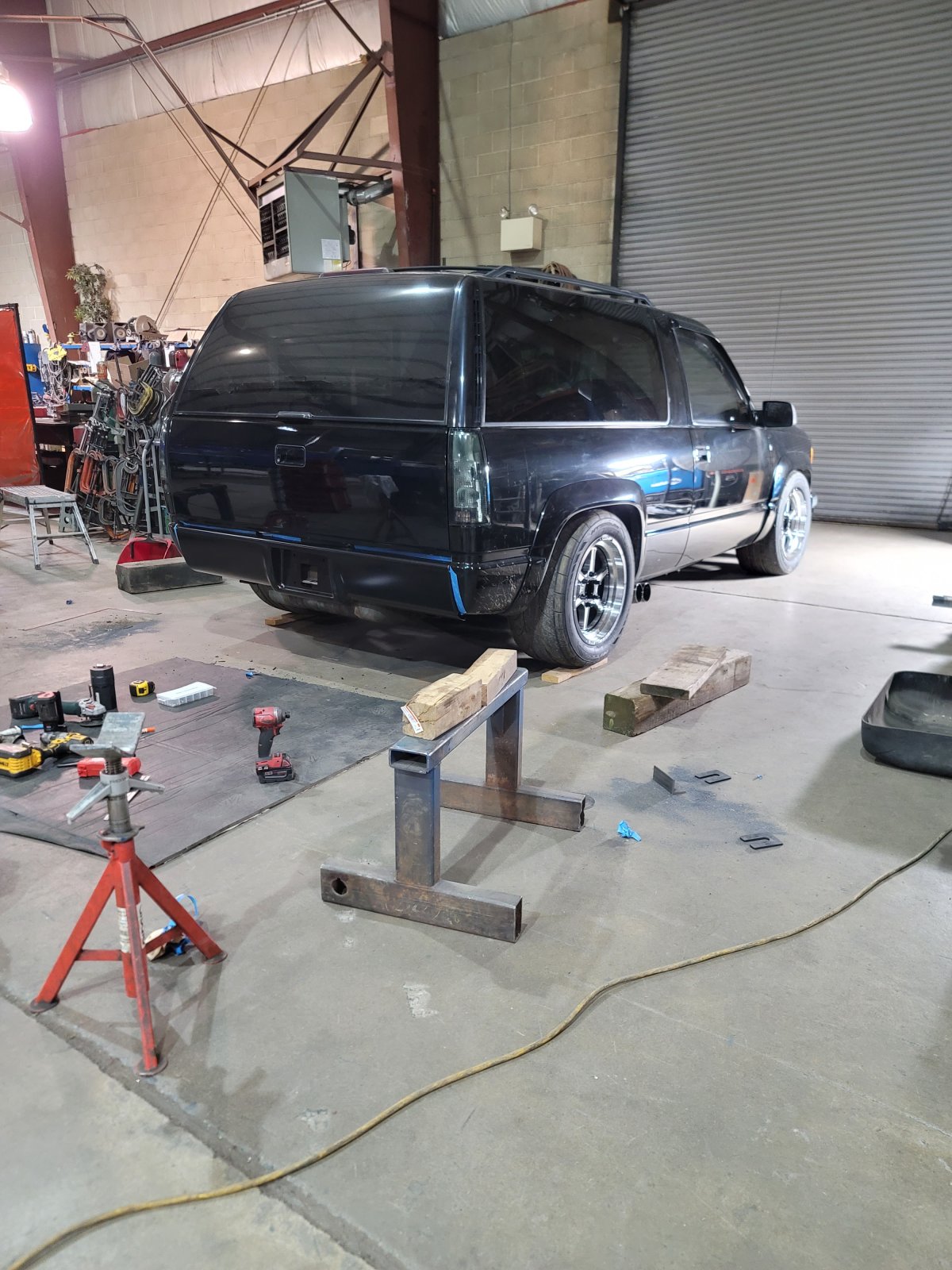

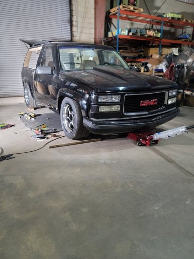

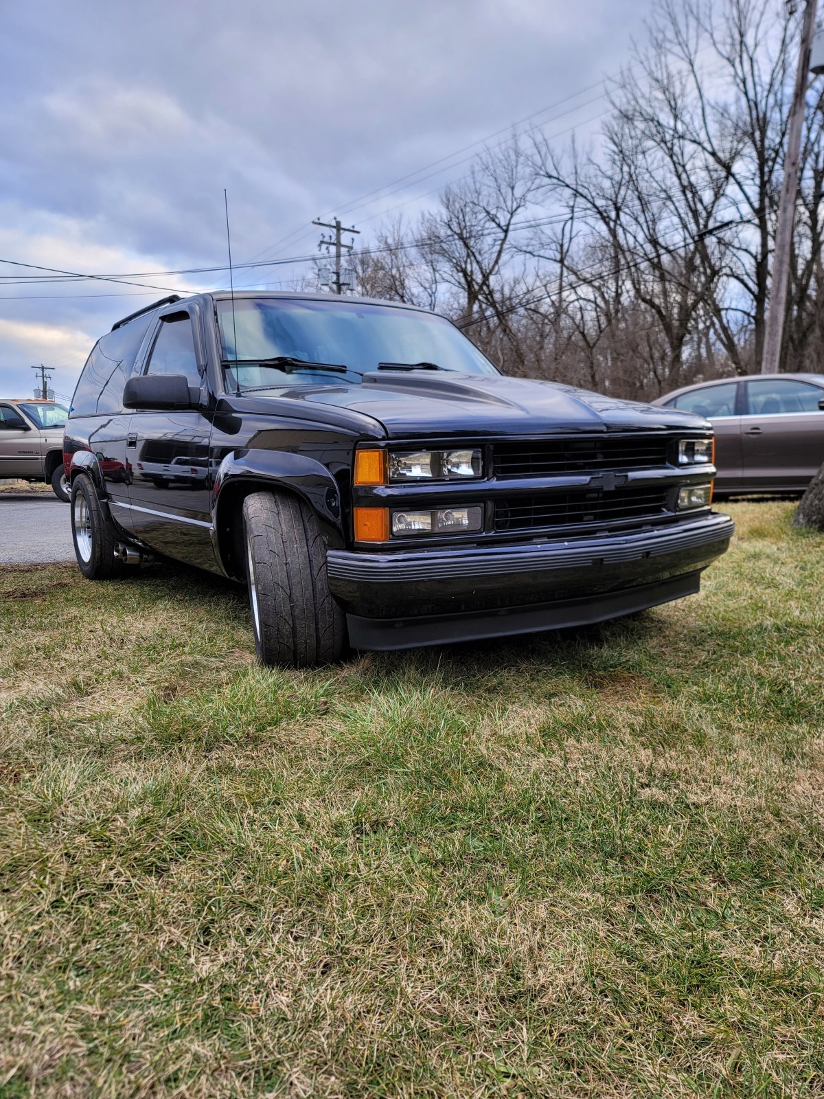

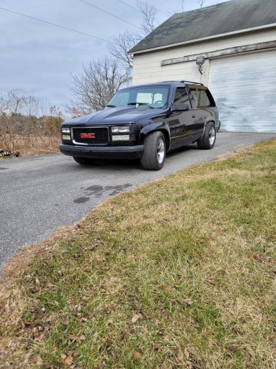

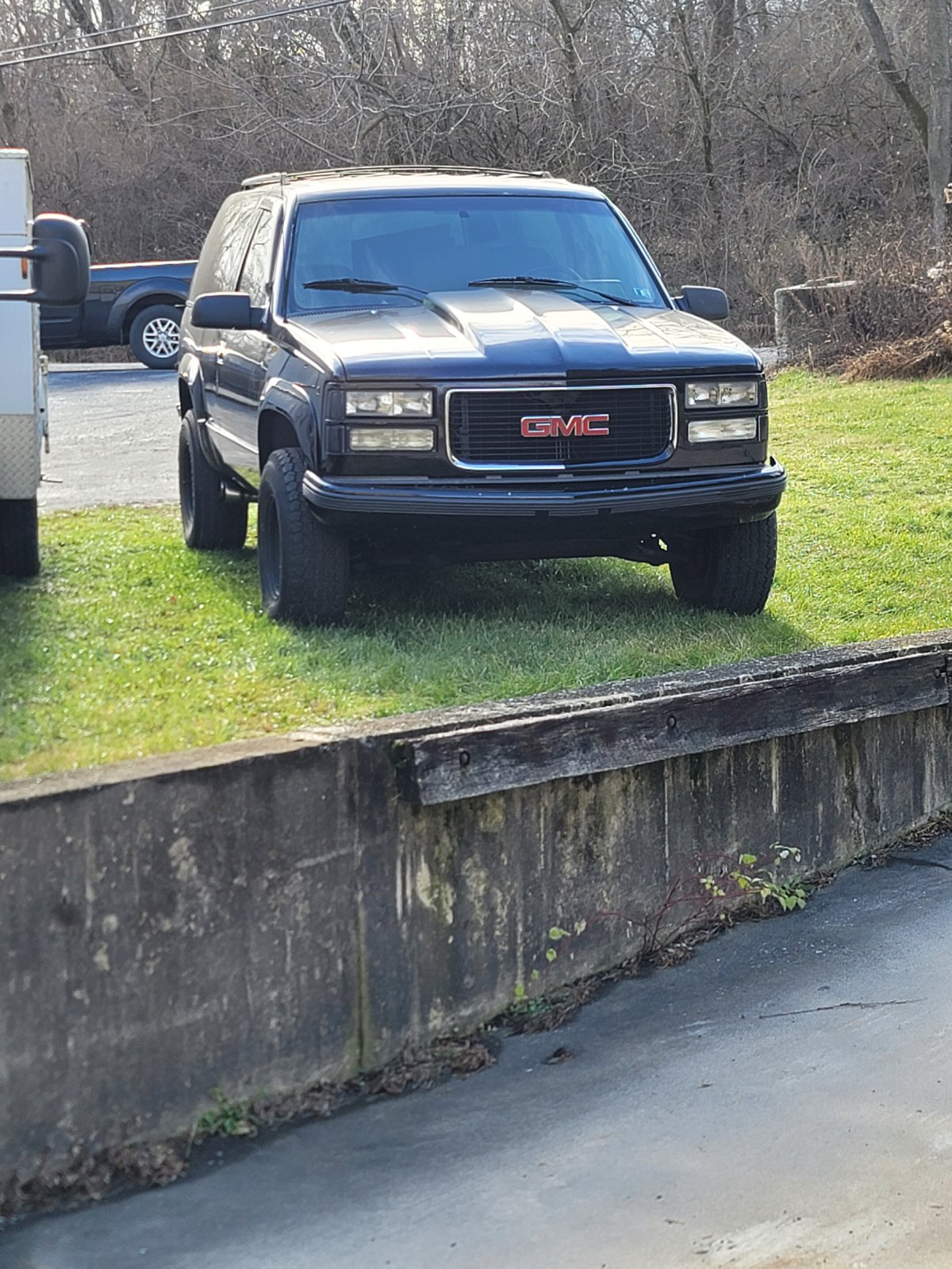

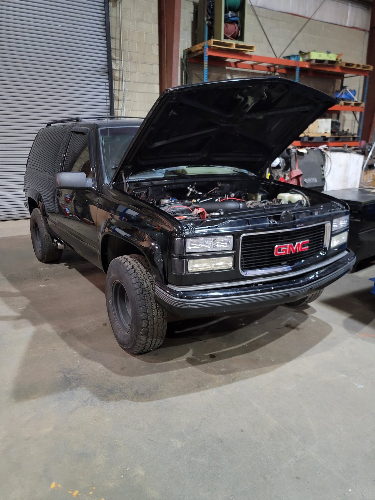

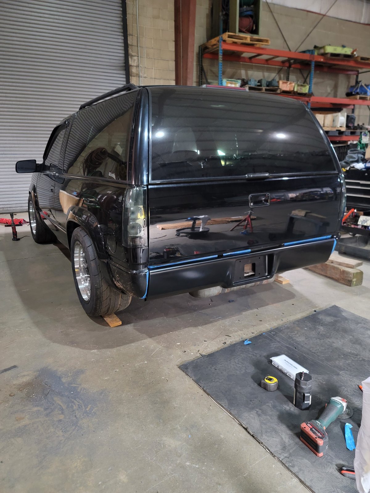

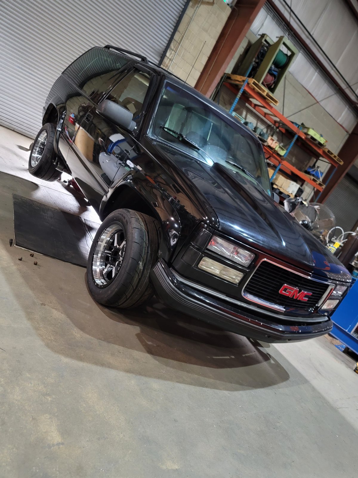

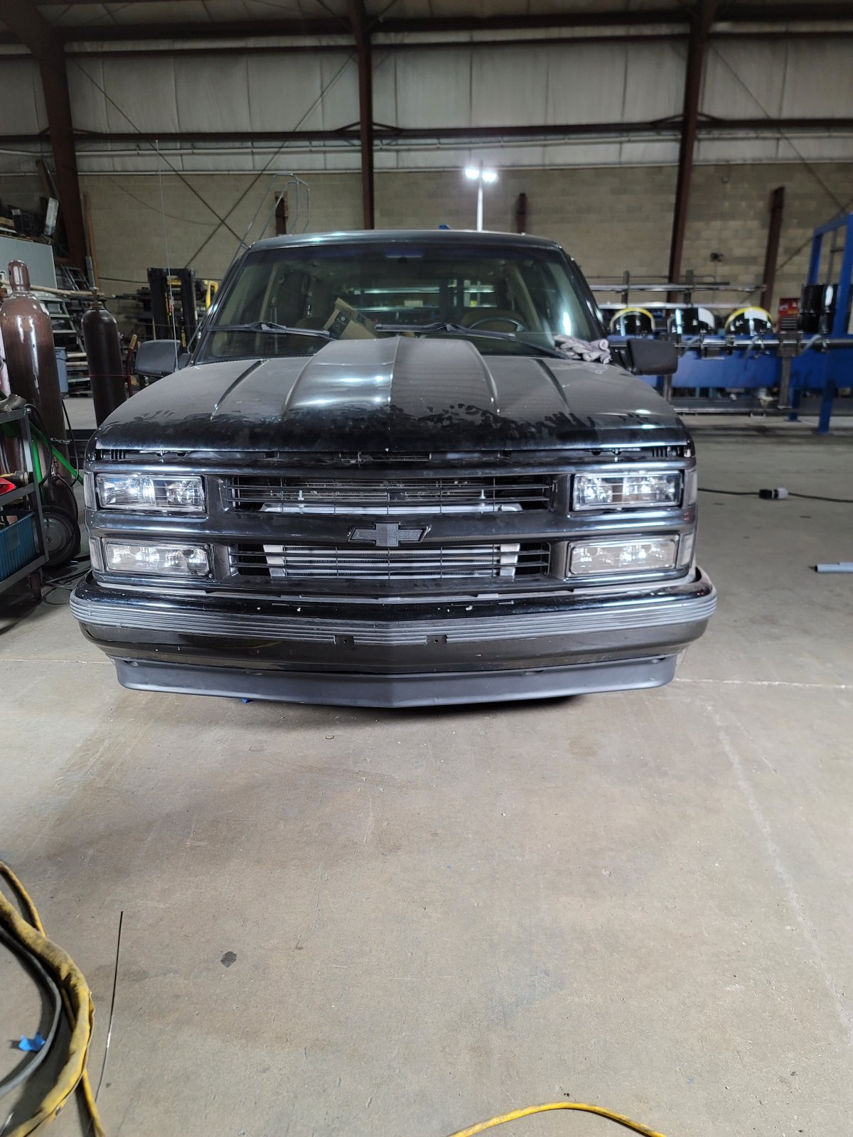

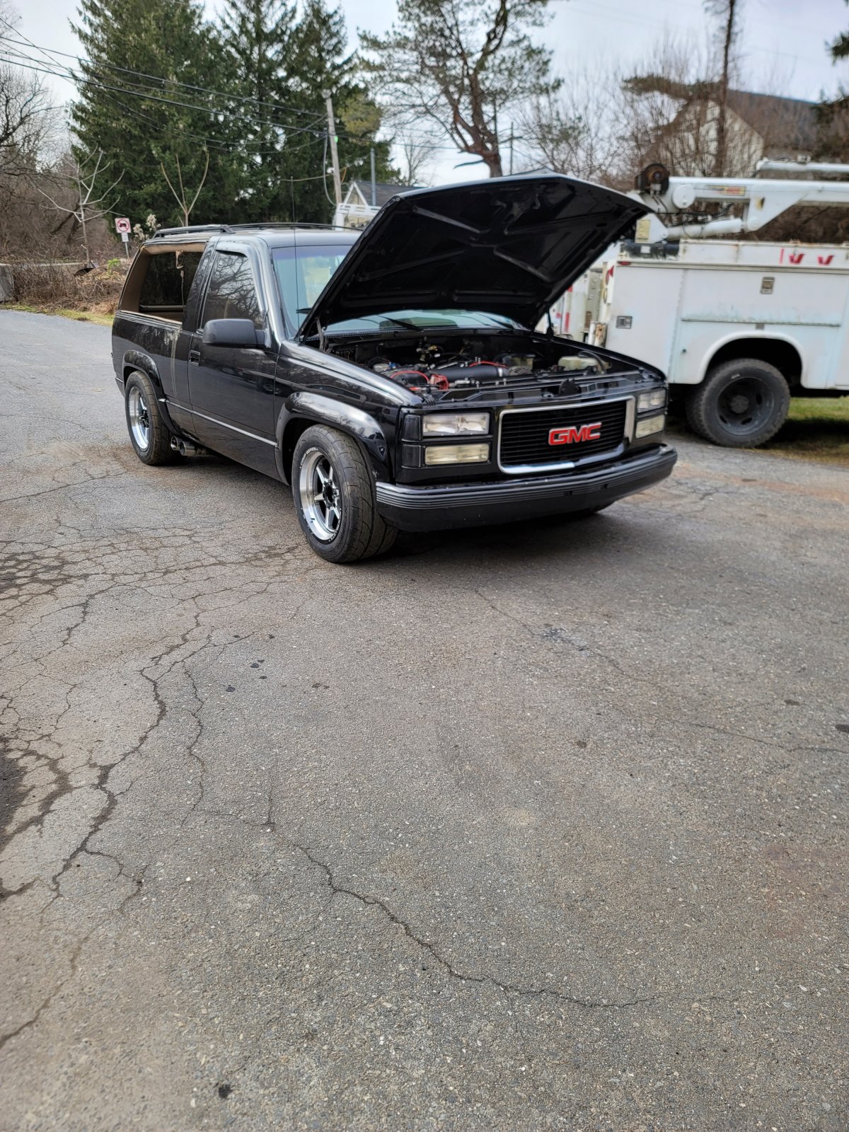

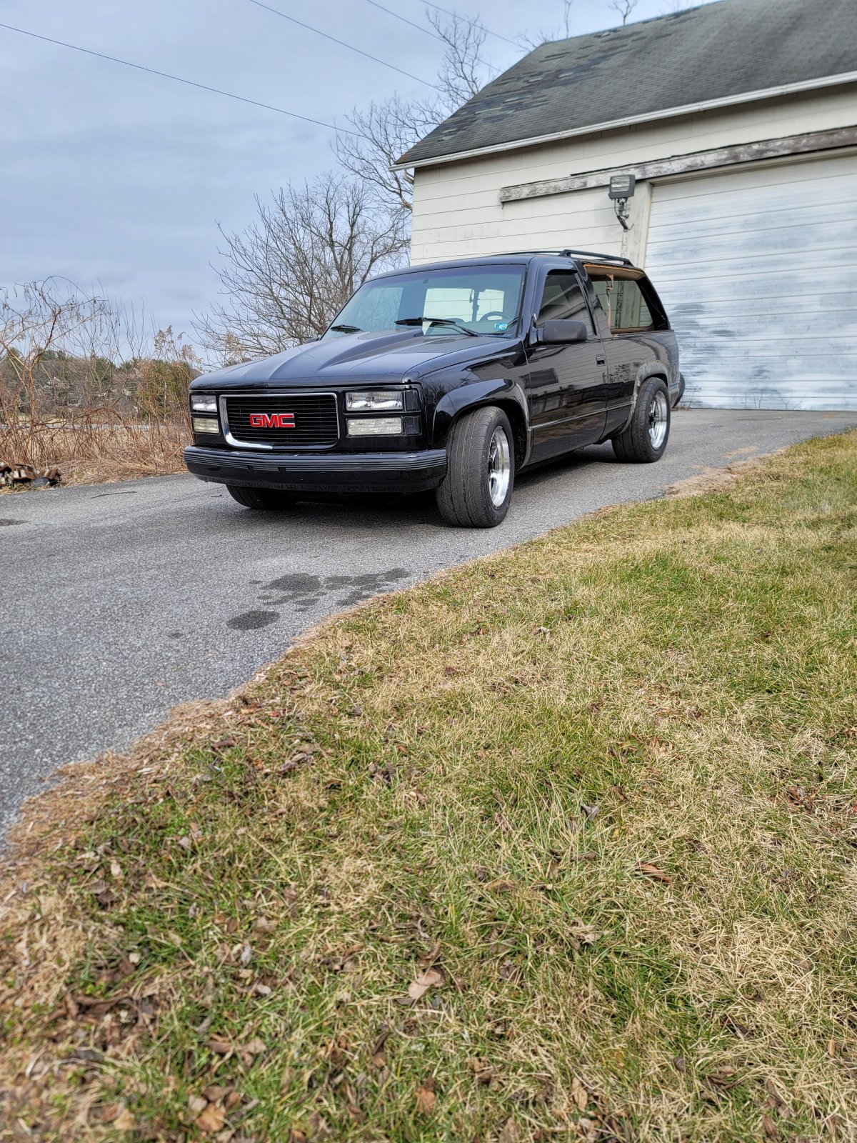

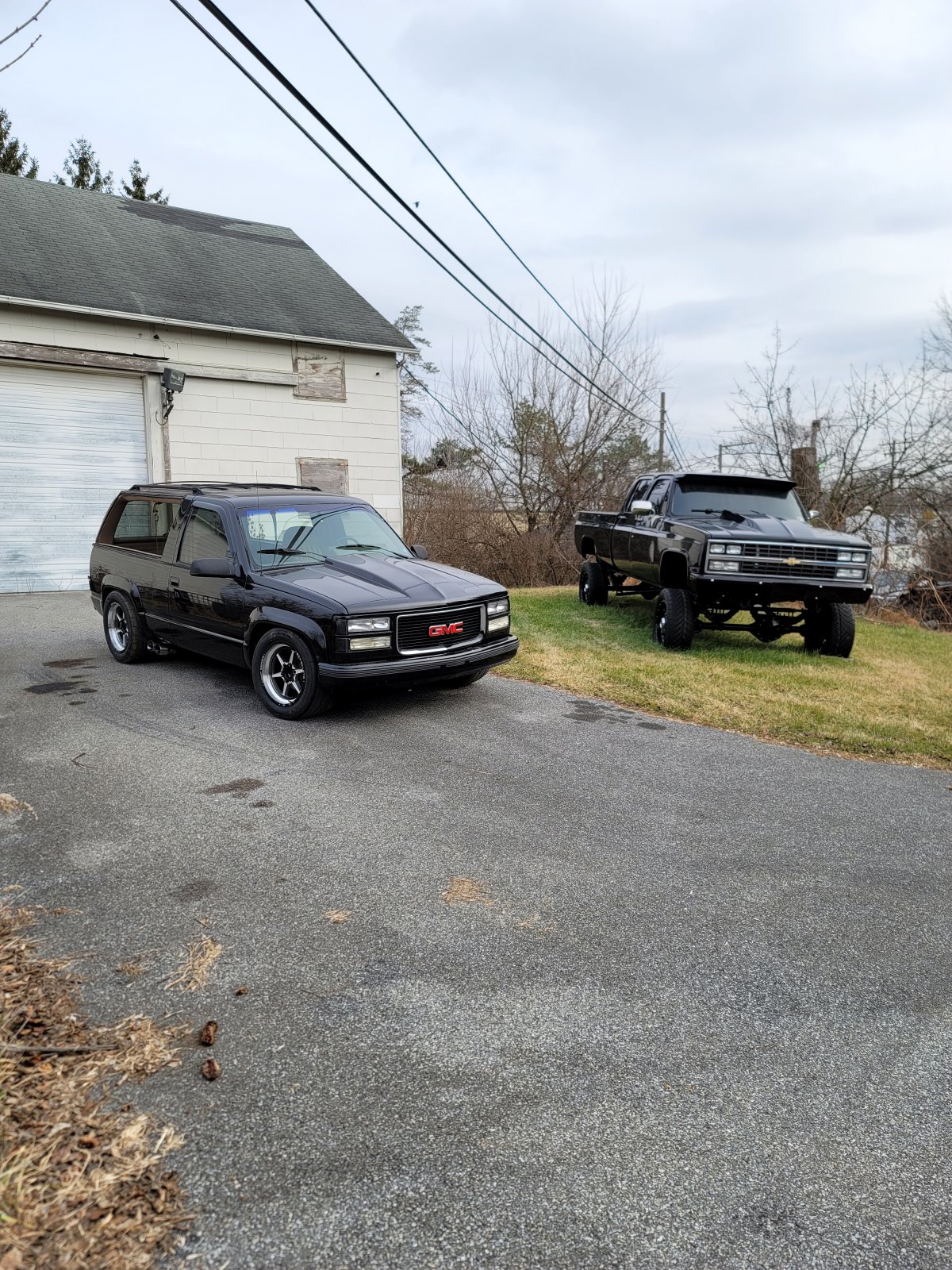

Here's some more pics of the truck getting the stance right, new drag wheels/nt555 in 305/45/18, and getting rid of the gmc grill..
I will also be posting a build thread, but just wanted to get something going and introduce myself..

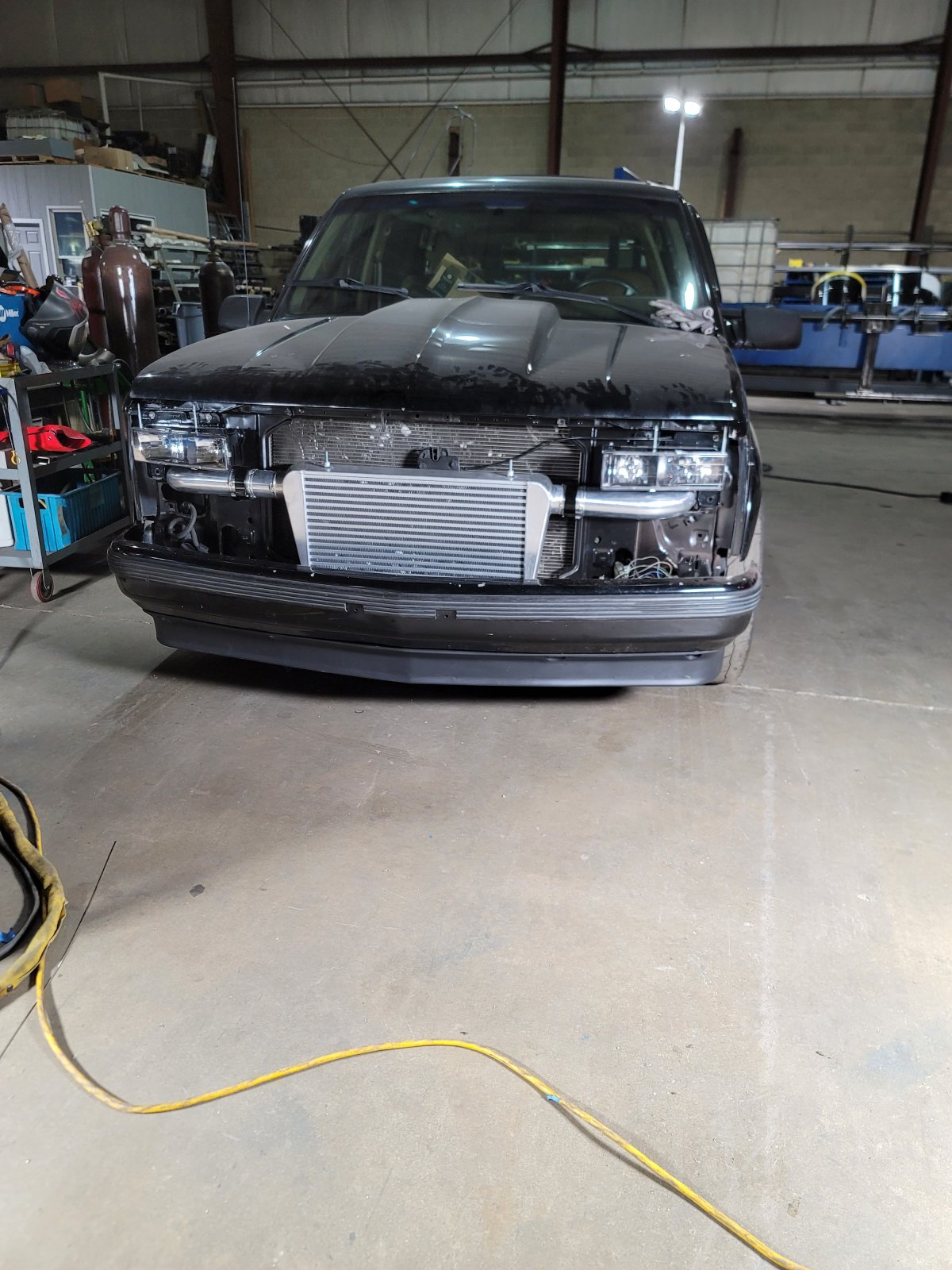

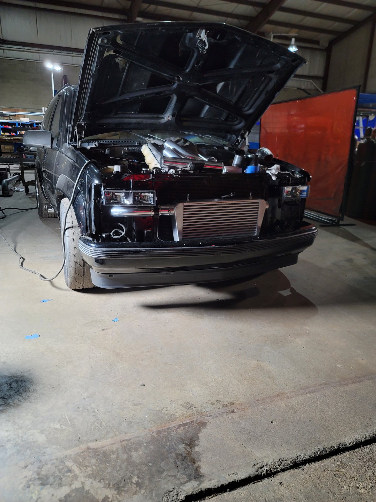

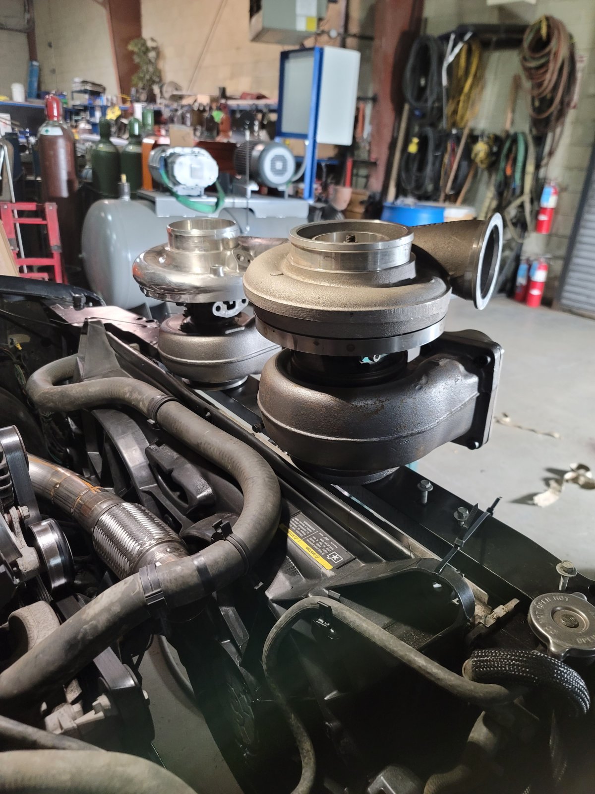

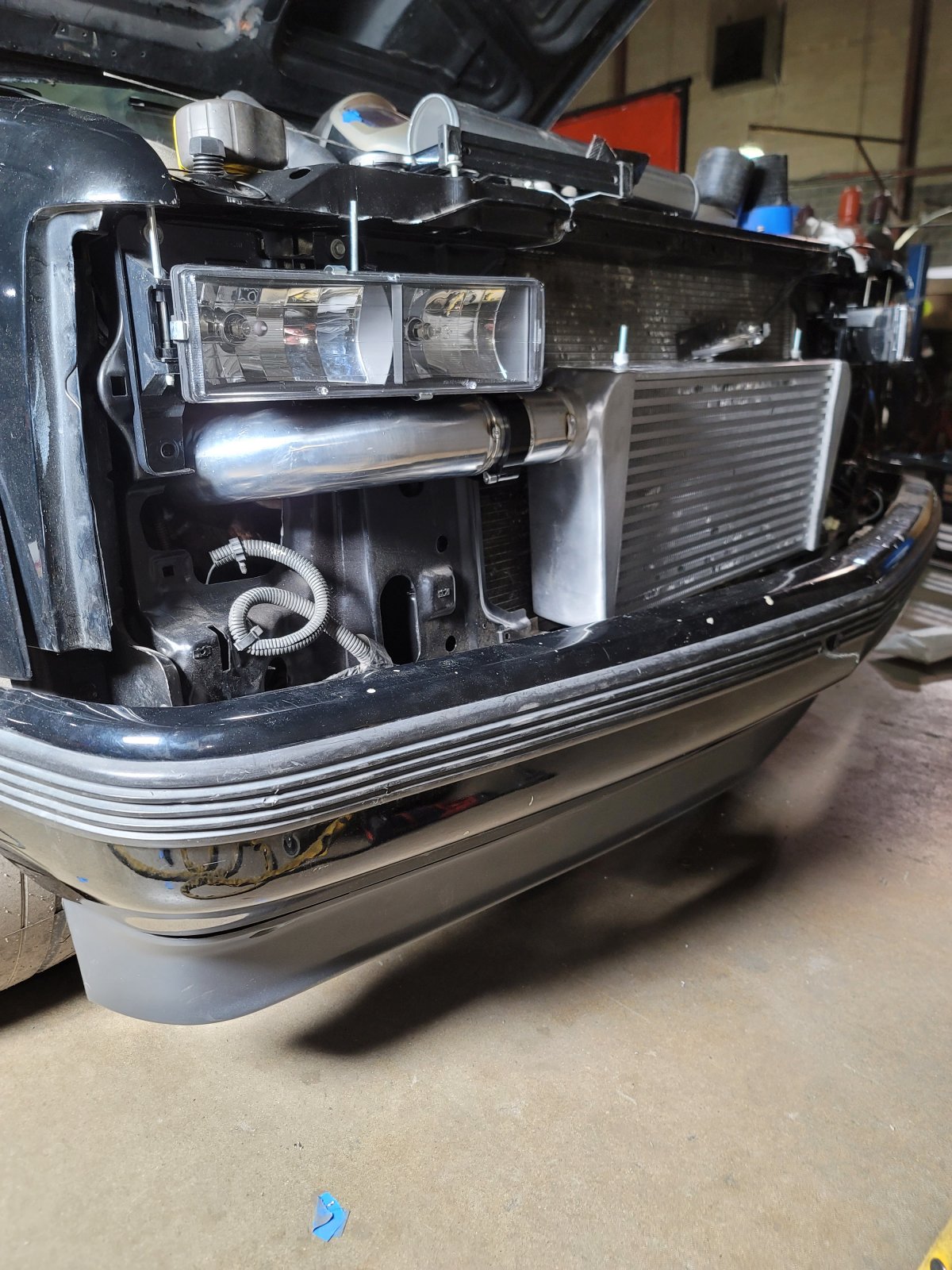

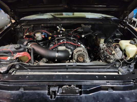

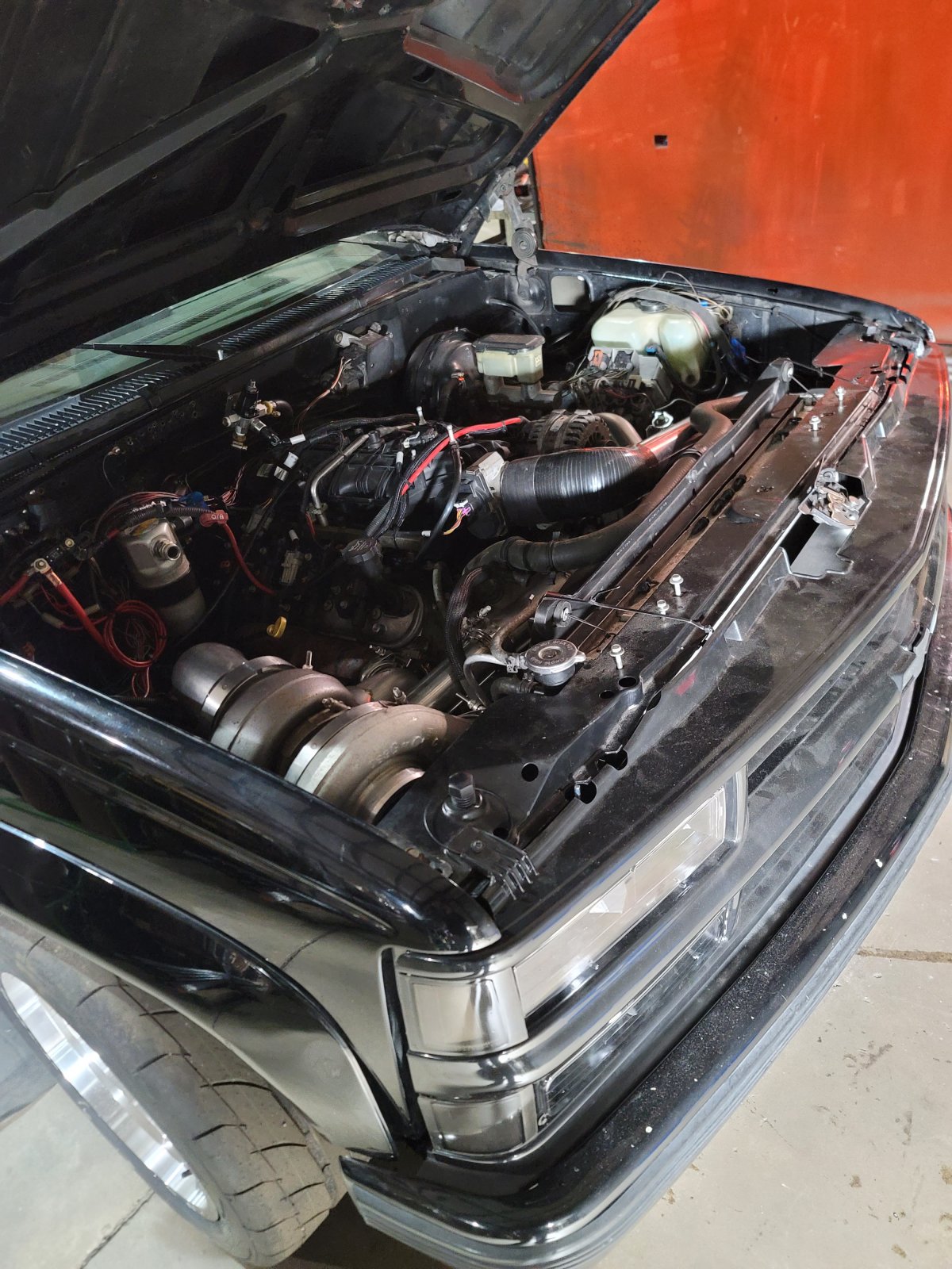

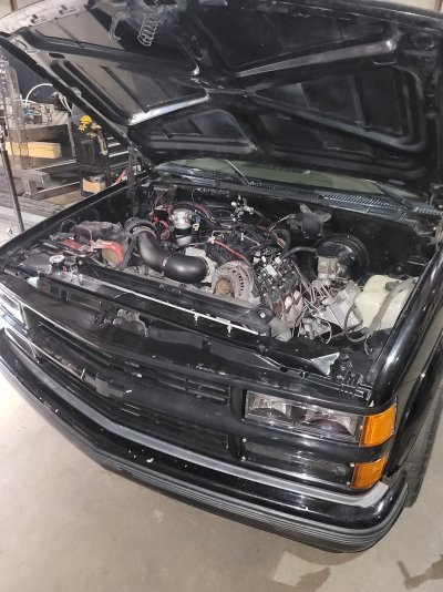

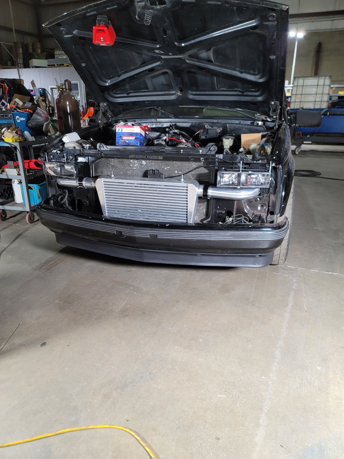

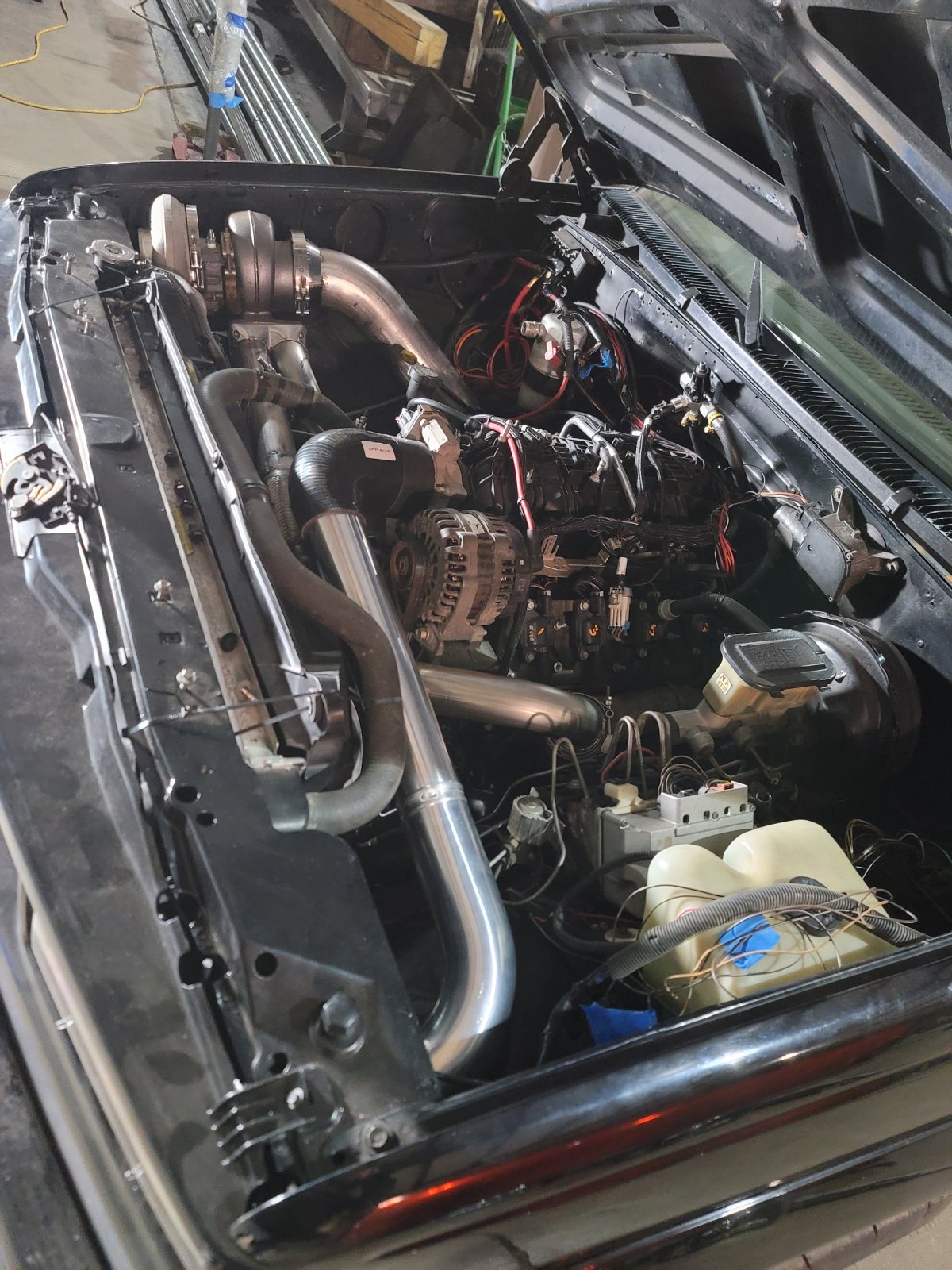

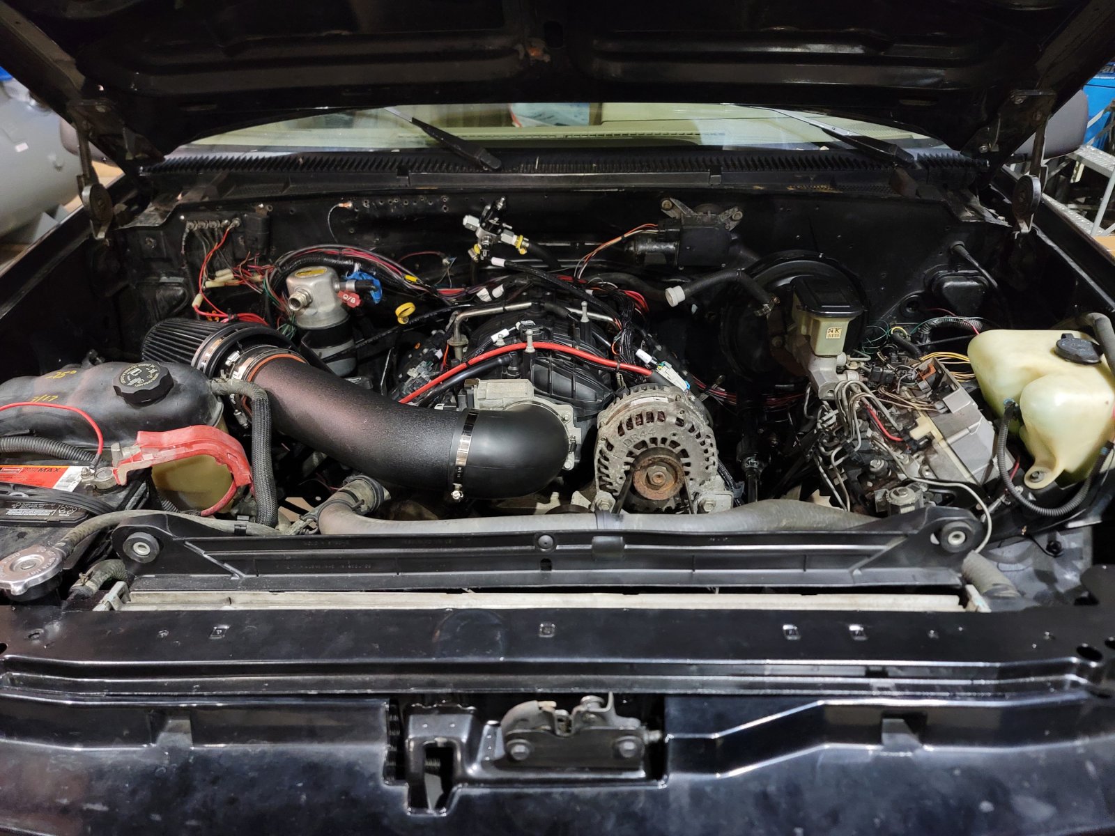

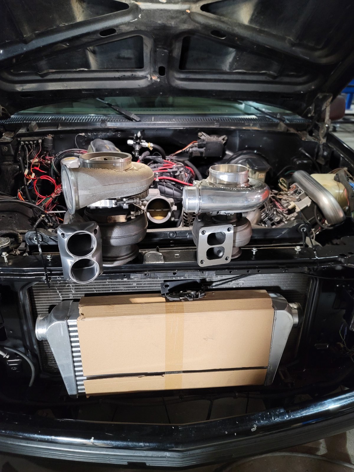

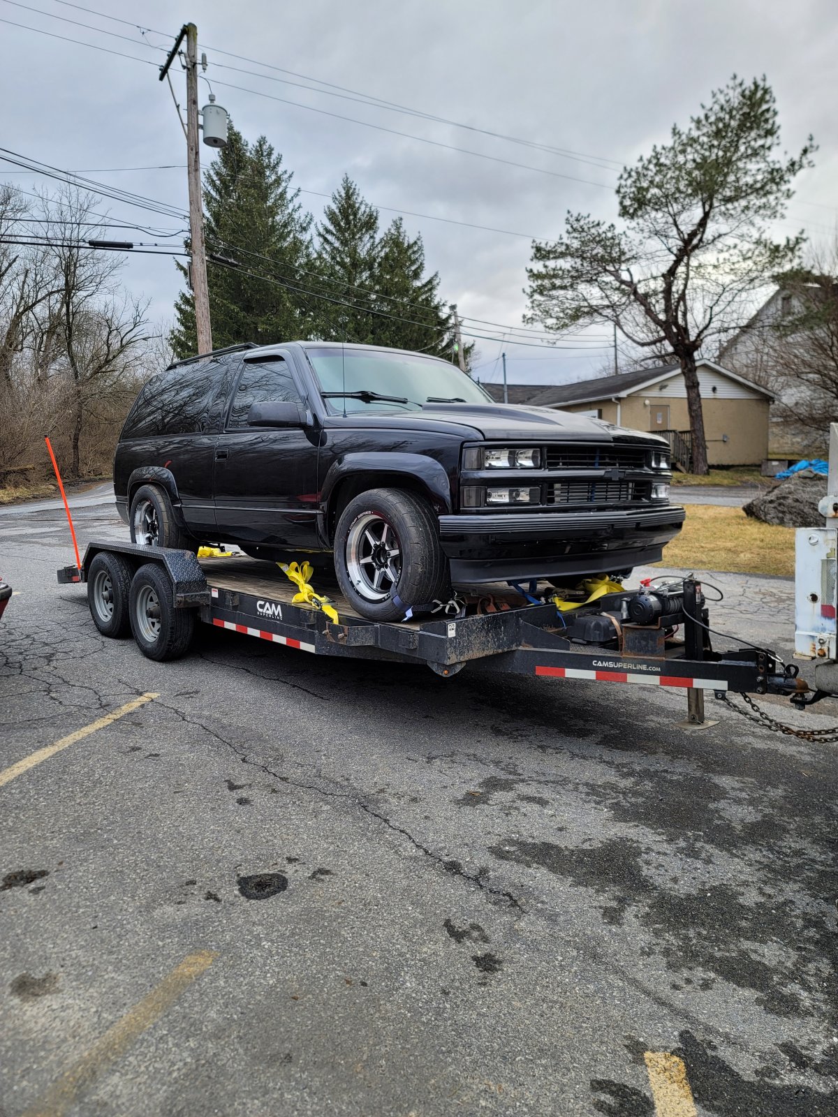

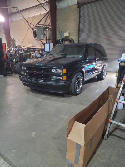

Got the s475/96 looking right at home in the ol girl!
Along with a 4" thick core intercooler tucked in perfectly behind the grill
Any bets on how long that factory ring gap would hold up if I left the 96k mile 5.3?
Going to be installing a holley I/O expansion on the terminator x-max shortly so I can install some accessories.. trans brake, 2step, some sensors, e-fan control, and a few other odds and ends..
Also going in will be SEC1500cc injectors..
Will probably run this thing off a mixture of pump 93 and e85..
Recently installed a holley Terminator x-max, and a holley drop in ck sending unit with 525lph pump,
And universal fuel filter along with a aeromotive FPR, 5/8" feed line, and 1/2" return using gates rubber fuel line..
Finally got the ol girl loaded up on the trailer and brought it home today, so I can do some more work in the leisure of my home garage without having to move it out of my shop everytime we get a delivery..
