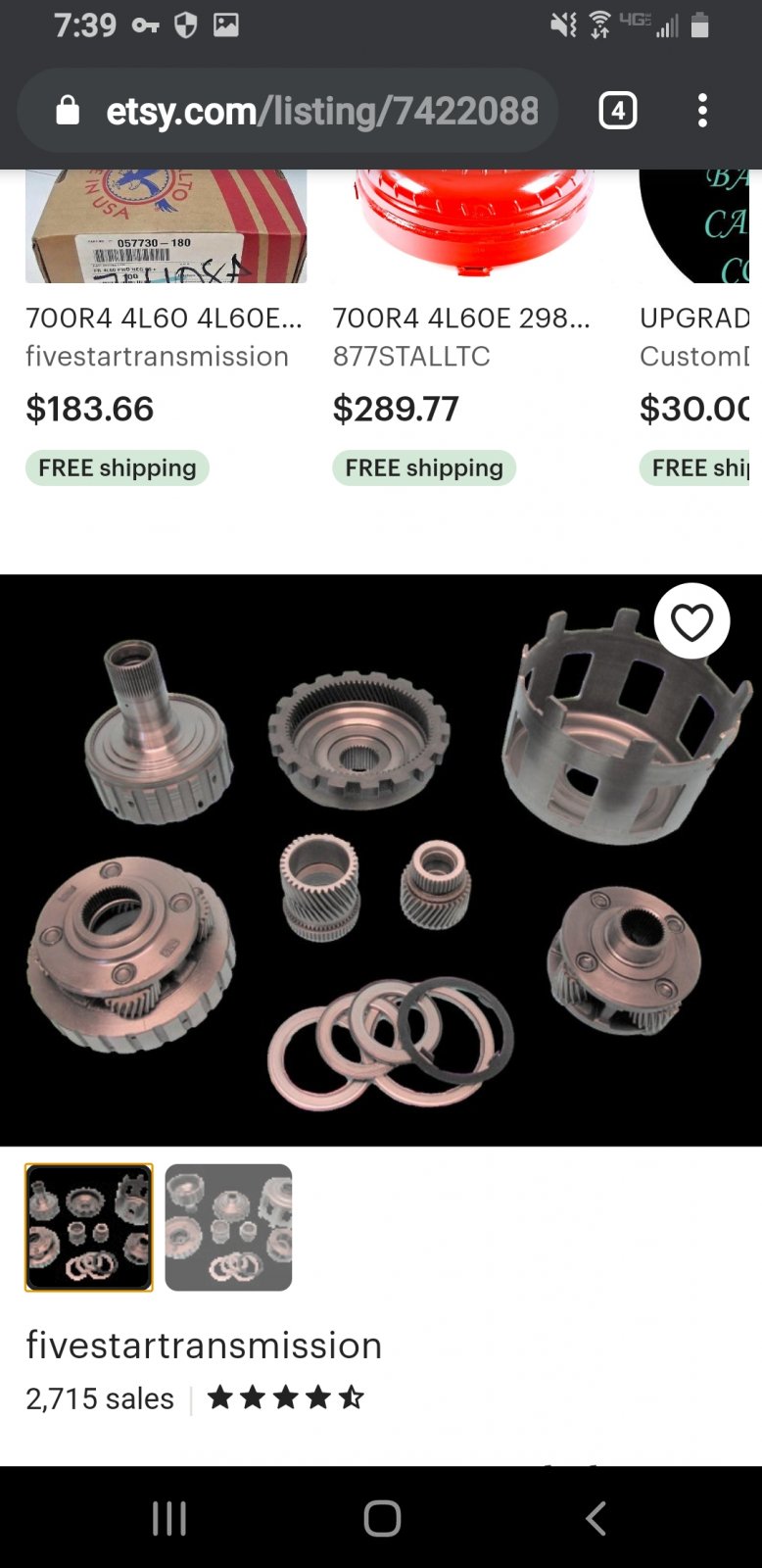

There is a bunch of things you'll need to do. Mainly the planetary gears, the sun shell, hardened input shaft, extra clutch packs, and upgraded band. I know I'm missing things, but I did take a picture of most of the parts bundled together.
This is what your current 4L60 has:
You will need a MINIMUM of this:
