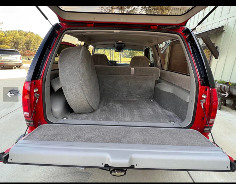

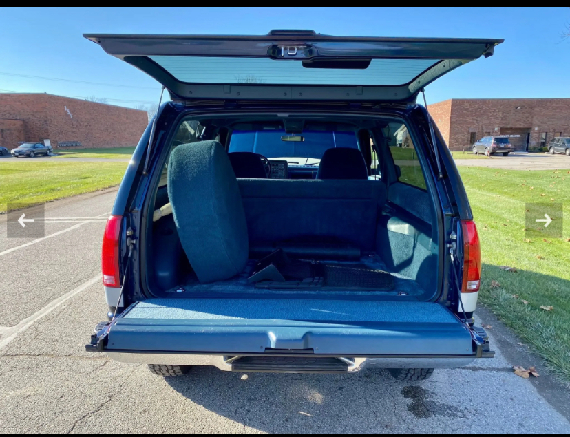

The lift strut mounting locations changed during the 1994 model year, so that’s going to be a difference to look for. A Suburban should fit as well.
It may be a case where you get a glass shop to transfer the donor glass to your liftglass frame. No idea if the glass itself changed between the 1992-93 and the 1994-99, but I’d suspect that it’s the same.
