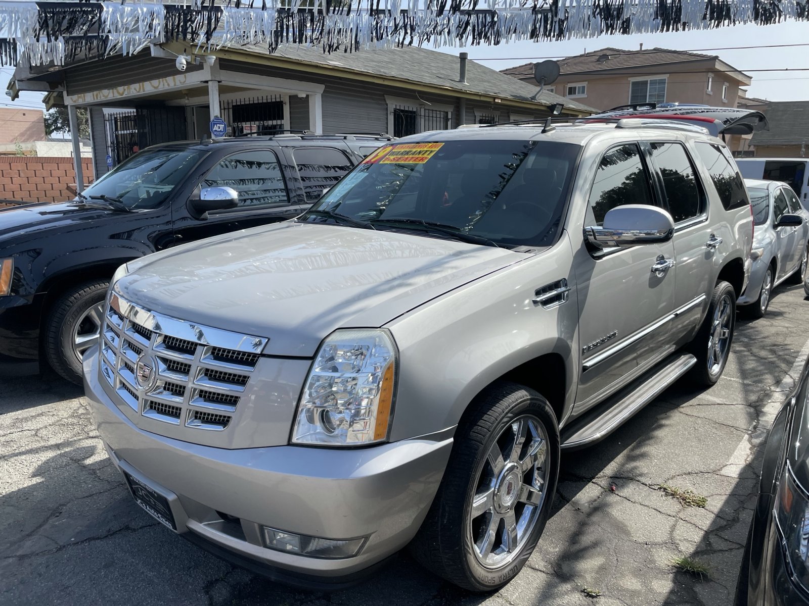

Hey guys, I'm going to get another look and test drive of the 09 Escalade that I mentioned before (the tan one, they claim that the CEL was fixed, but I'm waiting for the paperwork from the mechanic). I drove it once for a few minutes around town and it seems to drive appropriately.
What specific items should I be looking to make sure they work? I've got the "check the air suspension on key-on after sitting overnight, but what else (specific to a 2009 6.2 AWD Escalade that I might not be aware of) should I be looking for? Yes, the dash is cracked. :) It has 148k miles on the odo.

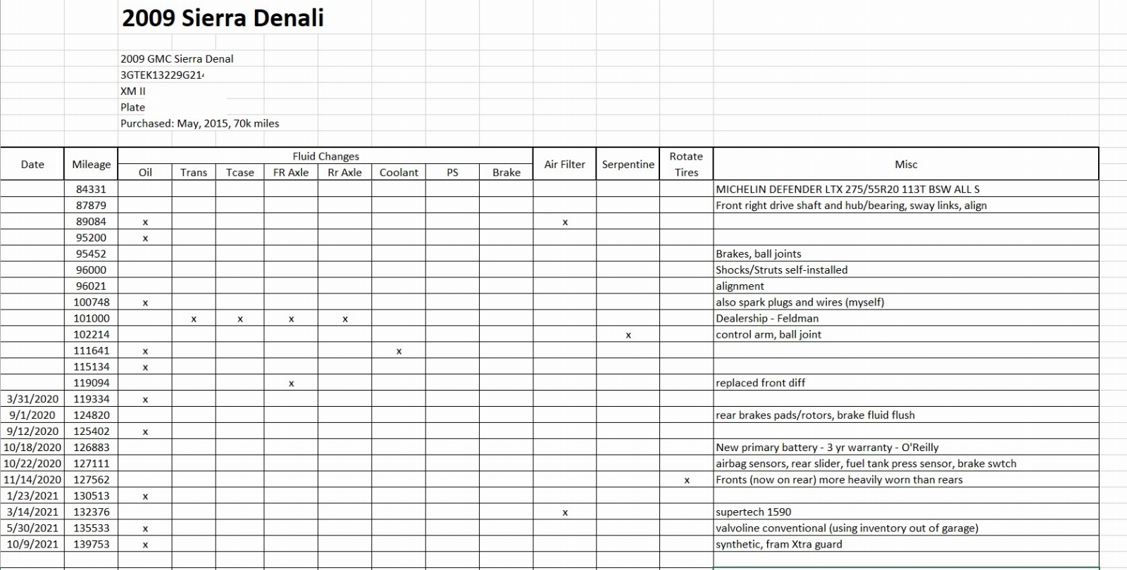

I won't buy a used vehicle without either a mechanic checking it out, or at the very least, throwing it up on a rack. 5 of the 6 vehicles in my sig were bought used, and they've all been pretty good. When I bought the Denali, it only had 70k on the clock. But we put it up on a rack, and I could see the pinion seal of the front diff was leaking. I had them fix it before buying.
I guess if that wasn't an option, I'd drive slowly around a parking lot with someone walking along side listening for pops, grinds, etc. I'd do some figure-8s, with them walking along on either side of the truck. Then take it onto the highway with the windows up and radio off, listening for excess noises. I'd do some hard stops and starts, trying to induce clunks and thuds - indicating worn u-joints or bearings.
Frankly, the Denali's been a bit of a money pit. It's sitting at 140k right now on the odometer. I've replaced the brakes several times, ball joints, axle half-shafts, hubs/bearings, front diff, control arms, etc.
Goods: It's a hoot to drive. 400hp and AWD make for an amusing ride. Lots of creature comforts - heated wheel/seats, etc.
Bads: Like all half-ton GM trucks, they tend to get repairy after 100k or so miles. Doubly so on the Denalis - you've got a lot more moving parts in the drivetrain.
Not trying to scare you off from it, just want to make you aware of what possibly/likely lies ahead. Here's a screenshot of my maintenance spreadsheet, for some other ideas what to look for:
