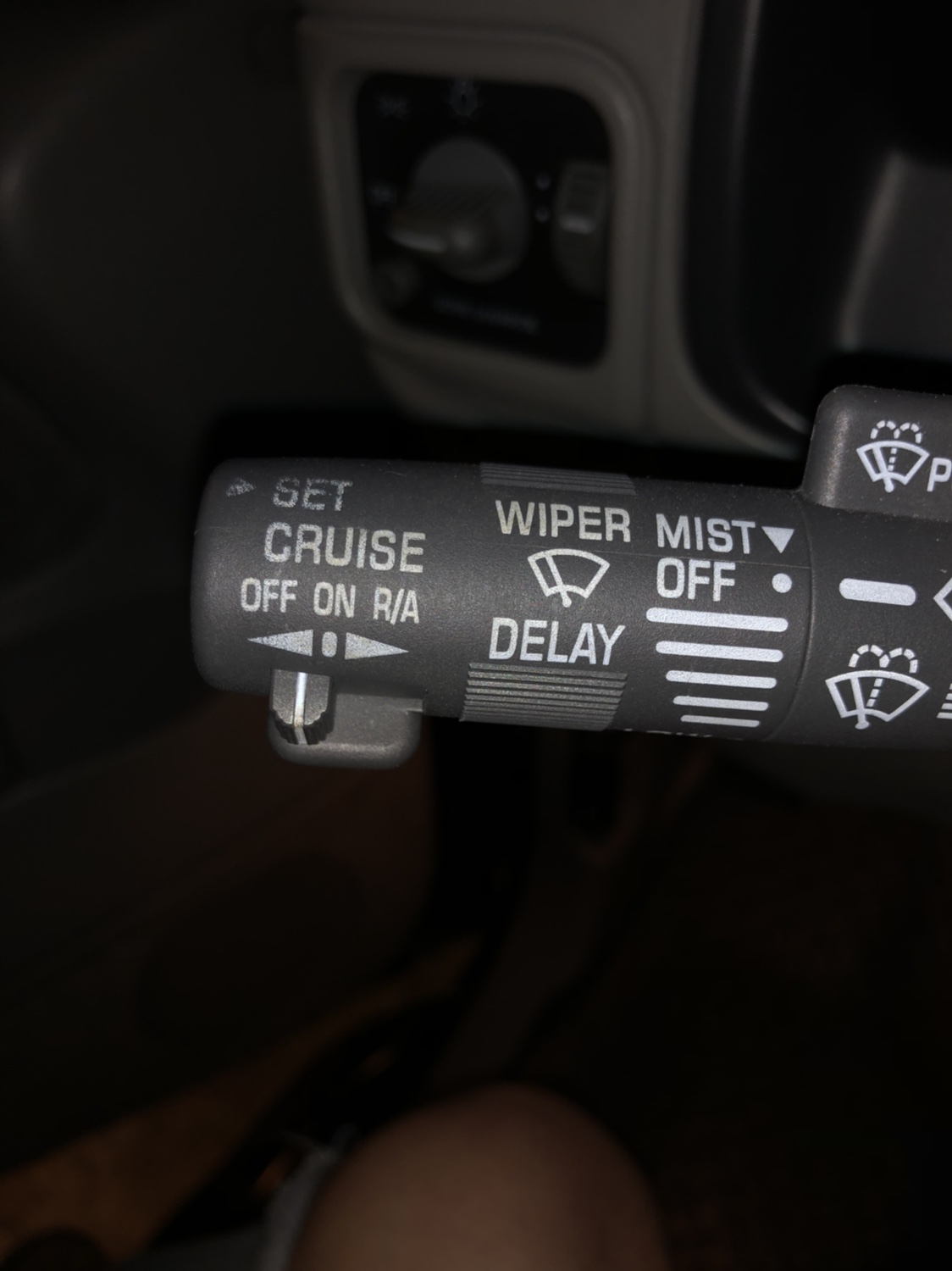

What is the little switch on the left side?

The switch that goes left / right

If I remember right, there's a button in the end of the stalk that will turn the cruise on /off. When it's on, you will get a little "speedometer" looking light on the dash (green, I think). That little switch is the accel/resume and coast button.

Here you go since your letters have rubbed off. Switch it to “on” and mash the button on the end to set cruise.
Oh yeah .... I knew I was foggy. The button on the end is the set/coast. The arrow is confusing.

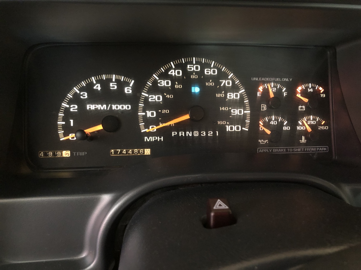

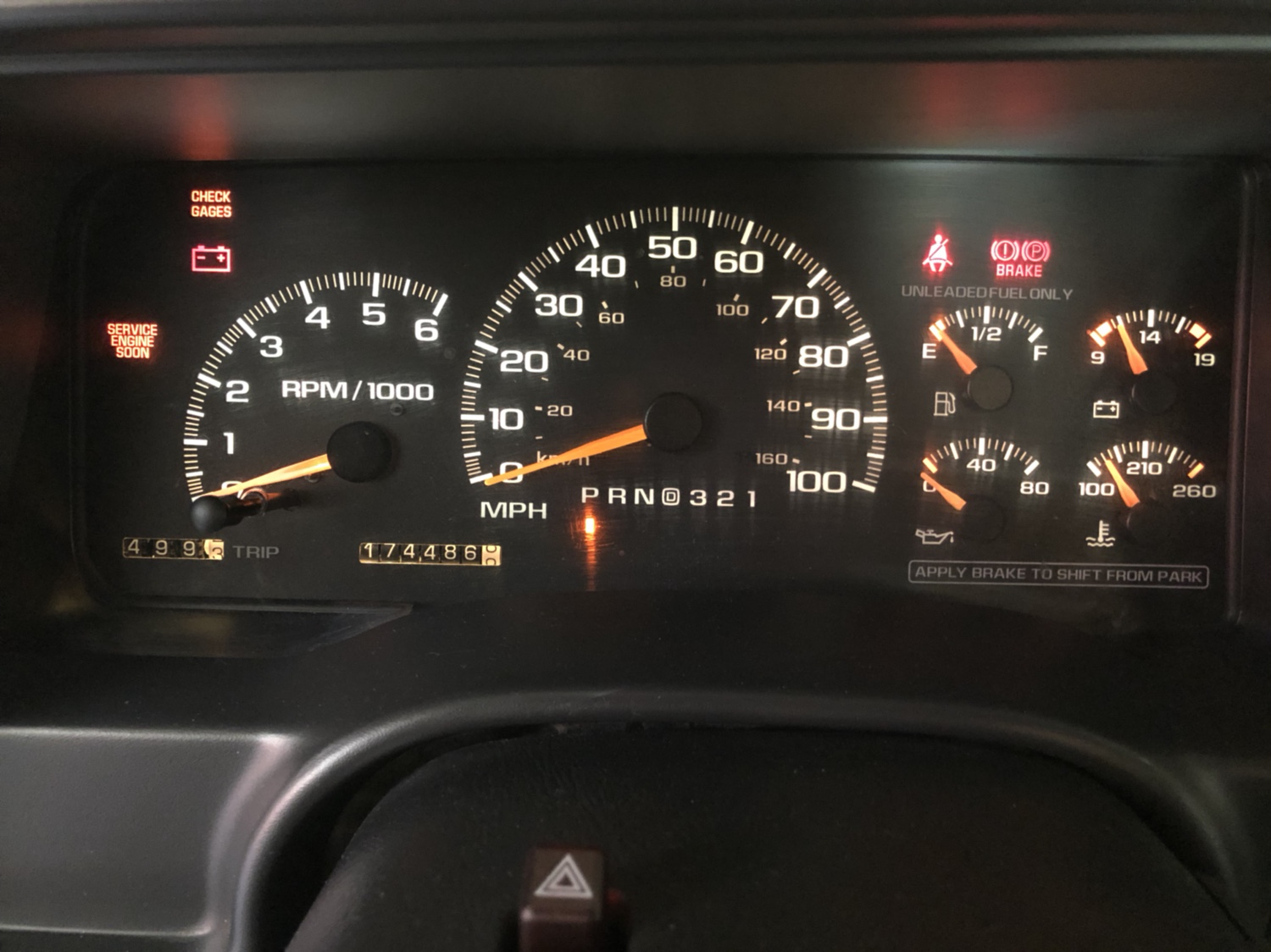

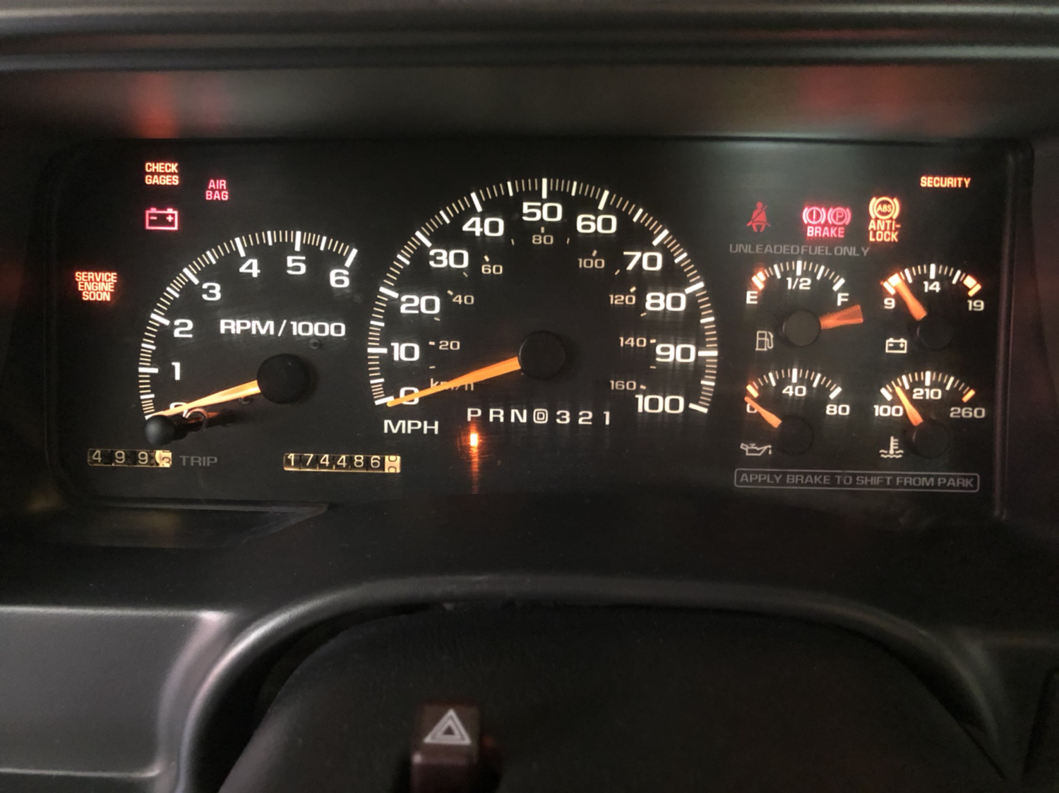

It doesnt come on. Neither does the check engine, i must have quite a few lights out. Anyone want to take a pic right when they turn theirs on so i can see all the lights im missing?

If you pull stalk towards you gently and either hold it there or let go the highbeams will come on to ‘flash someone’ then go off. pull it so it ‘clicks’ and highbeams will stay on. Blue light on dash may not come on unless you click it all the way
Turn key foward without starting and all dash lights/indicators will come on. When you start cel should come on as a check. It’s possible someone pulled the bulbs on yours because it was constantly on. Not uncommon.
