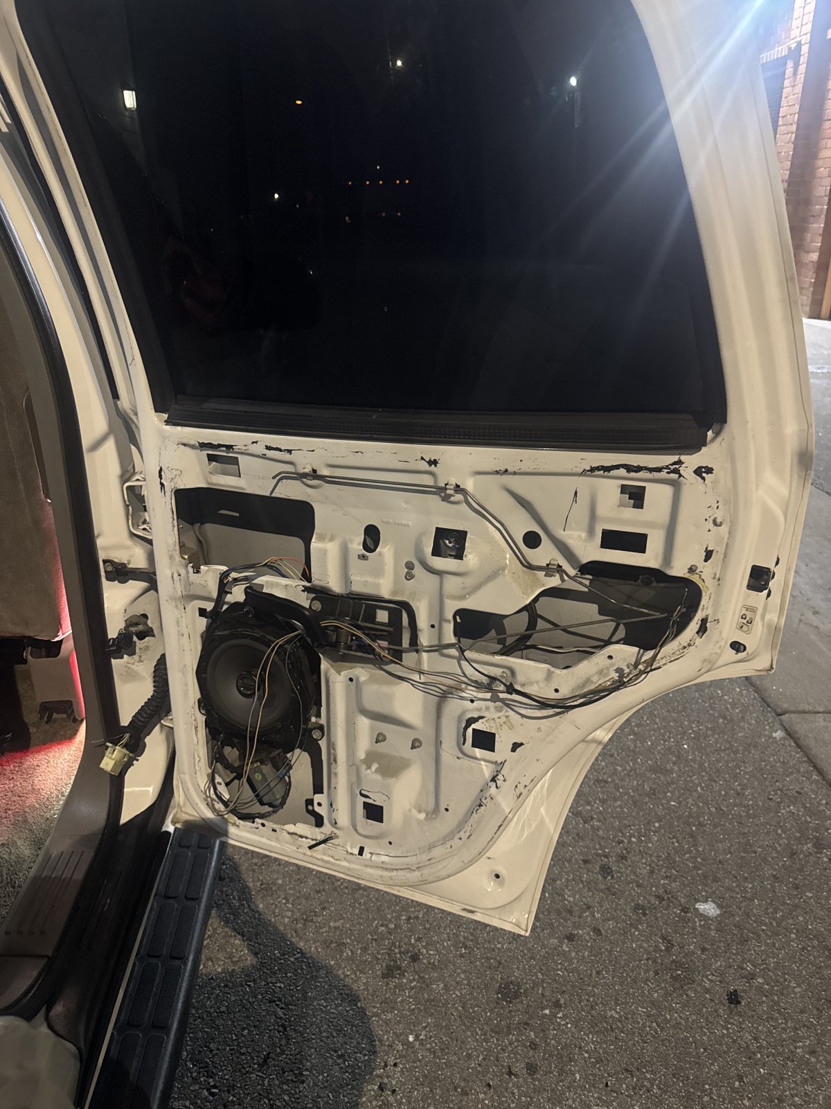

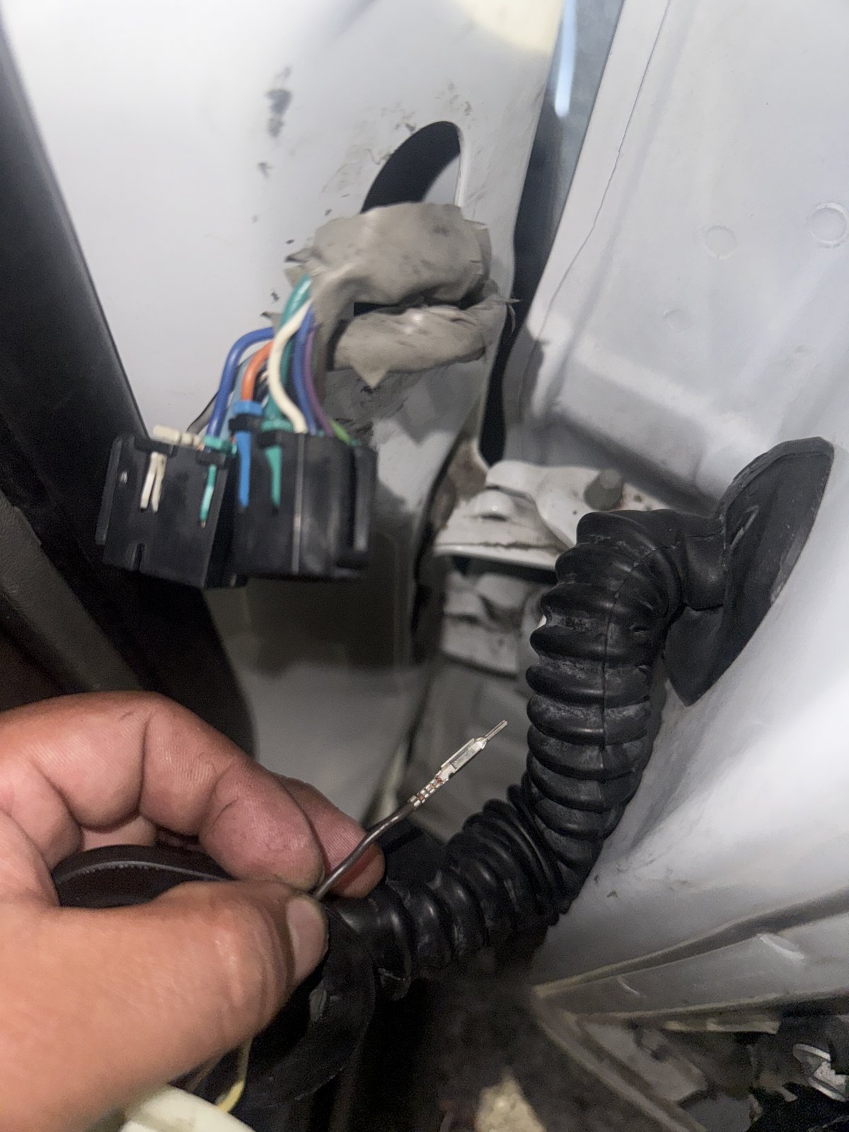

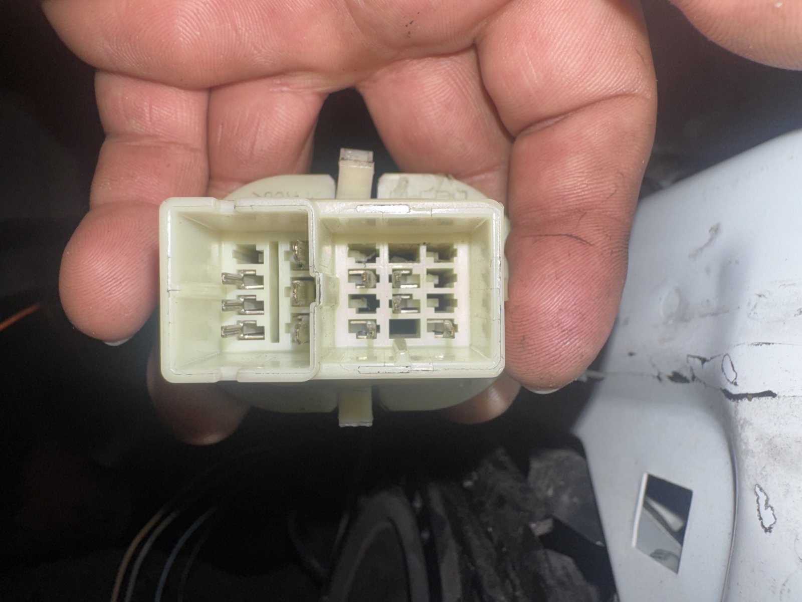

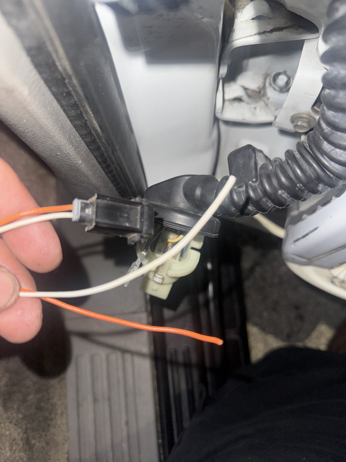

I need to know what type of terminal pin I need to connect to orange wire and white wire. These wires are for the door panel side lights. Just need the size terminal pins that go into the harness connector. I already bought a set or terminal pin connectors on Amazon with a variety of sizes and none fit. Need the actual part number for orange and white wires. The correct terminal pin for both wires.

You might be able to see the wiring diagrams, connector views, and connector part numbers on the charm.li website: https://charm.li/
After you get the connector number, if the pins aren't spec'd, go to the AC Delco site or the Aptiv site to look up the connector and pins. Web sites selling the connector shell may also off the pins.
We don't know what year you're working on so I didn't dig further.
