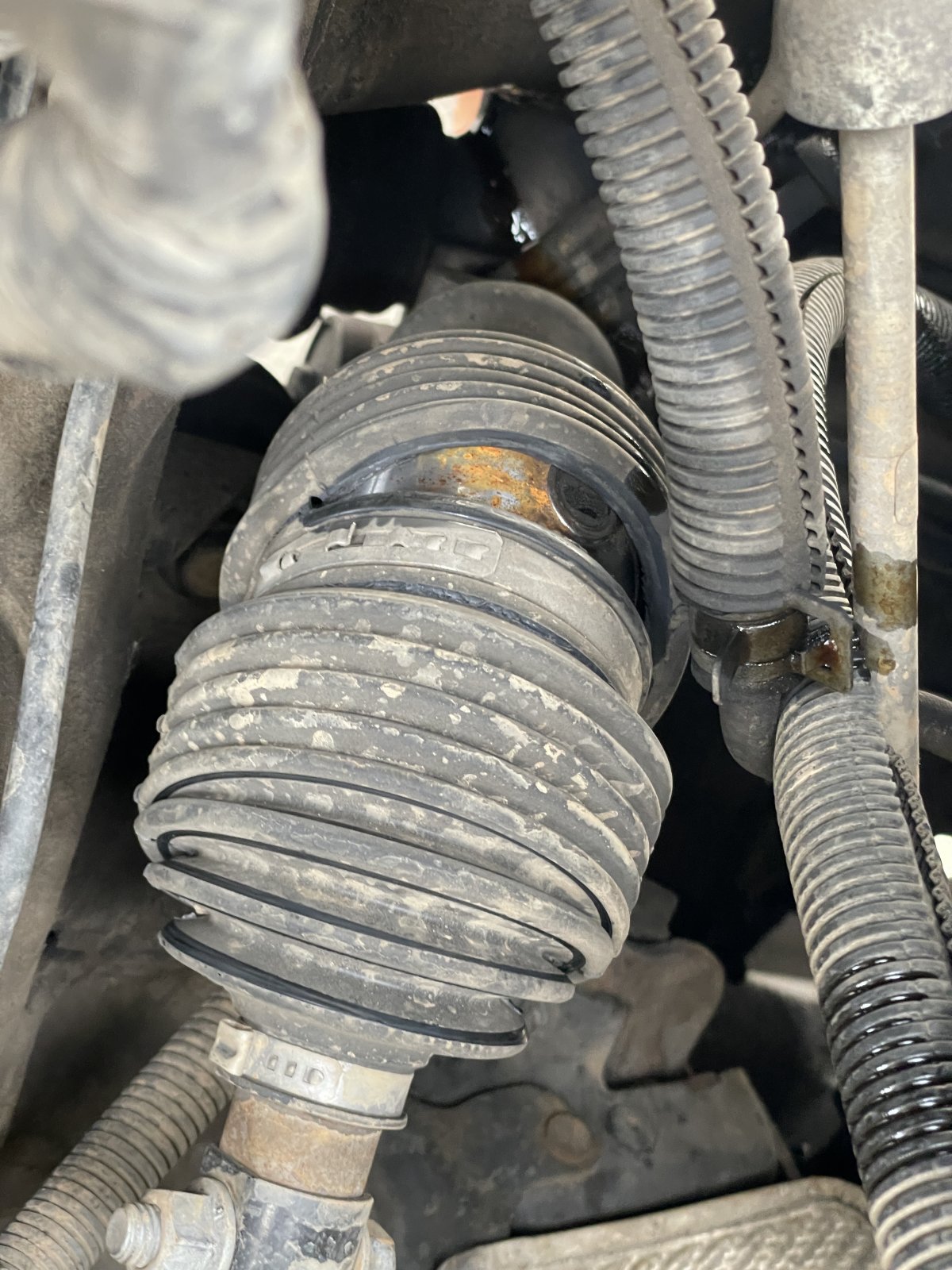

What is the name of this joint and where can I get one?
Dustin Jackson
Aug 9, 2018
1,788
2,066
It looks like the joint where the steering shaft connects to the rack has a torn boot and I can see the joint itself is starting to rust.
Where can I get a replacement?
Dustin Jackson
Dustin Jackson
Aug 9, 2018
1,788
2,066
@Joseph Garcia Im looking to replace the entire joint also, cost almost as an entire steering rack. It looks like there are some cheaper versions for around $90 elsewhere but might as well get the good one
Make sure that you post replacement pics with dates because if you get a $90 shaft assembly, you will for sure do the R&R more than once.

I ended up buying replacement boots and the entire Dorman joint.
If my joint is still good I will grease and reboot it.
If my joint is not good I will swap in the new Dorman.
