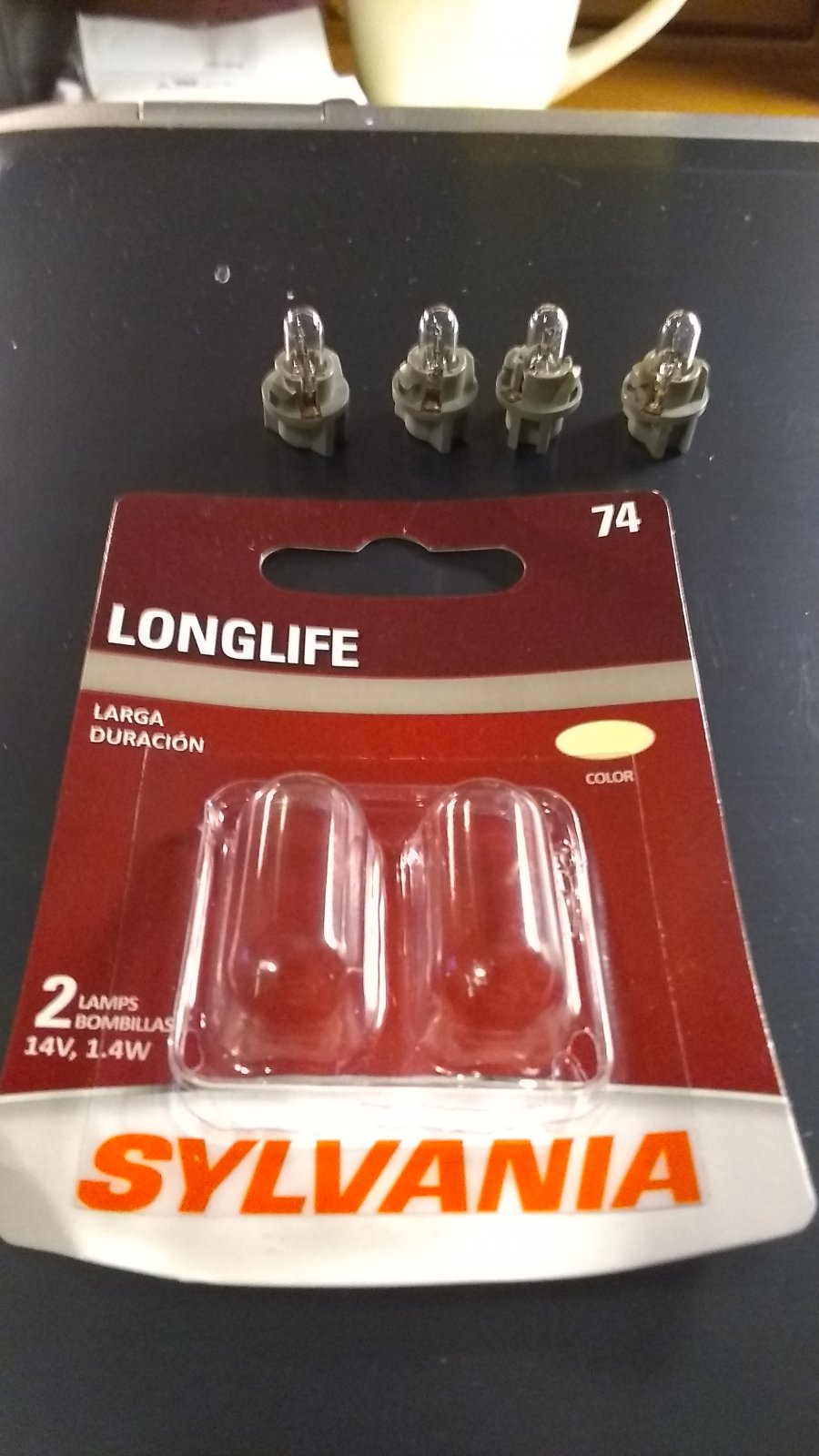

The small bulb's in the Heater A/C control panel..........after all these years it's out. If you would share the number as well as where you got them. Amazon is so confusing the local parts said 194 peanut..........WRONG........these are very small bulbs
NOT THE SOLDER........they twist in the printed circuit same as dash bulb's.

The twist socket that holds the bulb -- does the bulb pull out like a 194 does, or is it "one" with the socket? Meaning the bulb and the twist socket are one unit?
Photo?

If they are smaller than the 194s and have the same style wedge base (removable from the holder without tools) then I'd guess they're a #74. These have a wedge base and are skinnier than a 194. 1.4 watts vs 3.7 for the 194. Wonder if you could find a #74 at an auto parts store to compare to yours?
EDIT: here's a possibility: https://www.ebay.com/itm/2633793310...MIkI7OyYmA9AIVoW1vBB30QQyiEAQYAiABEgInqvD_BwE

You are so correct my friend, after forgetting Amazon which wants an ORDER before even discussing, forget about it. O'Reilly wanted to solve for me above all others
These little bulbs also fit the turn signal/bright lamp/battery/check engine/odometer and who knows what else. The climate control on my Tahoe has four(4) bulbs.
