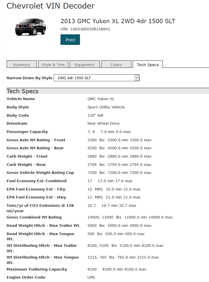

His trailer tow capacity is NOT 8100.
If you look closely, all that is doing is giving a range, from 5100 to 8100.
OP has the 3.08 "soccer mom" ratio, which absolutely kills the towing rating.

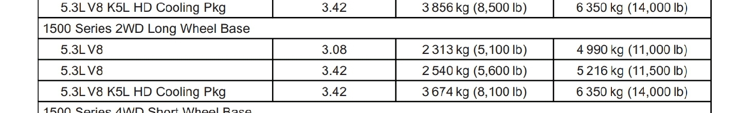

Oohhh, here's an idea... What does the owner's manual say?
5100.
Not 8100. Page 9-66 if anyone else wants to look it up.
Sorry for the sarcasm. Too much bad info in this thread.
