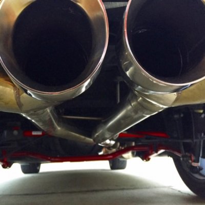

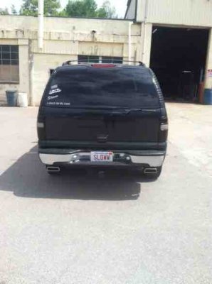

Redid the duals on the Tahoe at work today. 3" mid pipe with Flowmaster 2 chamber, 2 1/2 tailpipes and as tips.
