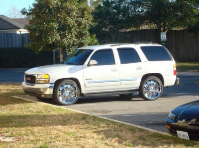

So the truck already had the lowering kit on it when I bought it but I don't know which one and I'd like to go lower. So I'm hoping somebody on here has measurements on theirs to compare. It's an 03 2wd and sits about 31 7/8" in the front and a hair under 33" in the rear. It's not the best pic but hopefully it will help...

I'm pretty sure the front has djm lca's so I just went to their site and the lowest they have is a 3/3. Any chance that's what I have? All the 3/5's I see on here look lower in the back to me.

What size tire? Looks like a 3/5 to me maybe pull the coil isolators for another 1/2" and check your bumpstops and shocks, might be holding it up a bit as well. How does it ride?
a 3/5 on stock bilsteins .. is what my moneys on.. djm lcas.. and djm 5s.. the bilsteins are holding it up

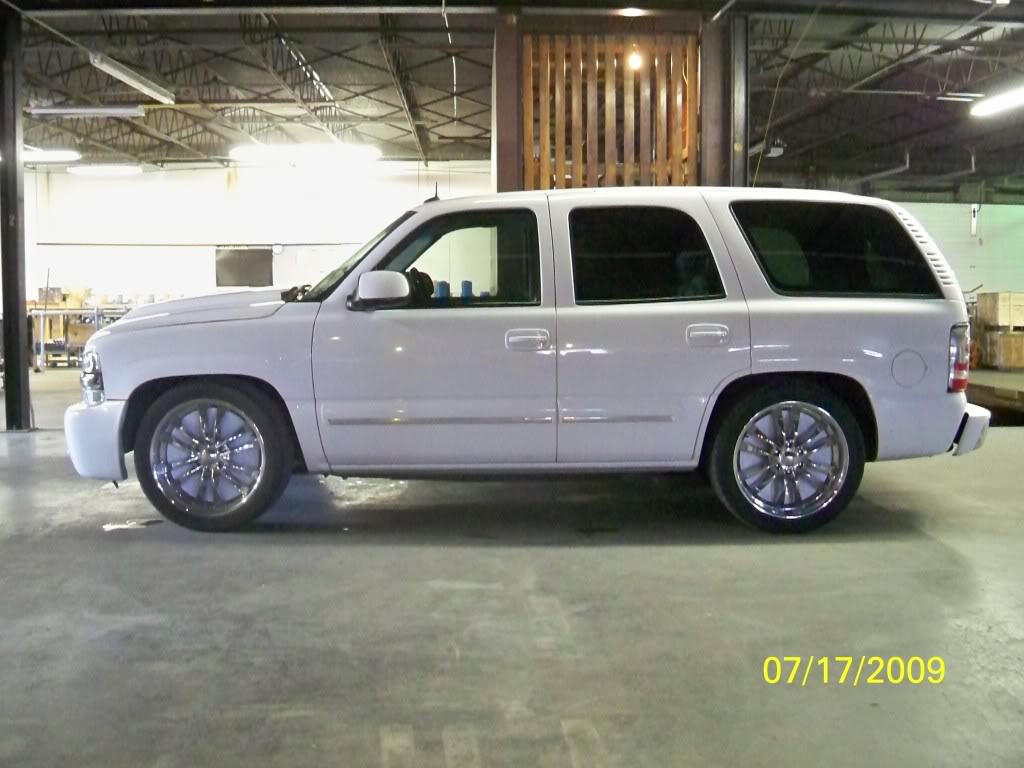

mine with a djm 3/5 and stock shocks

I've got 305/40/22s and have done the free travel mod. I put some KYB drop shocks on the rear in June that I got for super cheap. They helped the ride but I didn't measure the height before I put them on.
Another 2" all around would keep me satisfied until I can get it on air....some day....
