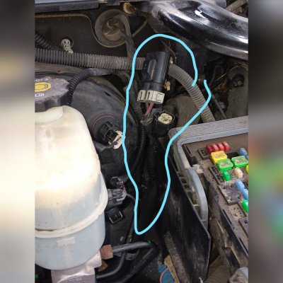

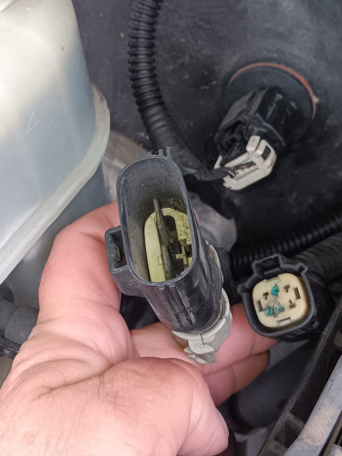

Found these two connectors dangling loosely back by the firewall next to the brake fluid reservoir on a 2007 GMC Yukon Denali 6.2 L. Does anyone know what they are and do they connect to anything? I couldn't find anything they would connect to. TIA

The big connector is for your long decommissioned heated washer fluid unit. They were recalled early on and the customers given a refund. Between your cigar lighters you will have 4 or 5 buttons, one of them being for this feature. I cannot remember if someone is making them again should you wish to make it work.

It was an amazing feature that was venerable to the fluid leaking through and into the electrics of the device under the hood.
You could push the heated washer button, a message and tone would pop up on the center DIS screen “washer ready” and then by hitting the washer button it would wash the screen for 10-15 second with heated fluid.

Interesting, the hyundai unit looks virtually identical, (made in Korea instead of China..) even has the same looking secondary plug, same shape, but there are no terminals inside. Instructions say start engine and wait 30 seconds and there will be hot fluid so theirs is meant to always heat. I plan to wire the power to a 60-70 amp relay though..
After the GM recall, a company called AlphaTherm purchased the rights, fixed the issue and was selling aftermarket retrofit kits. They were on the same street as my office, so I was able to just drop in and easily purchase one.
They've since gone out of business, probably around 2015-2016. But the occasional unit does pop up on eBay from time to time.
